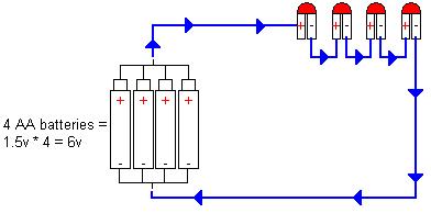

Ok, can I just make sure I'm on the right track here? I've done more research, etc, and I'm starting to doubt that this can be done without having a massive power supply (like a computer PSU).
Let me just start basic (see attached). Let's just say I have 4-AA batteries connected as power (and they're 1.5v each). Then, if I use these LEDs (see link below) which say they're 2.0v, would this diagram work ok?

No, because the batteries are in parallel, giving only 1.5V - it's also ABSOLUTELY ESSENTIAL that you have current limiting in series with the LED's, like a resistor.
Ok, so if the LEDs were only 1.5v, then this diagram should work since my power source is putting out 1.5v, right?
And can you expand a bit on the resistors? Would I have to put one before each LED, or just 1 before the set of 4? I'm assuming this is to make sure they only receive a max of 1.5v and no more?

LED's are fed with current, not voltage, the resistor is to limit the current to the value you want. You need a resistor with each series chain of LED's.
