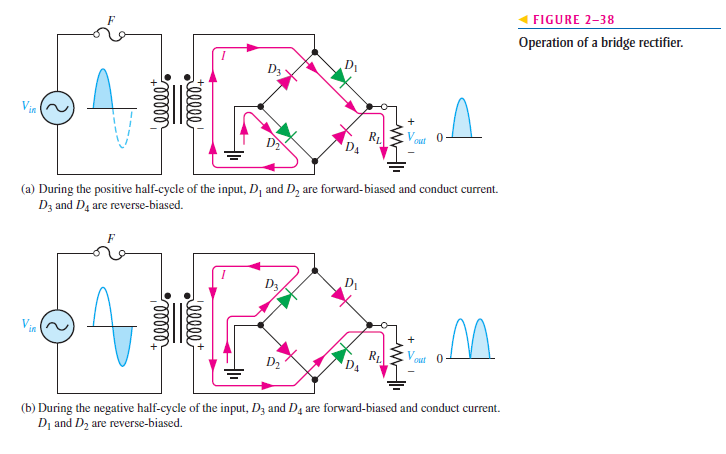

Hello everyone,
I'm reading the book Electronic Devices (9th ed) by Floyd and got a bit stuck with Bridge Full-Wave Rectifier Operation.
In the book, on page 55, the figure below is shown, and the text reads:
"The bridge rectifier uses four diodes connected as shown in Figure 2–38. When the input
cycle is positive as in part (a), diodes D 1 and D 2 are forward-biased and conduct current in
the direction shown."
Does this make sense, I would have drawn the current in the opposite direction.
How should one think about this?
All comments appreciated.
John
Yes.
So would I.
The book is showing "electron flow", the direction in which the electrons are moving, from negative to positive.
What you and I would draw is "conventional current" flow, from positive to negative.
If in doubt, state what you are showing, electron flow or conventional current.

The book is subtitled "Electron Flow Version" and he publishes both versions.
Electronic Devices (Conventional Current Version), 9th Edition

Well you simply bought the wrong book. You should buy this one:
Electronic Devices (Conventional Current Version) (9th ed) by Floyd
https://www.amazon.com/Electronic-D...tronic+Devices+(Conventional+Current+Version)
We just compared books, I got the wrong version :facepalm:..... thanks for pointing this out. Anyhow, this has been a good learning experience, from current flow to the domestic analog US telephone lines. Thanks everyone for your feedback.
