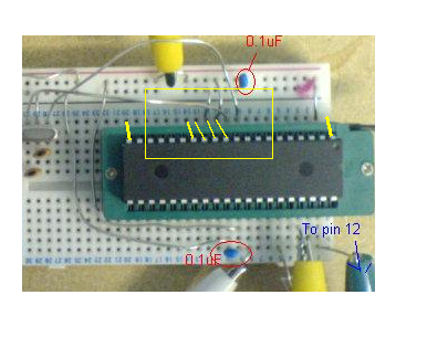

I moved the crystal a lot closer to the PIC and removed the wires connecting it. Although this did not change anything. The PIC still will not work if I don't put some sort of load on any of the pins and hold it high. I still cannot put capacitors in the circuit or it stops working. I checked for any short circuits with my multimeter and it is ok. I changed the LEDs and resistors to lower the current drawn from them. Nothing is helping

Unless I am going cross eyed, looking at your circuit and project board you have the wrong pins for power and the crystal.
It is a 16F877A.?
xtal should be 13 and 14
Power is 12 and 11.?

yeah even the schematic has it wrong and how about a 22k resistor to MCLR?

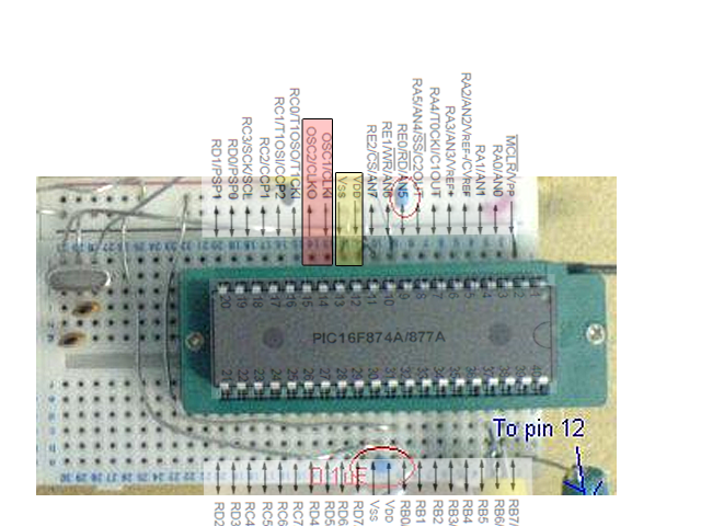

ericgibbs: to help your claim:
Yes! You guys are right! Thanks for spotting that, I feel quite stupid now. Now it works with caps. Although, it is still unstable. For some reason it speeds up and slows down, I think this is to do with the current drawn.
