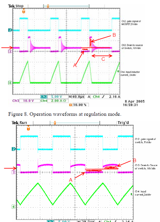

Example: assuming a simple inductor + MOSFET + diode boost supply.
Bottom half of picture. continuous:
Green trace is current in inductor.
Blue trace is gate drive of MOSFET at 50%.
Purple is MOSFET drain voltage at 50%. Red arrow is supply voltage.
The area A must equal B area.
Area A= supply voltage for the time the MOSFET is on.
Area B= the voltage above supply for the time the diode conducts.
In this case the output voltage is 2x the supply voltage with 50%.
Top half of picture. dis-continuous:
Green trace is current in inductor. does not flow all the time.
Purple is MOSFET drain voltage. Red arrow is supply voltage.
Time C= no power is flowing.
In this case the output is 4x the supply voltage at 50% gate drive.
If you start out with a continuous supply, unload the supply, and watch the voltage go up, (error amplifier removed), (stuck at 50%), the supply will move from continuous to dis-continuous. The voltage will clime. The inductor has energy stored on it and it will unload the energy somewhere. The output capacitor will take the energy and charge up. At some point something will break. Another good reason for error amplifiers.

Part 1:
Using Simon's circuit but with a 555 timer in place of the controller. (set at 50%) no voltage feed back, no current feed back.
I think this is what the original question is about. Frequency = 100khz or 10uS On time=5uS off time=5us.
Supply =10V Inductor value so 10volts for 5uS will cause a current slope of 1A.
Assuming perfect parts: Inductor resistance=0, diode drop=0v, no loss in MOSFET.
At start Vin=10V, Vout=10V
T=0 MOSFET turns on. Current ramps from 0 to 1A in 5uS
MOSFET is off. Current flows into output capacitor. There is 0 voltage across the inductor so the current can not ramp down so the current remains at 1A.
T=10uS MOSFET turns on, Current starts out at 1A and ramps to 2A in 5uS.
MOSFET turns off.
Current flows into output cap. Because the out voltage is very sightly above input voltage there is 0.1V across the inductor and the current ramps down from 2A to 1.99A.
Next cycle current ramps form 1.99A up to 2.99 and back down to 2.97
Next cycle current ramps form 1.97A up to 3.97 and back down to 3.94
Next cycle current ramps form 3.94A up to 4.94 and back down to 4.89
The current builds quickly as long as Vout is less than 2x vin.
At Vout=2x vin the current ramp up=ramp down so
50A ramps to 51A and back down to 50A
At Vin=10, Vout=30 the current ramps down 2x faster then it ramps up.
10A ramps to 11A and down to 9A
At some point the supply will go dis-continuous.
Current will ramp from 0 to1A in 5uS when the MOSFET is on.
Current will ramp down from 1A to 0A in a short time (1uS when Vout = 50V) The remaining 4uS will have no current flow.
From here on a set amount of energy will enter the inductor each cycle and pump up the output like MrAl said.
I am pointing out that with out current feed back the current goes very high and the output cap will charge up faster than what MrAl said.
