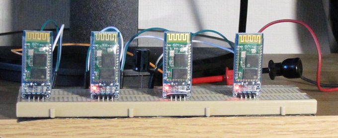

Any Bluetooth gurus out there please ? My project will have 4 x HC-05 Master Bluetooth modules in close proximity ( 100mm) , and will be communicating to 'paired' HC-06 slaves , I am wondering if I can expect some wireless interference .

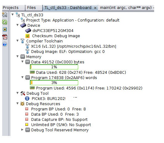

....I'm not saying all is OK yet ! .. but two HC-05s seem to be 'happy' , I have 3000 lines of code and used 3% of flash ... Mmmm

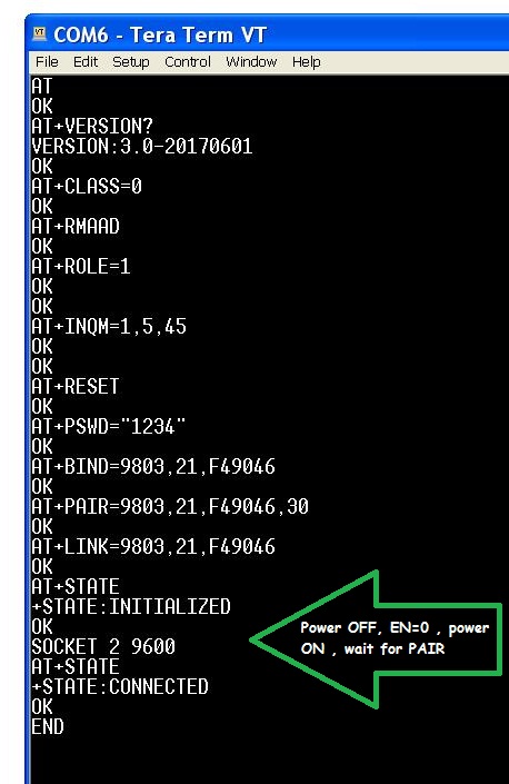

Progress .. The way i believe HC 05 - HC 06 (version 3) 'works' is the first AT mode (EN (pin34) 3.3v on power up ) communicates with the SSP (https://www.fte.com/docs/ssp.pdf) and the basic functions section of the master so some AT commands will return ERROR(0) .. As I required 4 Master / slave pairs, I had to find the Slave's <addr> first and then set it's 'master' what slave to pair with ( PAIR / BIND/ LINK ) I wrongly assumed AT+PAIR meant go find slaves ... after these settings all 'OK' .(SPP is always INITIALIZED ?) Power off Master drop EN pin (0v) and power up Master again. Master assumes SPP mode ( Slave has been powered all this time ) , now wait ! .... for them to PAIR. each modules leds flash rapidly at first until linked then just two flashes and a gap . BAUD For the next AT mode has to be 9600,( message SOCKET 2 9600 ..so I knew ) Now enter master's second AT mode by making EN=3.3v .. send AT+STATUS now shows CONNECTED ! It was late so have not had time to send data over the link yet .. RNAME also says FAIL , but i changed the Slave name I think it only reports OK to HC-06 remote name ? so more testing required .. as i was running this from the PIC , various delays were required between commands 20msec to 1 second ? ...
I Now have 4(06) slaves powered up but one master , to see what 'linked'... low and behold first slave connected , and passed data ( loop on slave RX/TX ) others still flashing rapidly so HC06's waiting for a master ? next stage 4 masters and 4 slaves ... they have to connect to their own master ...
They should all sort themselves out.
How is it the simple mistakes cause the longest head scratching ? , my screen shot above shows slave addr = 9803, 21 , F49046 .. it should have been ! 98D3, 21 , F49046 :banghead: but this master it did link to the correct slave ! even with the wrong address ! but it took 10 sec not 200 msec .. anyway.. pommie you were right , they sort themselves out 4 masters 4 slaves PAIRED and serial loops work fine.. :cool:

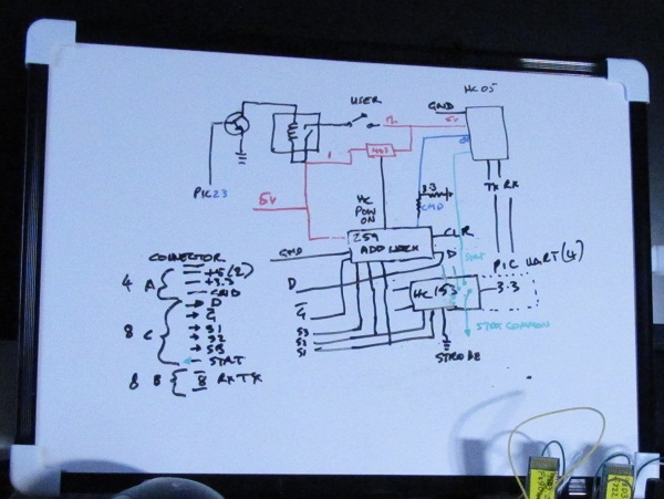

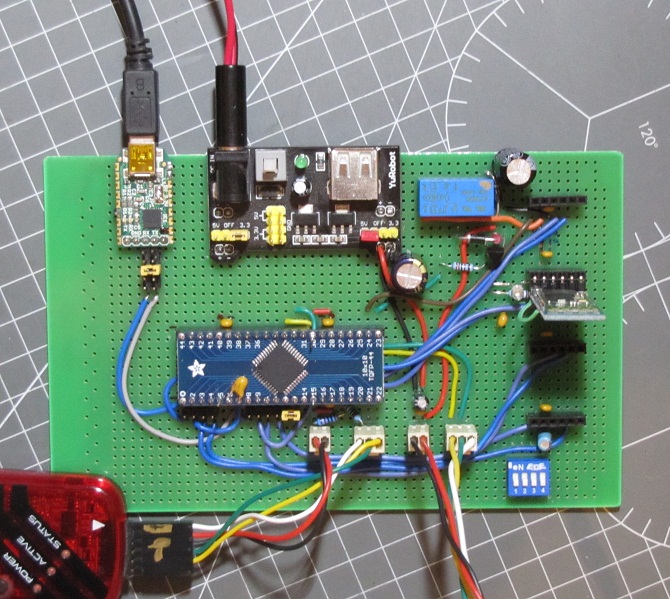

Designing on the 'fly' not always straight forward.. my 4 x bluetooth project , began to run out I/O pins ( PIC has 35 ) so decided to multiplex some signals.. so I split the development on to two boards.. ( may eventually be 3 ) I found this little dry marker board great to sketch out ideas..

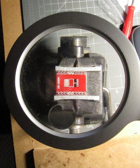

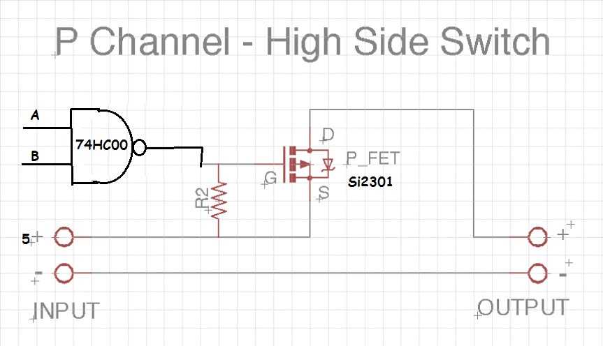

My hobby seems to be disappearing ! I decided to replace the one relay , with 4 x P logic MOSFET. ( Si2301 CDS) so I can power the HC-05's individually .. my choice of device ordered and arrived , ...they are 3mm x 1.2mm ... had to buy 5 , good job I lost one somewhere in my mess ! quickly put the other 4 on a ssop breakout board.. .. happily tested and working...
Do I need the resistor R2 ? Input A will be 0v on power up ( same 5v ) so switch will be off ..
