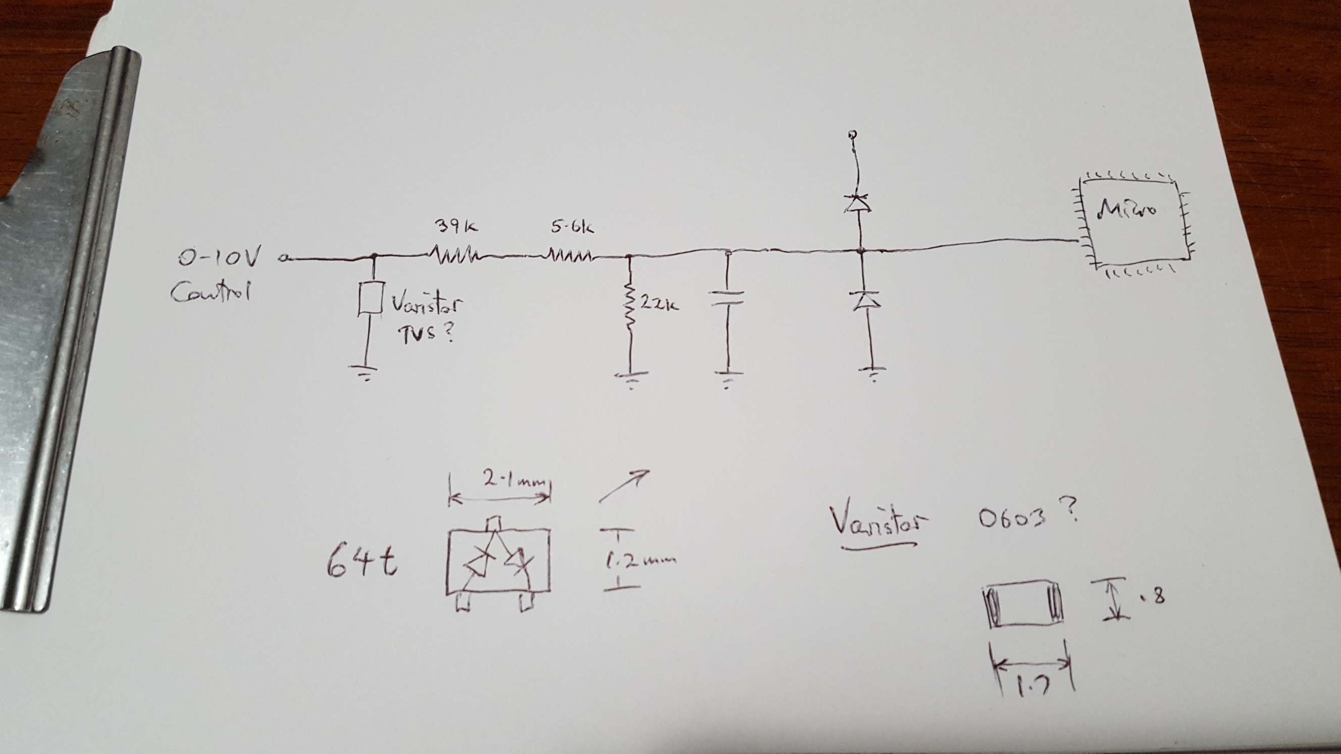

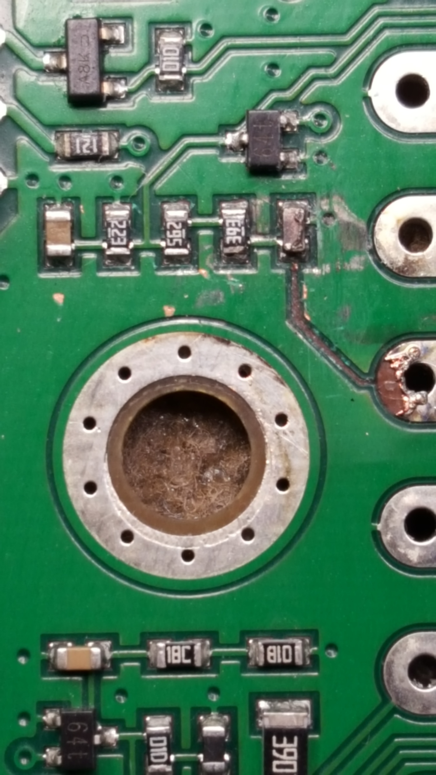

I'm looking for a little help please with a fault on a VSD board.
Apparently the 0-10V control line got whacked with 240V AC and caused some grief.
I appears it took out an smd Varistor/TVS ?? and 39k resistor … see photo and cct … and I am hopeful that is all that's wrong.
They brought in a new unit to compare notes with, so that has been helpful.
My main question is how to determine a replacement for the varistor or tvs diode. It appears to be a 0603 sized component.
Seeing the maximum voltage should be 10V … do I simply choose a 12V varistor … 20% higher than maximum working voltage?
A second question relates to the protection diodes … they are in a dual package … and appear to be set-up as drawn … but I haven't been able to locate any info on them. The marking is "64t"
I'm not as concerned about them as I believe they are ok … but if I have to wait for parts … I may as well put a couple of them on the order.
Thanks for any help.
Your assumption for the varistor is reasonable.
However if the diode package is blown that doesnt sound so good for the micro's input.
Have you tried the drive without the diode, should work so long as you dont exceed 10v, or go below 0v.
Thanks dr pepper. I was a bit nervous about the diode package initially and particularly about the micro ... but I'm pretty confident the diodes are ok ... they measure exactly the same as the one on the known good board.
I don't have three phase in my workshop, so I don't know any way of testing it without sending it back to the electrician who brought it in.
Maybe I could run the control portion of the board up with 10V ... and watch the output as I feed the control line as you suggest ... though more chance of me blowing something else up! :(
