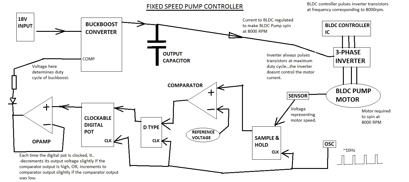

its a fixed speed water pump.
As in the following attachment
Coil "on time" is the full commutation period, ie 2.5ms, not 1.05ms as the diagram below says
  • DC Pump drive showing current and speed regulation of motor.pdf

OK, but this is a Fixed speed pump.
Why wouldn't the following work for controlling this fixed speed pump?
Maybe because it is unnecesarily overcomplicated. The most important part is how the 8000RPM is achieved. First you need to ramp the motor up - you cannot just out of sudden go from 0 to 8000 RPM, especially when the pump is already loaded. Second thing, if you unload the pump, the RPM will try to shoot because the torque will act on the unloaded momentum of the impeller until someting reacts. This means the motor will most likely get out of sync when there is sudden load change.
You seem to be obsessed with the fact that this is a fixed speed pump. FYI, in industry, most pumps are fixed speed. It's not the big deal that you're making it out to be. What is a big deal is that you're attempting to run a motor off of a constant current source, which several of us have tried to explain to you (with much banging of heads against brick walls), is totally asinine.

So, it transpires from post #114 that the supply is not a constant-current source. Rather, it is a duty-cycle controlled current source regulated according to sensed motor speed. That makes more sense.
Edit:
Why more complexity? Why not feed the speed sensor signal directly to the opamp?
Yes. Any reason why not? And shouldn't the opamp have a speed-set signal (no, not the one from the ML4425 :)) as a second input?
