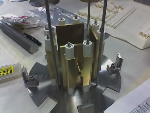

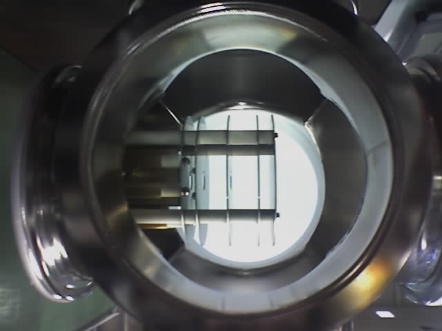

Unfortunately I don't have specifications on the lenses, as they are home built. Check out the pictures I have attached. The first one is the assembly as it is being made, the second is the assembly "in situ" in the vacuum chamber. You are looking for the brass plates (four of them).
Theoretically, the current flow should be zero, as they are insulated from ground by the ceramic insulators that you can see. The design has one threaded rod (Stainless steel) around which a continuous ceramic tube runs. They there are larger diameter ceramic spacers that hold the plates out in space.
Cheers!
P.S. For your information, the other plates you can see are the Time Of Flight plates. They are an integral part of the mass spectrometer. Imagine a burst of ions entering the assembly between the second and third plates (moving directly into the photo). If you pulse a large negative voltage to the second plate in from the right, say -2 kV, and at the same time pulse a slightly less negative voltage to the third plate in, say -1.5kV, this leads to a potential difference of 500V, which serves to eject ions to the left, into the rest of the mass spectrometer! All of this assembly has been home built by our workshop gurus! I already have the fast high voltage switches (from a German company, Behlke) they are MOSFET style.

If each of the brass plates is one terminal of a lens, where are the other terminal(s)?
G'day Roff,
What you do is connect the Vout of one terminal to the lens, while the other is grounded to the machine body. Effectively then, the circuit is not complete as the Vout is isolated from ground (hence the very low current flow).
I will use BNC connections to a vacuum flange. the sheath of the BNC cabling will be terminated to ground (i.e. the flange body)
Does this make sense?

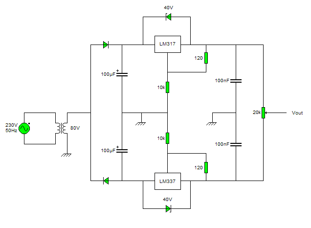

Try this out.
Good luck with finding an 80V transformer and a 20k pot rated to 2W though.
Note that it isn't protected against short circuits, at least not for very long periods of time anyway, you can add a 10k series resistor in series with each regulator but it would have to be rated for at least 4W.

Hero999 said:
Try this out.
Why not use 100k pots?
The origional requirement was for 500:mu:A so I used 20k because it would give better regulation.
I don't know what the maximum value he can use without any trouble, it depends on the leakage current of the capacitance. He could try 100k or even 1M and probably won't have any problems, experimenting is the best way to tell.
