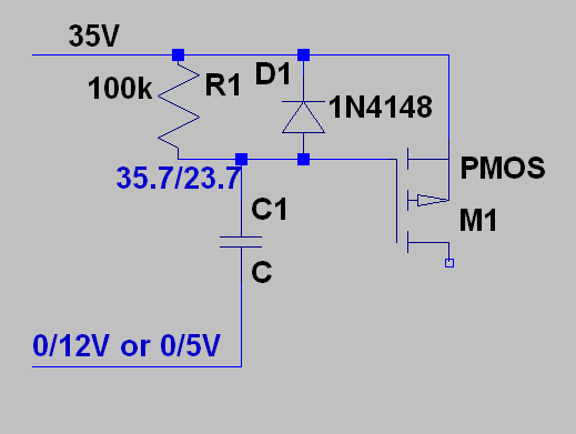

Here is a high side P-MOSFET driver method I have used many times.
The drive signal is 0 and 12 volts (with "Logic Level" MOSFETs you can use 0 to 5v)
When the signal jumps to 12V, D1 keeps the gate at 0.7 volts above the supply. (off)
When the signal jumps to 0V, the date will be 11.3 volts below supply. (on)
If no signal happens for a long time the Gate-Source voltage will go to zero.
I usually have the RC time constant at 10 to 100x the switching time. T=R1 X C1.
I have used this many time with a supply of 100 to 400 volts.

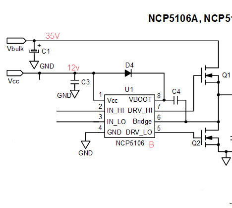

https://www.onsemi.com/pub_link/Collateral/NCP5106-D.PDF
This little 8 pin IC will take TTL level signals and drive two N-MOSFETs in a half bridge. It is built for 400 volt supplies but will work at your 35 volts fine. Note it used N fets.
NCP5106B. I think you need the "B".

The circuits in posts #6 & 7 can not be run for a long time at 0% or 100%. They require a signal all the time. 10% through 90%. If set to 100% or 0% the top driver will fail in the foo direction.
Hi Ron,
You can get boost gate drivers that work from 'DC'. They have self-oscillating capacitor-boost supplies. But these days, with decent PMOSFETs being available, mostly, you do not need to boost the MOSFET drive voltage. Also, I always feel that, in general, it is preferable to keep the drain/gate away from the fire and brimstone of the load if possible.

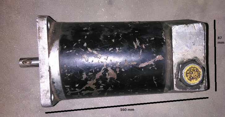

My bipolar stepper motor has 3 ohm winding resistance. Unfortunately, it has not any label on motor body. My stepper motor is same as attached with an attached motor image. It includes motor measurement and its weight is 4kg.
It is the original image of my bipolar stepper motor. The fifth (middle) pin is for ground.
That represents quite a load at 30V (30V/3 Ohms = 10A). As I said not a trivial design, but doable.:)
I think your wrong about the "fifth pin" being ground. A 5 pin/wire stepper usually has the fifth pin as the supply not ground. The other four pins are grounded in a sequence to make the step movements.
I have checked the connections by opening motor's back cover, the fifth pin/wire is connected to motor body and other four are coil connections.
