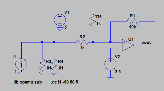

ofsetamp-png.89239
1) The "V2 2.5" can also be a 1k to +5 and a 1k to ground. If you 2.5V is not exactly right OR your R6 & R2 is not right there will be a offset error. Use 1% resistors. You say that 0 current is 2.352 volts. This is probably because (1/2 of 5V) does not equal 2.5V OR R2 does not equal R6. When things are balanced right there should be 2.5V on both inputs and on the output.
2) You might need a R-R output opamp. The inputs are at 2.5V so you don't a R-R input opamp. These amplifiers will pull to ground and supply better than the old types.

I am lost as to what circuit you are using now.
ofsetamp-png.89239
dear sir , here not issue of R6 & R2 . i'm telling here is V(out) = 2.352 v .
i has found both place 2.5 v(- & +) of opamp . where we used 1k resistors (1%)
Just for the fun of it. Make R6 990 ohms and R2-1010 ohms. (-1% and +1%) See what happens.
The "input offset" of the LM358 is "7mV worst case room temperature". This can be seen by changing the 2.5V to 2.507V or to 2.493V. See what happens.
Spice will hand you perfect components. Like 1000.0000 ohms. The LM358 also has imperfections like input offset.

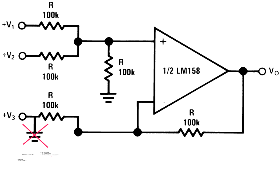

i use also like this ,
Where: VO = V1 + V2 − V3
but when v1 = 0, v2=0 & v3=0 .
then vo - 3.5 volt.
i confused with op amp.
1) I crossed out the ground symbol that should not be there.
2) If V1=V2=V3=0 volts then Vo= 0 volts. Not 3.5
This could be used on the current sense amplifier talked about above.
Connect V1 to a reference voltage (2.5V).
Connect V2 to ground.
Connect V3 to the current sense resistors. (normal voltage is o volts)
The output will be 2.5V at 0 current. When the current is positive the Vo will drop below 2.5 volts. When the current if negative the voltage will be above 2.5 volts. (there is a inversion there but that is usually OK)
