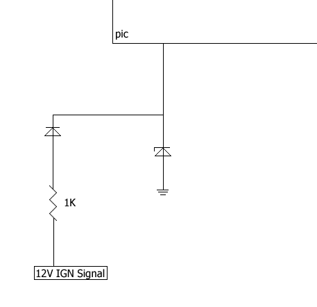

I have an input thats going to come on every so often and need to get it into the pic.
I know there are 100 ways to do this but the problem is I can't change the line at all. There are other circuits also monitoring it. I tried running it into a resistor and then a reverse zener diode but obviously thats a bad idea.
My thought was to use an N-Ch Mosfet, tie 5V to the source, the 12V wire to the gate and watch the Drain at my PIC.
But maybe someone has a better idea ?

Yea, that was confusing so I made this:
This signal is an ignition signal, but it comes from either a micro or a buffereed source (not directly from battery, I don't know which since I haven't cracked it open yet)
With this setup in place the system would not work correctly. Oh, and I wrote 1k, but I've tried it with 10k too.

You don't need the diode on the left. It would mean signal can pull the pin high, but nothing pulls it low again. While the signal is low, the pin is floating and can go high or low unpredictably.
I did that so there would be no change of me pulling this low. But I see what you mean.
Still I'm nt sure why but it doesn't work when this is all in place. The other systems monitoring this never shut down or start up correctly. It doesn't make sense to me, but I know it wont effect anything being tied to a mosfet gate.
A PIC input IS a mosfet gate. It draws no current but does have an internal protection shunt diode that will conduct current from pin to Vdd pin when pin voltage is > (Vdd + about 0.3v). The zener will keep voltage from getting that high. The resistor will limit the current draw on the zener.
The series diode is wrong. The resistor already limits how much current can be pulled off the input. At 12v input, 10k resistance, 0.7mA.
The diode would come into play if you accidentally configured the pin as an output and the load elsewhere on that wire were very, very small. In the worst case the wire could be pulled up to 5v. But that's just not going to happen because the wire won't be that high impedance, and you're not going to configure that pin as an output.

Drop all that booshwah. All you need is two resistors. One goes to ground on one end and the other end goes to the PIC pin and one end of the other resistor. The other lead on the second resistor goes to your ignition signal.
12V ignition--resistor--< PIC input >--resistor--GND
The PIC pin is now at the output of a voltage divider. When the ig-signal is low, its low at the PIC. When it goes to 12V (or higher?) the divider's output is 4 - 5V, if you use the proper resistor values. The grounded resistor can be 4.3k Ohms, the other resistor can be 8.2k Ohm. These are common, easilly obtainable values. You can play with these values A LITTLE, but not much. These values will give you 0.344 of the value of the ignition input at the PIC pin, give or take the resistor percentage of error, usually 5%. 12V in means 4.12V at the PIC pin, easilly within its specs for a high signal. In fact the PIC should work down to 3V, so your input can be as low as 8.72V and still work! Conversely, the PIC input can be as high as 5.6V (if your Vcc is 5V), so your ignition can be as high as 16V! You get quite a range to work within. Also, you won't pull more than a milliAmp while doing this, so you can use 1/4 Watt resistors.

Well.... I got it on the scope and really should have checked this before I made the first boards, but it looks like its a damn multiplexed 5V signal. All my diagrams tell me its 12V/0V, but I come to find out that its indeed a 5V resistor ladder. Feel pretty damn dumb there, than again this is a rather large project for one person... I'll let myself off easy this time.
Well.... crap. That actually still doesn't explain (to me) why it gets screwed up with my former protection circuit. Unless its acting as a sort of pull-down for the whole thing.
This is at least easy to fix now. Tie it into an ADC PIN and away i go. I know, for protection I could use a rail-to-rail opamp in voltage follower mode, thats adding some cost and pcb real estate... but its not very likely tapping into this will cause a failure (pretty low amperage) and I just make sure not to ever drive it high or low.
