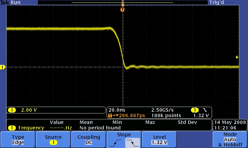

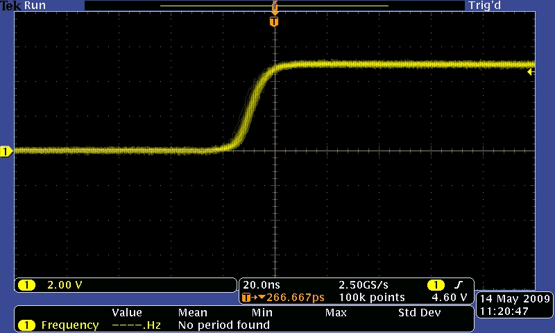

I think I will try to measure the Fres of my large coil first, which should be about 600kHz. I just hooked up and measured a 555 timer to see how fast I could get it to go so that I could measure the large coil, and with a CMOS 555 (TLC555 from TI) I can easily get 2MHz on a breadboard setup (about 60/40 duty cycle). I could probably go even higher but the smallest leaded cap I have onhand is 330pf - everything smaller is SMT. I may try and go higher, as the chip looks to have 20ns rise/fall times at 5V. So could maybe I can even get several more MHz out of it than is spec'd and might be able to use it to target the Fres of the smaller coil (shooting for ~4MHz).
Here are some scope shots. Don't ever let anyone tell you you can't get MHz signals out of a 555 - I just hooked this up with spare values on a solderless breadboard with all kinds of parasitics and managed just over 2MHz. Scope bandwidth is 300MHz, so nothing can hide.
