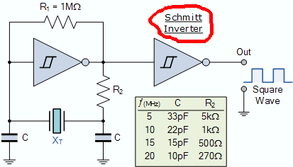

Yes the goal was to make a clock oscillator, so then a logic gate oscillator would be the best way to approach this project? Thank You for clarifying the issues I had previously. Is there anything I should know about constructing a logic gate oscillator?
A few questions if you could answer for me would also be great. I heard that a schmitt inverter as the first inverter would cause frequency distortion, so a 74HC04 inverter would be the best option as the first and second inverter rather than a Schmitt inverter. Would that be the best way to creating this crystal oscillator?

That circuit should work fine with an HC04; you do need to be careful not to over-drive the crystal, hence the resistor in series.
I'd definitely not use a schmitt trigger with a crystal, only with an R-C osc.
Or, you can just buy ready made clock osc modules - they are available in many formats and frequencies, they just need power and you get a logic level output - eg a common size 10MHz one.

With the HC04 inverter oscillator, you may have to put a 1 Meg. resistor in parallel with the crystal in order to get it to work reliably.
