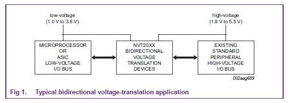

I think I found the part that will do what you want, specifically designed for I2C level translation.
NXP: https://www.nxp.com/products/interface_and_connectivity/i2c/i2c_voltage_level_translators/#overview
App Note: **broken link removed**
Yes thanks Mike. I looked at the data sheet, and they seem to have considered the start-up buss contention possibility i mentioned. They included the "EN" terminal which can force a small delay before the device is allowed to permit communications from low to high or high to low logic levels. That is a good feature i think.
The ready made boards look the same, just dont have that "EN" feature. I believe it could be added though, with a little board surgery :)
They also show a cap and resistor like we talked about to enable the device, instead of having to use another uC pin just for that.
