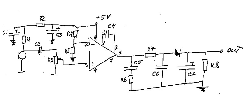

Yes, R4 and C5 make the lowpass filter. Instead of making more load current by reducing the value of R4, reduce the value of C5 to increase the cutoff frequency.
which components for high pass filter: r1/c1 - but it give ~700hz ?
or r1/c1/r2 ? or c1/r2 ?
The electret mic has an impedance of about 1k ohm in your circuit. It is in parallel with the 2.2k resistor R1 that powers it. They are in series with the parallel combination of the 10k volume control R2 and the 50k input resistor of the LM386. The total resistance is 9k ohms which makes a highpass filter with C1 with a cutoff frequency of 178Hz.
if c1/r2 - i must use instead 10k - 20k for lower freq 80hz ? but what purpose r1 in this case ?
Use 0.22uF (220nF) for C1.
R1 powers the FET transistor inside the electret mic.
can I change 0.05uF (0.047) to 0.1uF ? or this value is critical ?
A 0.1uF capacitor will be fine.

Don't use the diode and capacitor if you don't want them.
in "my" circuit "-" of lm386 connect to GND, and in You post - some components present -which purpose it ? (some R+C on "-" input of lm386")
47kOm/1kOm - voltage divisor for 0.1v
22uF - "total" capacitor for power
100uF/1kOm - power filter
right ?
The DC output of your LM386 is +2.5V and you use a coupling capacitor at the output to provide an AC signal that swings positive 2.2V and negative 2.2V.
I used the 47k and 1k resistors to bias the inverting input of the LM386 so that its output DC voltage is +0.7V then the output DC voltage of the peak detector is 0.1V without a signal.
The 1k resistor and 22uF capacitor in my circuit filter the power for the microphone.
The 100uF capacitor in my circuit is the bypass for the battery so that the LM386 does not oscillate when the internal resistance of the battery rises as it is used.
Great job ! very very very thks !!!!
I try modify my circuit from you comment's !
in attachment i paint modified circuit
component values :
ñ1 = 22uF
R1 = 2.2kOm
C2 = 0.22uF
R2 = 1kOm
C3 = 100uF
R3 = 10kOm
R4 = 47k
R5 = 1kOm
C4 = 10uF
C5= 0.1uF
R6 = 10R
R7 = 1kOm
C6 = 0.01uF
C7 = 1uF
R8 = 100kOm
filter below 80hz and under 16khz
with peak detector
this is ok ?

If the 10k resistor value is less than about 4.7k then the sensitivity of the mic will be reduced. If it is more than about 22k then loud sounds might be distorted by the mic.
With the 10uF capacitor at pin 1 and pin 8 of the LM386 IC then its gain is 200.
and in my circuit 2.2k, thus sensitivity of the mic will be reduced ?
