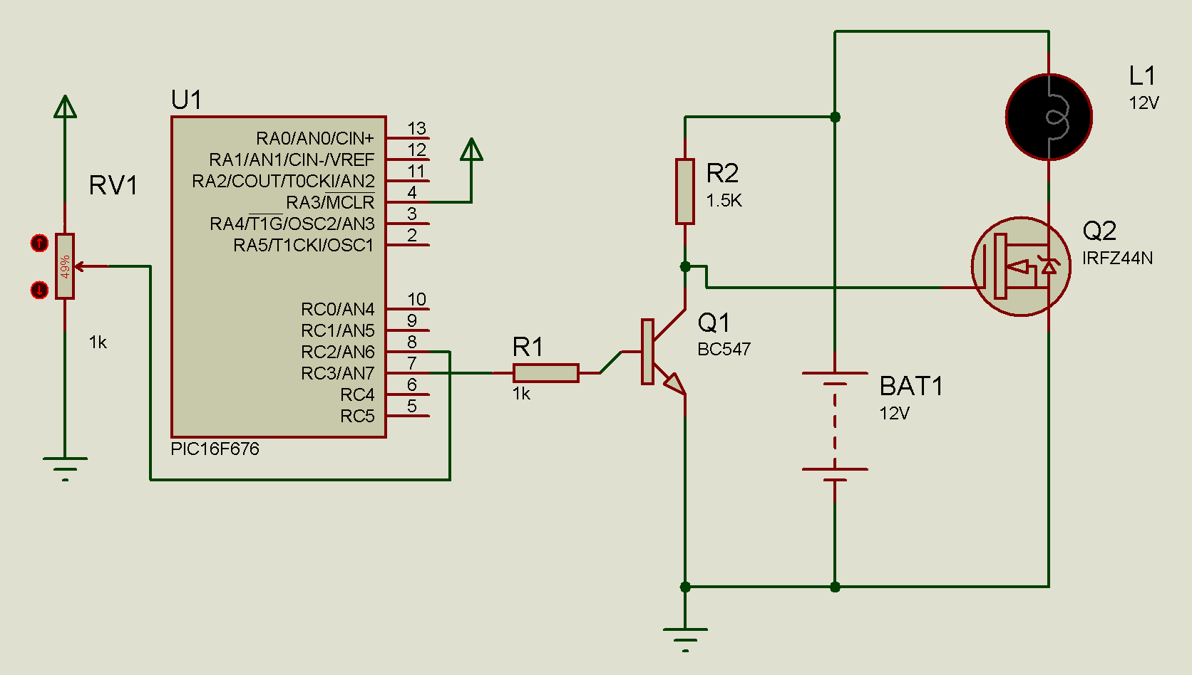

I have done a simple light dimmer project on 16f676. The program, reads a ADC channel
(Potentiometer), calculates dutycyle and adjusts the lights brightness by PWM. Since this
is probably my first project in PIC, I want to know if I have done something silly or I
have done something very awkwardly? Is there something I can do here to make it more
reliable or better?
(I have used LM7805 with decoupling caps at both input and output, for 5 V. the Power)
(Schematic is attached)

I want to use this circuit also to make a battery charger.
For this, I will be
1. Replacing the POT with a resistive voltage divider to read the battery's voltage
2. Replace the battery with the charger
3. Replace the Lamp with the battery to be charged.
What further improvements I need?

I am now going to make the battery charger.
For this I need to write code. I will use this circuit.
I will read the voltage accross the Rsense to read the charging current. But since I am controlling the charge current by PWM, I don't think, the ADC will read the correct average current? What should I be doing?
1. Read the voltage when PWM is high, and estimate the average current by considering current duty cycle?
2. do something else. :)
There are numerous things wrong with that design.
1) The bottom of the current-sense resistor is connected directly to ground, bypassing the FET altogether. The actual ground coming from the bridge rectifier isn't labeled as ground which may have lead to that error.
2) R2 is supplying the turn-on current for the FET by default. This means that while your micro-controller is initializing it's ports and various peripherals, the FET is on and supplying full current to the battery.
If the supply is say for example 16V, then R2 is limiting the peak gate current to V/R = 16/1500 ≈ 0.011A = 11mA.
With Gate Charge of 63nC and a Peak Gate Current of 11mA, it would take roughly 6 µSeconds to fully turn on.
Can you fully initialize your PIC ports, various peripherals, and turn on Q1 in less than 6 µSeconds? :)
If you want to use only a transistor and resistor to switch the FET, use a pull down resistor to to turn it off and ensure it's off at powerup and a PNP to pull it to supply to turn it on.
All you need is a programming bug to stop the PIC and the FET would just be on frying the battery.
Hi, Thanks for the reply.
Your suggestion about using Pull Down for the FET instead of Pull Up is very nice. How about this now.
Also, I placed a capacitor from PIC pin to the Transistor, so that, if the programs hangs and stop giving PWM then, a constant DC level wouldn't pass. I am not sure How nicely the capacitor can do this.
Now for the actual question, when do I read the Rsense? Or, I should place a capacitor accross it (Rsense) so that it will be charged to its average (or what?) voltage?
