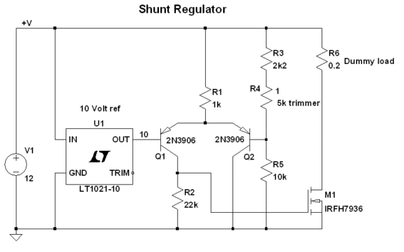

A shunt regulator has been proposed above. It could look something like this :
It's actually a series regulator because the regulating element, M1, is in series with the load. Using a transistor with very low VDS(VCE) sat, would have minimum impact on the normal operation of the system. Any shunt regulator would require impedance in the circuit as has been discussed, and that would impact the system's operation. A complete solution might include series/shunt/filter elements, but the OP already said he isn't interested in such a solution. Unfortunately for him, this is quite possibly what will be required.

Just to clarify, a shunt regulator for this system needs no extra series impedance to work against because there is already series resistance inherent in the system, and this fact was proven with one of the system test results previously posted. Also, the shunt regulator with extra series resistor, the series resistor is sized small enough to allow the regulator overall to function as a shunt regulator.
To refresh, a shunt regulator is a regulator that shunts current to ground and draws the voltage down in doing so. It doesnt matter what the impedance of the shunt regulator is except that it be small enough to be able to shunt the required current to draw the voltage down to a low enough level during a time of worst case voltage rise or power feed. A resistor in series with the shunt leg would be there mainly to remove heat from the power transistor so a smaller heat sink can be used. Alternately a larger heat sink can be used and possibly no resistance or less resistance.
Regardless what is causing the increase, a shunt regulator would in fact work. However, since you are saying that there may be a way to adjust the array controller to help the original situation then that would be the first thing to try.

A shunt regulator can be thought of as a variable "dummy load" that is controlled by some means such as voltage.
A series regulator can be thought of a variable resistor which is controlled by some means such as voltage. Example: LM317

The shunt regulator i was talking about would be like your dummy load except that it would know exactly when to kick in and kick out, and do it smoothly so everything always looks normal. A series regulator would work too, but it would have to be connected all the time which would reduce efficiency. The shunt regulator would be effectively non existent (draw very little current) while it is not needed.
