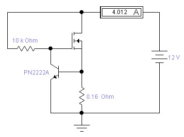

If i were using a transistor or a fet to switch (sink) a load that varied in resistance between basically a dead short or to a figure at the other of the spectrum how could i protect the tran or fet from passing too much current if there was a dead short across v+ and the collector or drain if i had no fuses ?
You could add a current limiter circuit. If you use an NPN bipolar transistor with emitter to ground as the switch, then a resistor in series with the emitter to ground and two diodes in series from base to ground (after the base resistor with cathodes toward ground) will start to limit the current when the emitter current through the resistor generates a resistor voltage drop of about 0.65V.
Could you please add a picture of that circuit ?
What resistor values will i need to enable the current limiting circuit to start restricting the sinking current on a n channel fet when it reaches 4 amps at 12v ?
Below is a limiter that should work.
The 2N2222a bipolar transistor will start to turn on at about 0.6V and removing the FET gate drive, so the source sense resistor should be about 0.6V/4A = 0.15Ω. The simulation gave a 4A limit with Rs = 0.16Ω.
