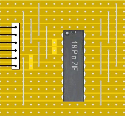

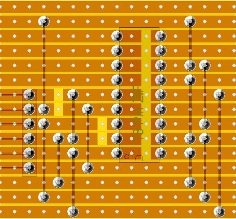

The PK3 does MANY chips, including the 3 you mentioned.
You simply need the PK3, MPLABX (or the older MPLAB), and an ICSP connection to your target board, or a ZIF socket on a little piece of veroboard. Here's an 18 pin one I made.
The required connections are clearly explained in the documentation, available on line.
Hi Nigel,
Hey thanks much. That seems clear and simple to build.
I also found a reference now for the pins on the PK3, which are 0.1 inch spaced and sound like a regular IDE header like that used on the Arduino. If that's not right though let me know. It should be easy to make .
