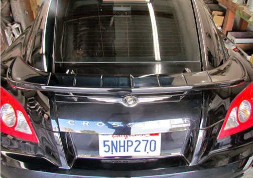

Automatic rear spoiler project

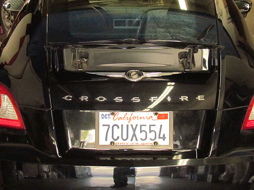

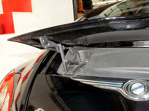

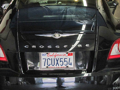

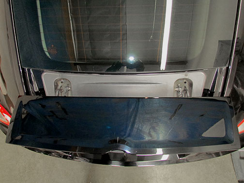

Double Wow! I've not received any notices that there were any more replies since spec's comment 05/26. I'll admit that the opening and closing at fairly specific speeds is something I'd really like, but not at all as important than conveniently raising/lowering the spoiler. As far as using the BCM, it appears as if there isn't any spoiler info. I got brave and hooked up the spoiler/motor directly to the battery, and it goes up nicely - though I didn't run it very far/long. I felt the close-up on the little black box (there's also one on the other side) next to the gear might be important. Could they be the limit switches? There are three pins for them. Each have the a common black wire and one uses a blue and the other is white(?). FWIW it turns out that the brown wire to the motor is ground and the black is +. Keep in mind I do have a full set of service manuals, so possibly these 'units' might have a diagram. I believe the photos should be pretty self explanatory. Do you all prefer full size or thumbnail?

When the spoiler is fully extended it stops short of being past the rear bumper.

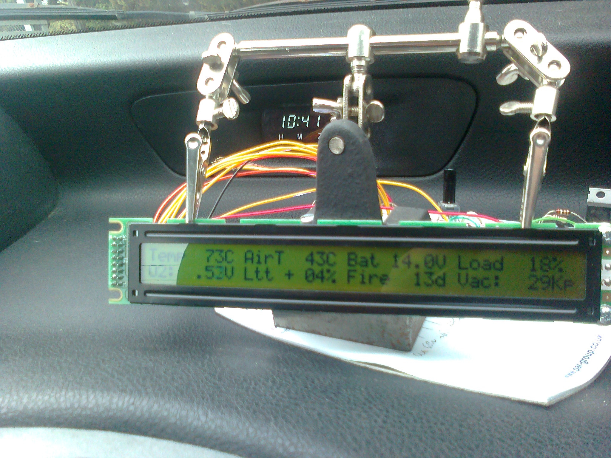

Kinda.
I used a cheap import dongle, it came as a obd2 to usb interface, I removed the ftdi chip and put a 9 way D on the end wired as 5v rs232.
