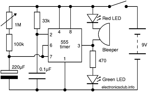

I found this 555 timing circuit that turns a green light on for a set time and then shuts it off and turns the red light on, (which is kind of what I what to do), but I am not sure how to convert it to get the positive to negative and negative to positive function I need on pins 1-10 on the relay.

The other way is a momentary 1 shot using the 555 to energize a miniature relay for a fraction of a second.

I did some more experimenting and found out that all I need to startup the computer is to ground one of the pins on the front panel header. With this information, I could use the 555 to generate a single pulse of 1 - 3 seconds duration to power a transistor if I can use the transistor to ground this pin. Now my question is "can a PNP transistor be wired so that when power is applied to it, it will connect the emitter to ground and when powered off, the emitter is not connected to anything? I may not be asking these questions correctly because the last time I had an electronics class it was called electricity and we did not have IC's and such. I do not even remember us having transistors.
The actual duration of the pulse is a minor issue and can be adjusted depending upon the RC circuit used to control the 555.
That is what I suggested in post #4 but you could use a small fet such as the 2N7000 to sink the pin to common (GND).

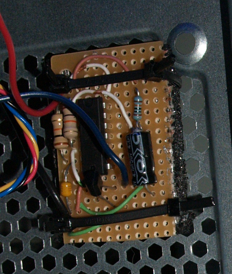

Thanks for the information Ron. This is kind of the direction I was guided in by Max, although I was still unsure about how to exactly wire up the transistor to the motherboard. I did find the one pin on the motherboard's front panel header which when grounded would boot up the PC. I was at the point where I was looking to sink that pin to a chassis ground, but it is good to know that all I need to do is sink it to the other pin on the power switch connector.
As you can probably tell, electronics is not my forte and more often than not I end up frying something, so I wanted to be real careful this time. Since I want this to start on the application of the 110Vac power to the PC, I am going to apply the PSU 5V standby to a 555 timer circuit which will generate a single pulse of a short duration, which as you said should be sufficient to trigger the NPN transistor and boot the PC. I am glad I have finally found someone who has actually done this so I know it is possible. Unfortunately I spent 30 years working in an industry where I blew things up and still do that sometimes with this electronics stuff.

Well I finally completed my circuit which will Boot my PC when 110 VAC power is applied to the system. Once booted, the PC runs normally and shutdown is through the normal software procedures. To repeat the "Boot on AC Power" function, the 110 VAC line has to be cycled off and then back on. The design includes a simple toggle switch to disable the Boot on AC Power function if desired. The circuit has been built and is installed in a working PC (see attached photo). Attached is the write-up on the circuit in case anyone is looking for the same functionality. It should be noted that the 5 VDC standby power stays on for about 20 seconds after the 110 VAC PC power has been shut off. This means that the automatic boot will not work until the 5 VDC drains down and goes low.
  • 555_PC-Boot.pdf
Yay, it works! :)
Ron
