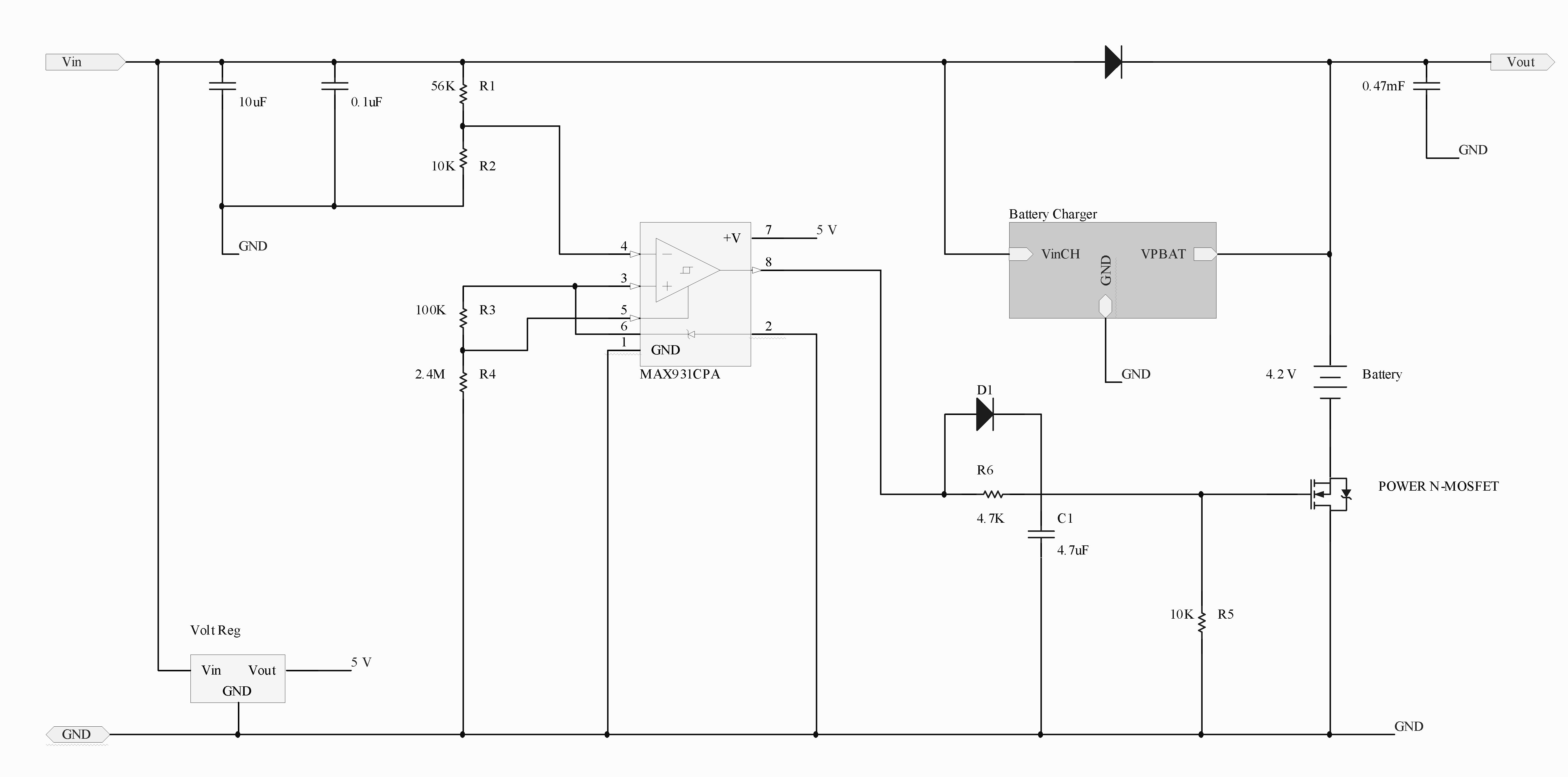

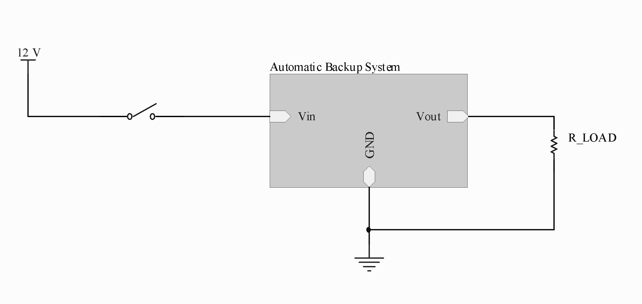

I've been drawing the circuit for showing what I don't understand:
- "AutomaticBackupSystem_connection.png": What I want to do. The switch means that power is off for some hours and power is on for a long time (longer than power-off state).
- "AutomaticBackupSytem.png": What we are discussing. Look that I've connected the Battery Charger and the battery. At the moment I've used a simple NMOS switch. The "block" Battery Charger is detailed next.
- "BatteryCharger": It is composed with a Buck Converter and a Control Circuit. The control circuit senses the battery voltage and current and manages the Buck Converter. Here is integrated an overvoltage protection.
The problem that I see is that when power is on, battery is not charging. Is not it?

Yes, I know the power mosfet has a diode inside. It is enough the diode between the charger terminals?
First let me start by saying that a 40 AH battery is a very large battery to be charging with a 250W PSU. Assuming your PSU supplies only 12V then you are getting about 20A of power out of it. At max charging potential you would be able to charge the battery in 2 hours, but since the load is going to demand some power as well it could take longer. You said that the load only draws 600mA from a 12V source so why do you need a 40 AH battery to power it? It's rediculously over powered and impractical unless you plan on running the load off of the battery for months at a time. Since you said that the PSU will be on for a while each day, you can use a much smaller battery that will charge more quickly and will still deliver the same amount of power needed for such a short time frame.
As for the LVD circuit, I will say that in the second schematic you have posted there are a lot of things that need to be fixed. Starting at the battery charger end of the schematic, you have bypassed the battery charger with a diode so you are forcing the battery to charge whith what ever voltage you are supplying to the circuit. This is a good way to destroy your battery or to compromise the performace of your circuit. You need to have a diod from the positve terminal of the battery to the power bus. I am also assuming that you are just using a lead acid battery to power your load, in which case you don't really need a complex circuit to charge your battery, you only need to make a trickle charger. If you are using NiCd or NiMH batteries, then your home made charger could destroy them and make them useless. If you are using any sort of lithium battery, you may want to have an emergency crew standing by for the fire that is likely to follow your first charge.
Secondly, your power MOSFET is impropperly biased, you need to swithc the source and drain pins other wise the internal power limiting diode is just bypassin your battery and the MOSFET is completely useless.

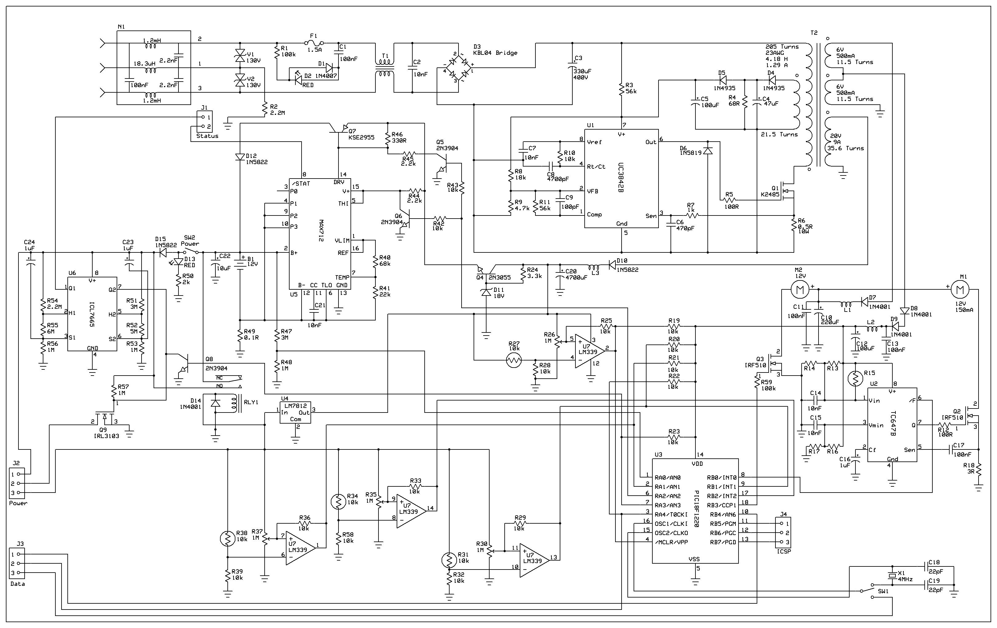

Here is an example of one of my power supply designs that uses this principal:
https://www.electro-tech-online.com/attachments/radio-power-jpg.56332/

This last diode is for avoiding the discharging of the battery into the PSU?
Thank you. I will correct it.
Is going the MOSFET to turn on with a good Rdson (little loses)? It must be for hours.. It is going to get a good Vgs? Can you explain me?

The circuit that I attached is a power supply that I am working on for my radio. I have the load connected directly to the battery (not bypassing the sense resistor for the battery charger). The relay that is shown imidiately after the battery is a bypass relay. As long as the unit is pluged into the wall, the bypass relay is engaged and will allow current to flow around the switch that is in series with the load. The switch is there so that I can turn the unit off when it is running off of the battery to make it last longer. The MOSFET that is connected to the negative terminal of the load is there to ensure that the battery has adequet protection from excessive discharge. If the voltage drops below 9V it warns that the voltage is getting low, if it drops below 8V it disconnects the battery from the load so that it can be recharged once power is reapplied. If the voltage drops below 1V per cell then the battery charger will not recharge the batteries. As long as there is AC power applied, the sensor will allow the load to be powered all the time. The microcontroller is simply there to make sure that everything is opperating properly. As soon as something goes wrong, it sends a signal to the rest of the radio about what has just gone wrong and the a request on how to fix it. The radio will respond appropriatley.
Regarding your orrigonal post, a MOSFET that is capable of handeling 20A is the one that I used in my schematic. The IRL3103 can handel 63A and voltages up to 32V. Just make sure you have an appropriate heat sing connected to it.

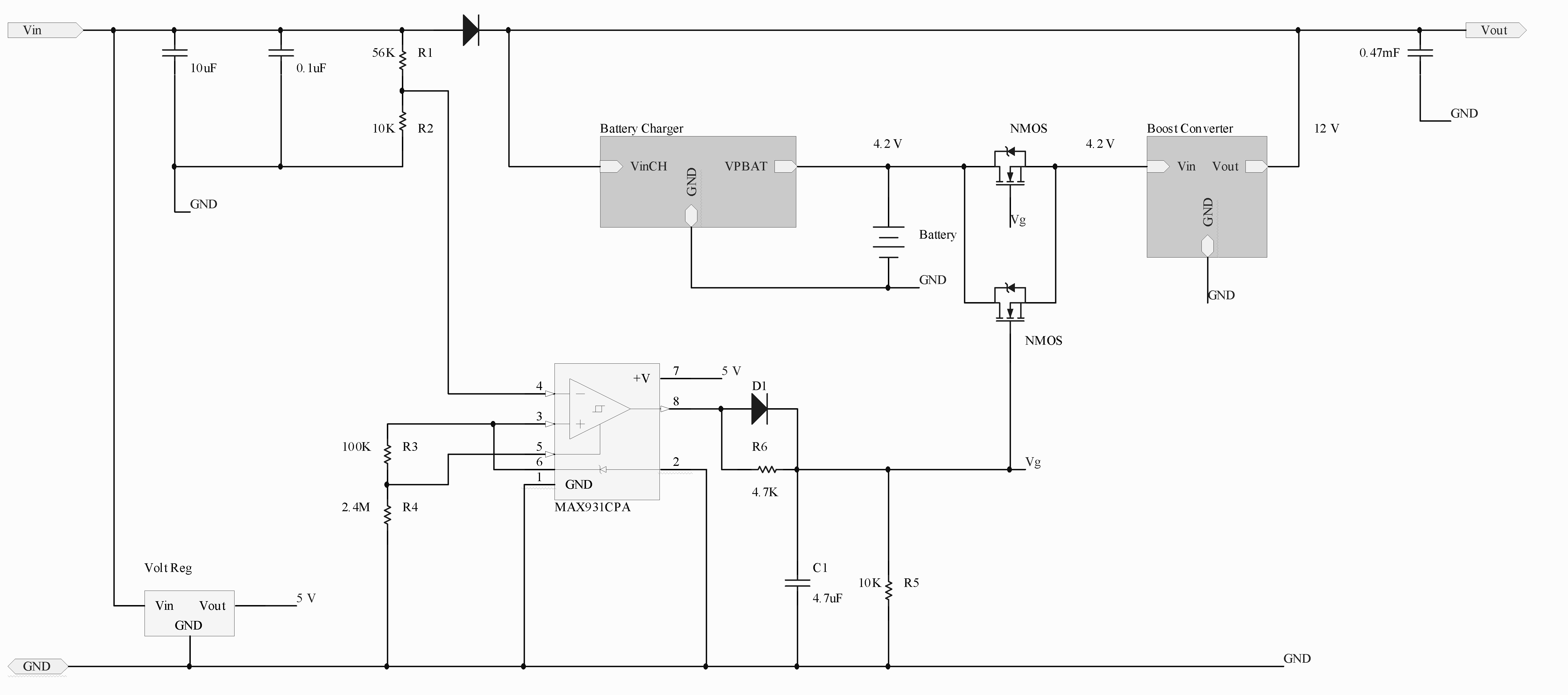

I've been rethinking the circuit and have made ​​some improvements, before answering.
I attach the new circuit "AutomaticBackupSystem_v2.png".
I think the new circuit will do exactly what I want:
- WHEN POWER IS ON: Connect the PSU to the load, connect the charger to the battery. Not connect the battery to the load.
- WHEN POWER IS OFF: Connect the battery to the load with a boost converter for supplying 12 V at the load.

As you can see in the attached file "AutomaticBackupSystem_v2.png", I put a diode before the bifurcation of the charger / battery, to prevent reverse power from the battery. I think this is no longer necessary. Is that correct?
When you are trying to switch the voltage from the PSU to the battery you have to consider the two possible devices you can use in your circuit, a power transistor or a power MOSFET. The choice will depend on what is more importatnt to your load, voltage or current. If current is more important then you will want to use the power tranisistor since it does not have a fixed current drop across it but it does have a fixed voltage drop. Depending on where you have the transistor located it can be either a 0.7V drop or a 1.4V drop. If voltage is more important to your load then MOSFET's are the way to go. The don't have a fixed voltage drop but they do have an internal resistance that will handicap your load at higher currents. This can be worked around by connecting several MOSFETs in parallel so that only a fraction of the total circuit current is going through them. It is exactly the same as putting resistors in parallel to reduce the voltage drop and increase current. If you are simply using a diode, then there is no real need to have any sort of a sensor control the source of power. As soon as the PSU voltage drops below 3.5V the battery will kick in and start driving the load (4.2-0.7=3.5V).
I will use a MOSFET because load is VOLTAGE FIXED. On the other hand, I think is more interesting to use a comparator and a MOSFET (instead of a simple diode) because I can improve the circuit by changing the minimum voltage threshold to activate the battery. Also interesting is the effect "hysteresis" of the comparator, which the diode does not provide.

The last circuit was bad designed. I need a switch to connect the battery to the load, not to desconnect the battery from the charger!
I've been studying a little bit your circuit. I understand that ICL7665 do almost all the work regarding the LVD. Doesn't it? Why not to use a MOSFETs replacing the relay? I guess you do not have many space constraints... Relay is wasting energy when power is on, isn't it? Very advanced circuit...

Can I use correctly an NMOS in the new position (between the battery and the boost)? I am trying to get a good switch, but here is not necessary so much current so I think is a little oversized to put two NMOS (for losses and for saving the heatsinks). I want the circuit not too large. I have space constraints.

The ~5V output from the comparator won't be high enough to turn the MOSFETs on, or fully on, if their source voltage is ~ 4V. So you will need a comparator positive supply >>5V.

Now we have 2 options:
1- Look for a Boost Converter IC that have a "shut down" pin. This will "disconnect" completely the battery (4.2 V) to the 12 V supply? I'm interested in using ICs that are commonly available, because I don't want an IC that is going to become obsolete or "the only solution" in a few years..
2- Use the MOSFET transistors for "disconnecting" tha battery to the boost.
Which do you prefer?
And here comes the million dollar question: When power supply is off, what happens to the comparator that is fed from it? It is going to turn on the connection from the battery to the boost? What can I do?
Thank you!
When the power supply is removed, the comparator is going to shut down. If you connect the comparator to the same leads that power your load then it will always receive power from either the battery or the PSU. The LM393 has a fairly low current draw, at 5V it draws about 400uA-1mA at 30V it draws about 1mA-2.5mA. It should not affect your circuit very much.
The boost converter may provide some isolation between the battery and the 12V rail but it depends on the converter you use. Some circuits have a diode that is built in to protect the circuit from reverse voltage. Some don't, with this in mind you must consider this when you choose your boost converter. Based on how you want to build the circuit, the battery must be completely isolated from the 12V rail while it is charging.
I would personaly prefeer to have the boost converter shut down with the comparator rather than have MOSFETs switch over. It is a simpler solution and will give your circuit a little bit more efficiency.
