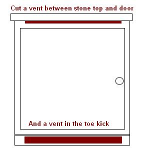

Does the stone top overhang the front edge of the cabinet? You could cut a notch (say 1/4" by the width of the door) out in the wood right where it meets the stone top; it would be hidden by the stone top unless you're looking straight on at it. That plus a vent in the toe kick would give you the 2 vents needed for convection cooling. Add a fan if you need to.
See my attached sketch to see what I mean.

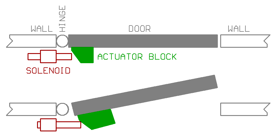

How about using a push solenoid?
Push the door open with the solenoid and close it via a spring.
It requires little space and can be adjusted for any gap size.
See attachment.
Remark: The solenoid was too strong and separated the hinge from the door. :D

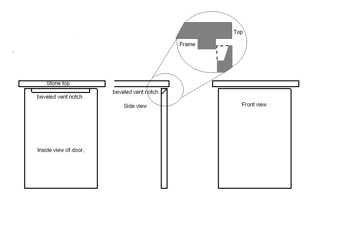

For appearance, though, I would let the air in via the toe kick. To let warm air out, I would mill out vents inside the top of the doors. If the door is 1/2" thick, mill 3/16" off the inside of the door across the top edge.
