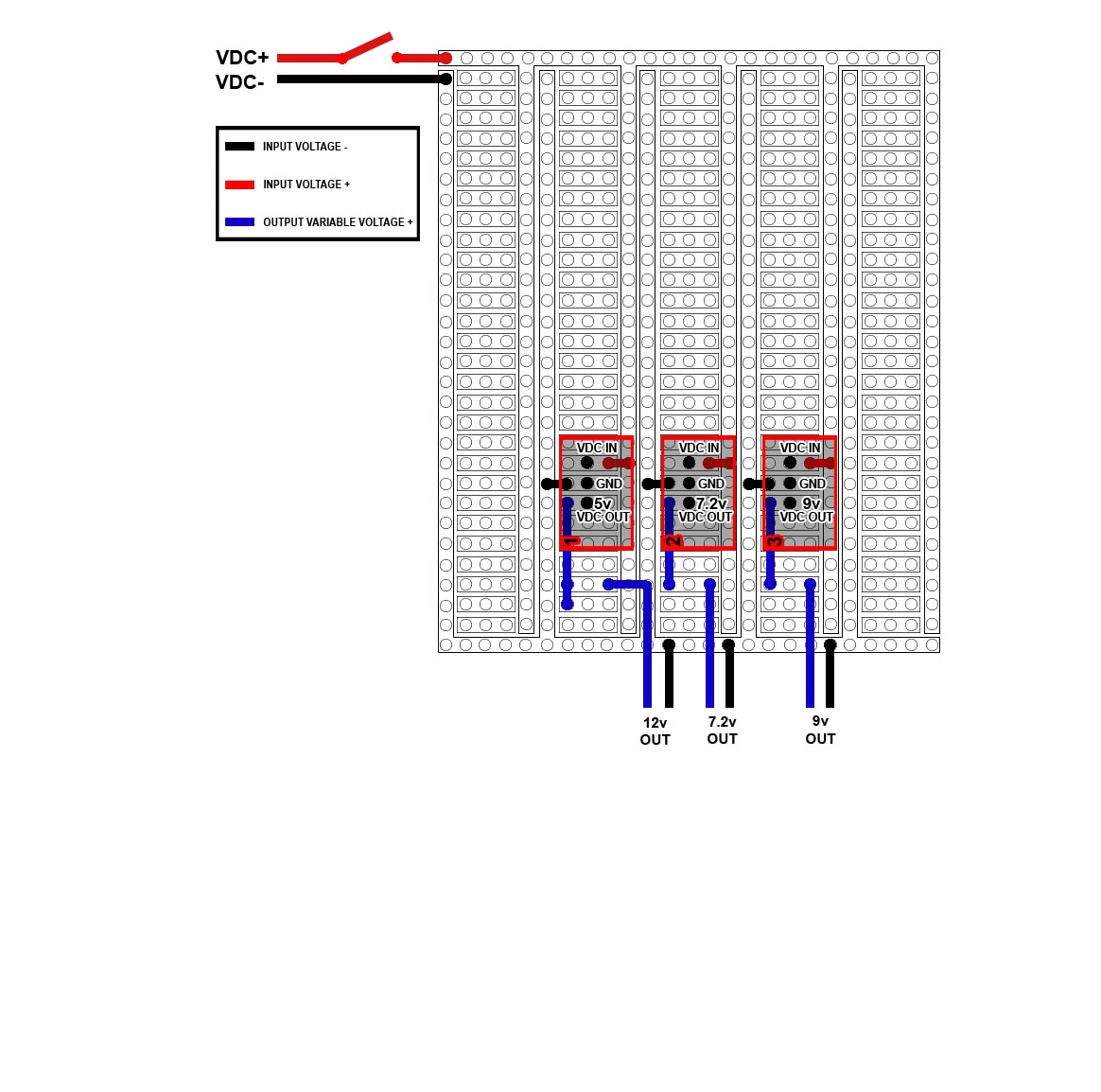

The problem comes when I try to power everything from the main battery. I use SWADJ3 25w switching regulators to go from the 14-16 volts of the Anton Bauer main battery to go down to 7.2v for the camera, 12v for the monitor and 9v for the external preamp.
If all the elements are powered separately, everything works fine.
If I use a common battery for everything, it generates a huge amount of noise.
It doesn't sound like a ground loop. I used ground loop isolators, no luck.
The noise fluctuates depending on what the camera does. If it's idle, less noise, if it's computing a lot (recording, using video out), there's more noise.
Someone told me it could be oscillation because my power source is not stable enough, so I built a circuit based on a LM317 (may be more stable than the SWADJ3) no luck.
Obviously the problem comes from the fact that all the elements use the same battery, so I bought a virtual battery (**broken link removed**) to power the preamp, no luck.
I'm still convinced that I need some kind of circuit that would create two isolated completely independent power sources from one battery but I can't find anything like that on the web and my knowledge in electronic is too limited to be able to come up with one.

Seems like one (camera?) is coupling its' power system noise to the others. The high pitch maybe the DC-DC converter it's using. An o'scope should help see & qualify activity/device to the trouble.
I'd start with decoupling capacitors (.01, .1 ceramic & 1uF tantalum) Right At the power inputs of each object. Good Hunting, this can be hard to suppress. <<<)))
P.S. The video raster signal explains the camera display & video out. The additional "noisy" signal And power consumption point to decoupling too.

Here's the schematic for the PSU with the SWADJs. As you can tell, pretty basic, which is probably why I have issues.
12v is for the monitor.
9v is for the preamp
7.2v is for the camera.

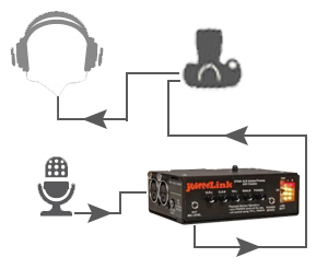

Also, the diagram to show where the sound comes from and where it goes.

The sound has been recorded from the headphones out of the preamp. It would be exactly the same to record it out of the camera.

So I started looking for a more stable regulator and I came across **broken link removed**.
I just finished making and testing it and...no luck.
I did 2 things:
first I powered the preamp with the new circuit and the camera with the SWADJ = noise
Then I powered the camera with the new circuit and the preamp with the SWADJ = noise
So either it's not stable enough or it's another problem.
