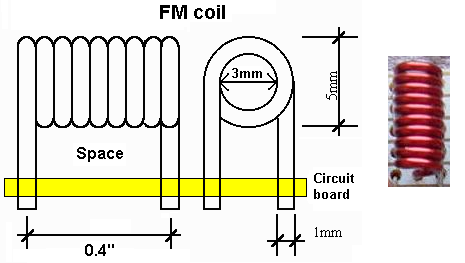

The inductor you selected has a very high resistance and its self-resonant frequency is too close to the high end of the FM broadcast band.
I made my inductors with enamel-insulated 1mm wire from a speaker's crossover coil. I wound them tightly on a 3mm drill bit, spaced them a little above the circuit board and used a knife and sandpaper to remove emamel from the ends for soldering.
Their resistance is extremely low and their self-resonant frequency is very high.
Since my FM dial is full of stations, I tuned my FM radios to a low power foreign language station on the other side of my huge city. Then I tuned my transmitter so it could be heard. Cheap FM radios are overloaded by the transmitter when it is close, causing the transmitter to appear all across the dial. My Sony Walkman radio has an antenna attenuator switch (local, distant) that allows tuning with the transmitter close.
Here is my home-made coil:

hi there audio guru,
Thanx for the information on the inductor...based on your diagram, you have 9 turns of a 1mm wire right? so the following can be calculated :

then the inductance of the coil would be=0.06933uH
This value deviates from the 0.1uH of your original circuit. Would this affect anything?
on the other hand, you mentioned that the resistance is too high and the self resonance is too close, what about this one?we basically try and avoid self resonance as the impedance would be very high at resonance right?
what about this one with 0.26 ohm dc resistance and 1310MHz resonant frequency:
EPCOS|B82498B3101J|INDUCTOR, 0805 CASE, 100NH | element14 Malaysia
thanx in advance for the great help!
Better use this calculator **broken link removed** select aircore.
try loading 0.1uH, dia (wire centre to wire centre) .4mm, coil length as 10mm, you get 8.7 turns and WIRE #17AWG. wire length is almost 11cm
these readings are very close to the spec prescribed by AudioGURU. also it is dam cheap to workout from even recovered wire. adds to experience. Your mony in RM is useful for other components.
I simply copied my coil from other FM transmitter projects. I don't know if the coil is actually 100nH because nobody ever measured its tiny inductance.
The EPCOS coil is fine and is much better than the other one that is manufactured.
