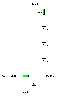

I am a bloke and as a result I like music...loud music and what better to go with loud music than LED's that will sync with it? I have searched high and low and everyone seams to rate this circuit but wont that blow up? There's nothing stopping the voltage going to high and may end up popping LED's!

It is a hopeless circuit that is designed by somebody who knows nothing about electronics.
The base-emitter juction of the transistor is like a dead short to the music source so the music source will sound very distorted just before it blows up.
The LEDs do not have a current-limiting resistor so they will also probably blow up.

Here's a simple circuit that won't blow up.
A half-decent circuit that blinks LEDs to the beat of the music is fairly complicated. I have a project that has 20 LEDs in a VU meter. Its input is a microphone and it shows a pin dropped on the floor in the next room up to very loud sounds from music.
I don't see why you need a complex circuit unless you're building a colour organ.
Maybe a pot. could be added to adjust the flashing level or a low pass filter if you just want the bass to flash the LED; both are fairly simple. The circuit I posted might not have any of the aforementioned but at least it won't blow up.
