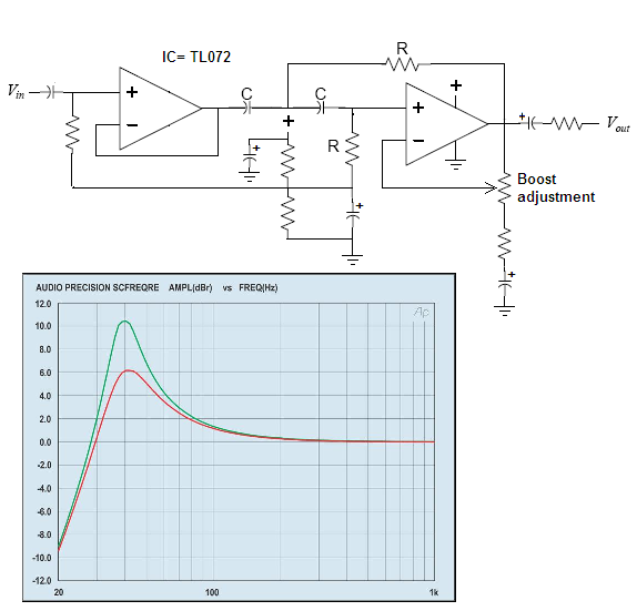

pixnum said:
Audioguru,
Can I see your bass-boost circuit diagram ?
My Bass Extension Circuit is a Sallen and Key highpass filter with its feedback set high enough to cause a boost just after cutoff.
