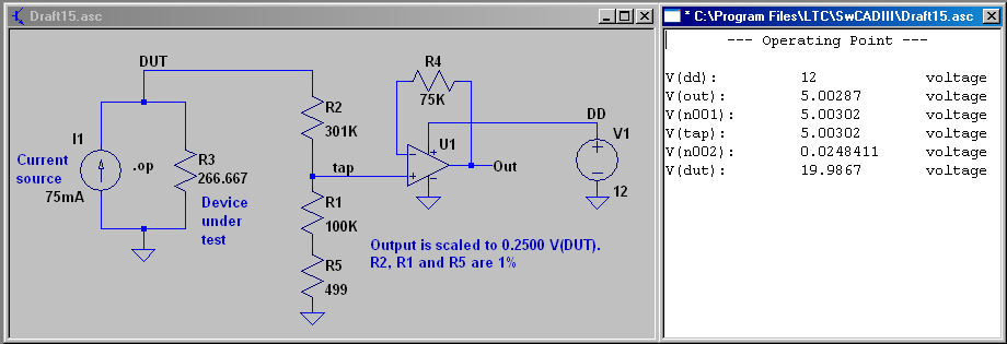

Hello All,
I'm working on a project which uses a ATX power supply. So I can only input up to 12V.
I have a current regualtor (fed by a step-up converter) connected to a variable resistor. I'm trying to measure the resistence using an Arduino ADC.
The problem is at high resistence the voltage is ~17V, so I need to attenuate is to match the 5V limitation of the Arduino.
Thought of a buffer but because I can only feed 12V it can't copy out 17V. What would be the best solution? A simple resistor voltage divider isn't accurate enough for the range of resistences.
Appreciate any help

You understand perfectly what I'm trying to do. However the 75mA current is necessary (it's the critical current for the superconductor). So I'm stuck with the 17V range...
Something does not compute. Suppose you were reading the 17V with a 10X scope probe, which has a 10megΩ input impedance. The current that would flow through 10megΩ at 17V is 17/10^7 = 1.7uA, which is tiny fraction of 75mA.
Turning this around. Suppose you want to measure the voltage with an accuracy of 1/1000. That means the current through the voltage divider must be < 0.075/1000 = 75uA, which means the divider resistance must be > 17/75u = 220K.
So any appropriate resistive voltage divider with a total resistance greater than 220K would do it.
Is your problem buffering the voltage that appears at the tap of the voltage divider?
I couldn't agree more. Theoretically the voltage divider should do its job with resistors so big. But I measured the voltage directly across the load and across the divider and am getting a gain that depends on the load.
I can't buffer the voltage because I have at most +-12 DC source, so an active buffer would clip the output at 12v. That's why I'm looking for a completely passive solution.
So what is wrong with this? I scaled 20V to 5V, guessing that you are using a 5V full-scale A/D. Note the very slight reduction of V(DUT) [19.9867V vs. 20.0000V] due to the current flowing in the voltage divider. The feedback resistor around the opamp minimizes the effect of opamp input bias current.
