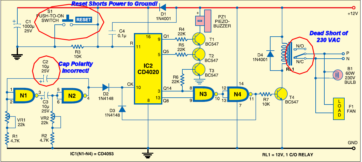

I'm doing a project and in my project it has a Schmitt trigger configured as an astable multivibrator(CD4093) to generate a clock which is connected to a clock pin of timer CD4020...the astable multivibrator can have preset value to gennerate a clock of the timer CD4020 which can be calculated.My question is how can i display the status of the astable multivibrator,so i know how much time is left for generating a clock(say 30 minutes) for the timing IC CD4020?

there is the circuit i wish to have the status of the astable multivibrator

Maybe I am missing something and this is not quite on topic as to the question but looking at the circuit when the reset button S1 is pressed it places a dead short across C1 the 1,000 uF filter cap and also places a dead short to ground from your 12 volt supply to ground through diode D1 which will become very unhappy real quick. Am I seeing that correctly?
Additionally looking at the P and N terminals which I assume to be 230 VAC that powers a lamp and fan. With RL1 contacts in the N/C state there is a dead short across line voltage as I see it. Won't this cause bad things to happen?
Unless I am missing something in this, the least of the worries of anyone building this circuit up is what the multivibrator is doing.

The multivibrater oscillator is a joke. The capacitor C2 has its polarity backwards.
I have never seen any circuit work properly from that site in India.
A single Schmitt-trigger inverter or a Schmitt-trigger gate connected as an inverter makes an oscillator and its capacitor always has the correct polarity.
Schmitt-trigger gates should never have their inputs tied together. The unused input should be disabled so that only one input is active in the circuit.

If you choose to build this I suggest yopu look at just a few of the bad problems. Do not even think about applying mains power as it shows. The reset is completely wrong also. That seal means nothing as there is absolutely no way the circuit would work as drawn. The circuit is garbage. Also, I suggest you already have the CD4020 as I believe it is obsolete? You may want to check on that or possibly sub a CD4060 and redesign everything wrong with the circuit.

Christy, let me share with you part of the problem you will face trying to read the output(s) of the CD4020.
The way the circuit is supposed to work is that clock pulses enter the 4020 on pin 10 the clock in. The counter is advanced one count on the negative transition of each incoming clock pulse. The counter is reset to the zero state by a logical “1” at the reset input pin 11independent of clock. (Note in the drawing the counter reset is tied to logic high so won't count but anyway moving along). All the counter knows is that it counting pulses it has no clue what they mean, it has no regard to time. Hold that thought.
In this case they try for a clock of .21 seconds and if we do the math for the clock circuit (which as AudioGuru points out is a lousy clock) it would be .207 second but I guess we can say .21 second as it is close enough for this. So lets move along to actual time in hours. We know there are 60 seconds to a minute and 30 min = 1/2 hour. Therefore 1/2 hour of time = 1,800 seconds. Since our clock pulses are .21 seconds it will take 1,800 / .21 = 8,571.43 pulses for 30 min. Forget the .43 but we still have 8,571 pulses to make our 30 min. If you wanted to display this numerically on a display first it would not be easy and second the numbers seen would not mean much.
Now if you look at T1, T2, and T3 in the circuit. For the buzzer to beep they all must be on and in saturation acting as a switch. (Note: I see 22 KΩ base resistors, I believe that is also wrong, I believe 2.2KΩ would be about right). All three of those transistors, to be turned on need the logic out on Q1, Q5 and Q14 to be logic high. Now you figure out the bit count. Think powers of two and bit weight. All the buzzer will do is a beep when all of those bits are logic high. As soon as any one of them goes low in the count the beep stops. Eventually Q8 and Q14 will hit a high on both bits. When N3 pins 8 & 9 are high pin 10 is low. That low is applied to pins 12 & 13 of N4 making its output pin 11 high and turning on T4 which should in turn allow RL1 to energize. We already covered the disaster at the normally closed contacts of RL1 and mains voltage.
