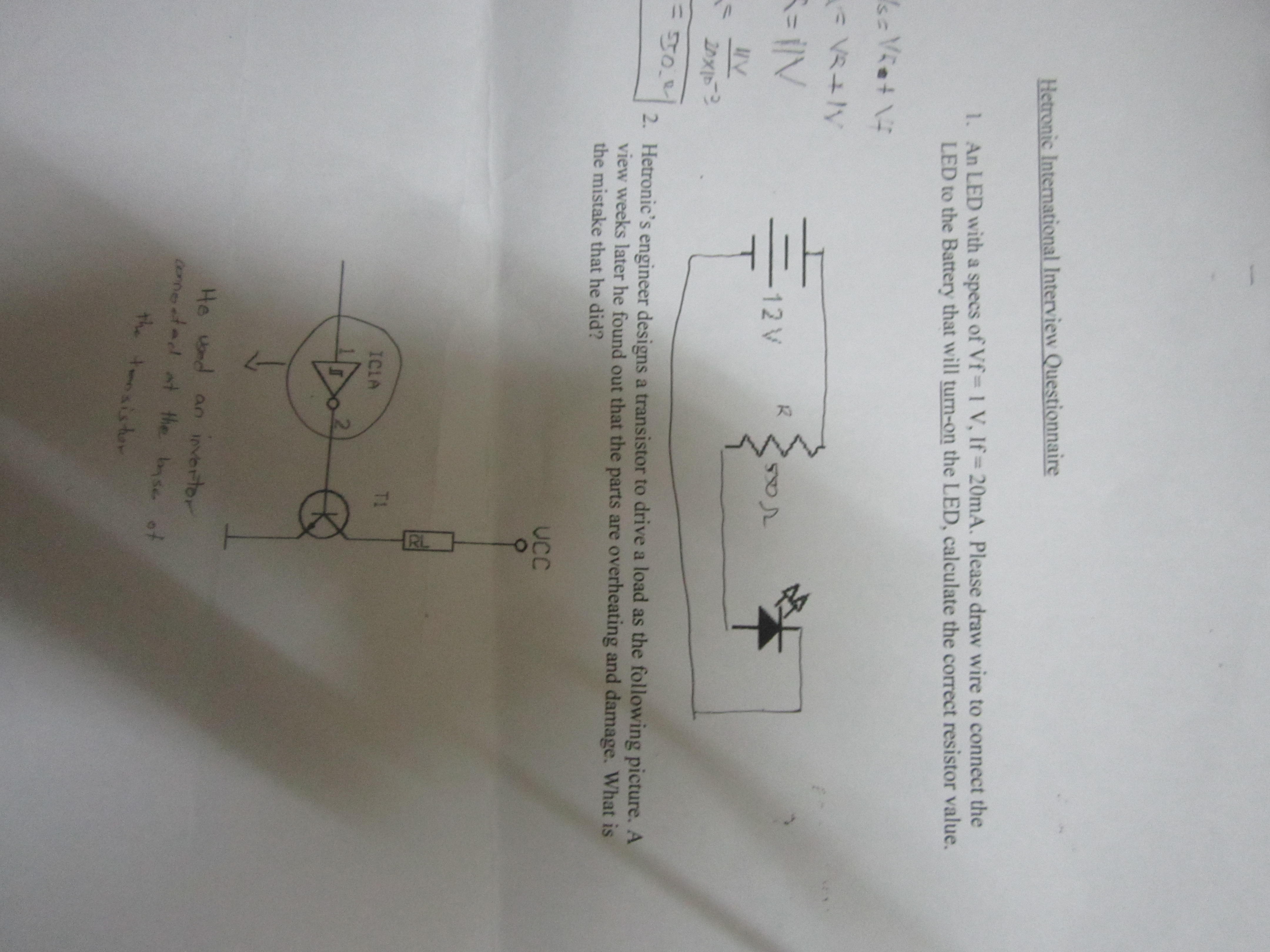

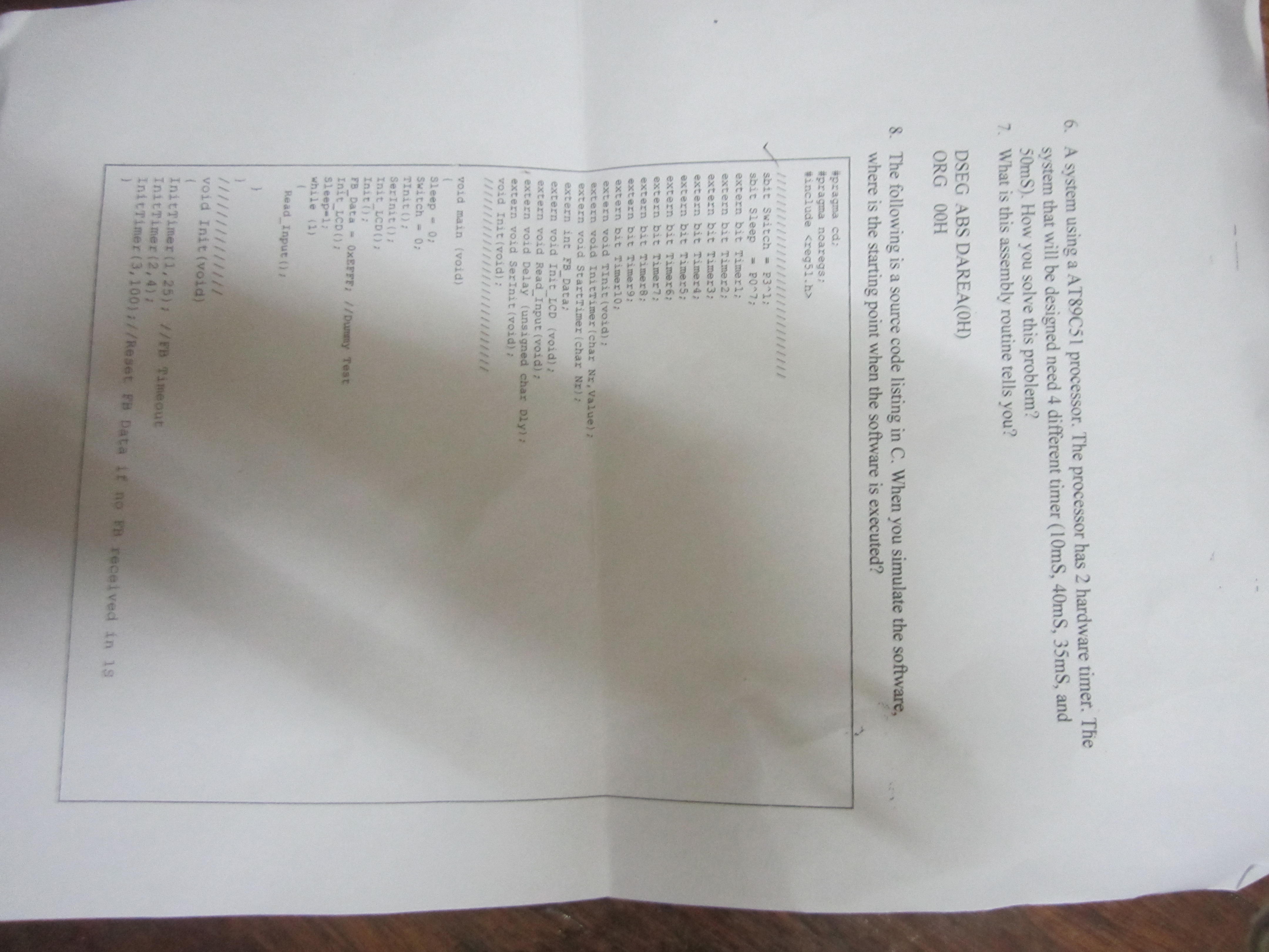

assignment for my ojt
Agon

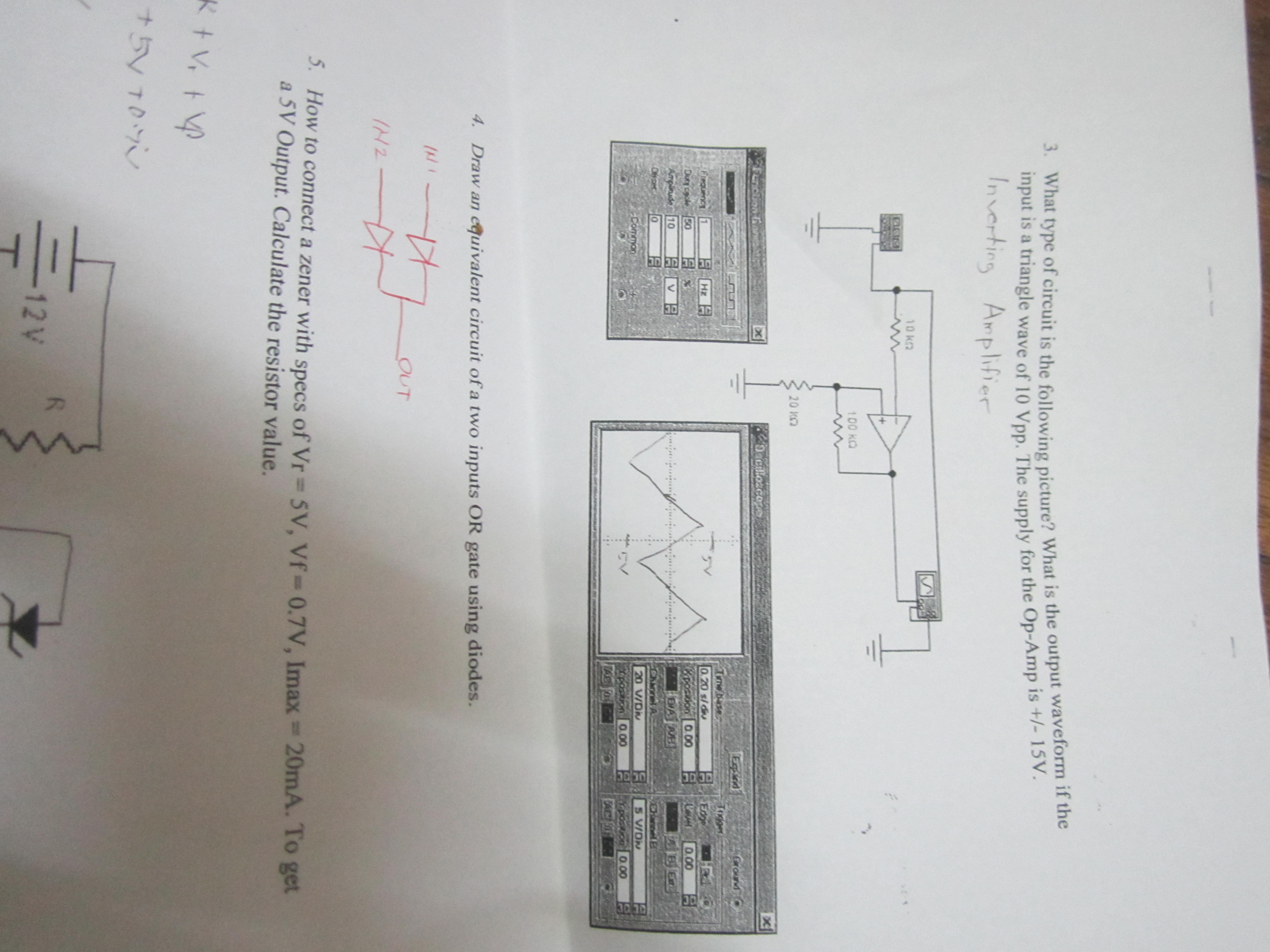

I dont know if my answers are correct. I really dont know the answers. I am just guessing. Please help me guys

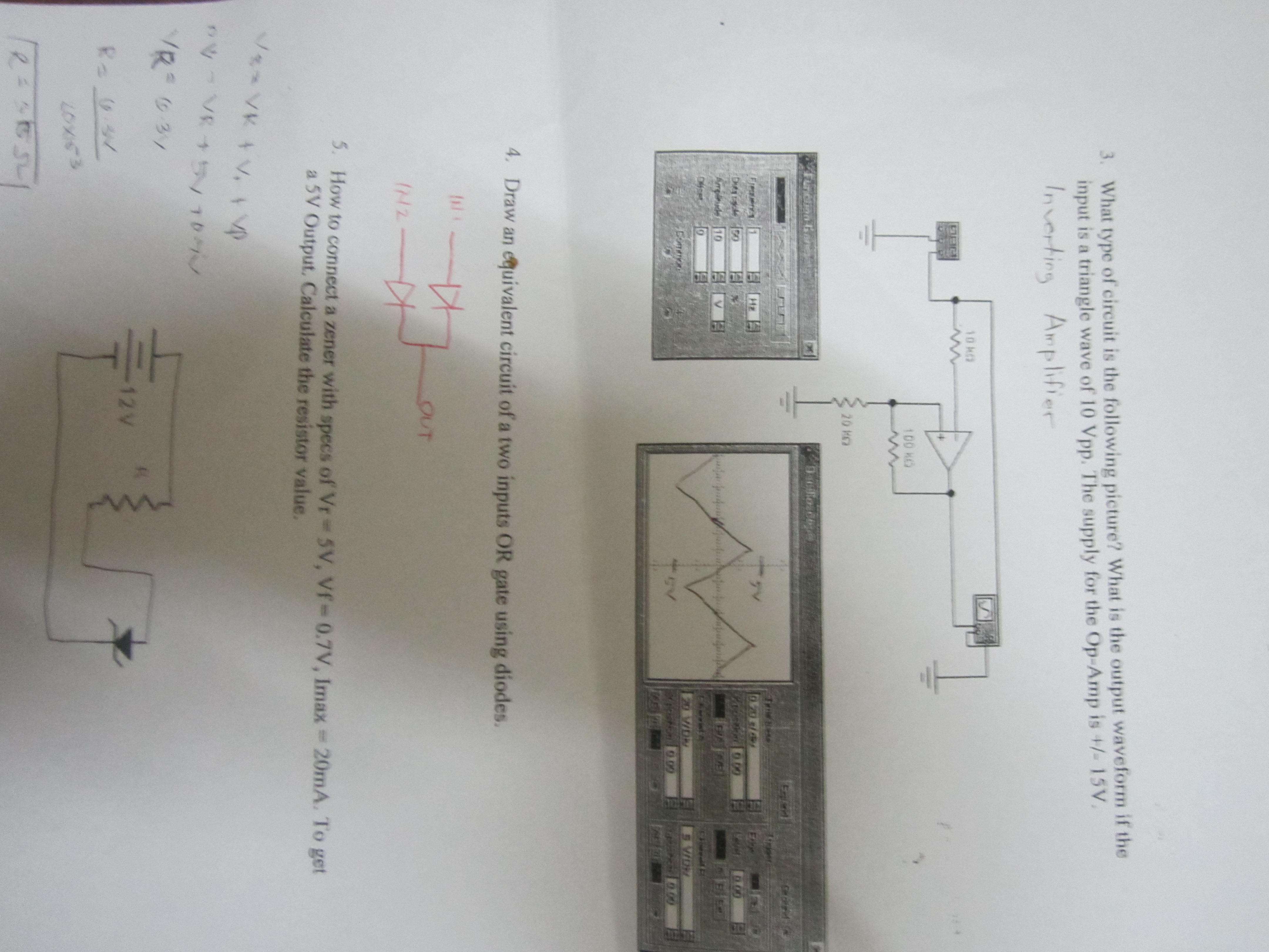

The answers to the amplifier and zener diode questions are wrong.
Hint:
what is the gain of the amplifier.??
what is the forward voltage drop across a diode.??
the amp circuit shows that two channels are connected to scope so you need to show both...
gain can be computed from resistor values and your graph should show proper scale and clipping.
