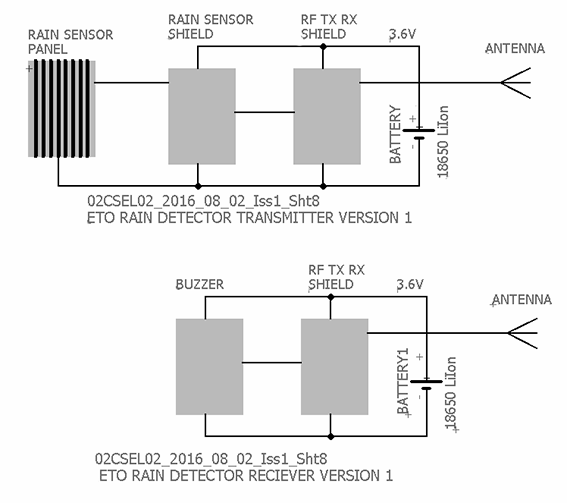

In view of what Jim said in post #6 above about RF reception being OK in rain, below is a rough outline block diagram of a remote rain detection system purely as an opening gambit for discussion/refinement.

Hy boblalux,
It would be handy for us to know what facilities and skills you have so that we can answer your request in an appropriate way:
(1) Do you understand electronics: fundamental circuit theory. Know about fundamental components: resistors, capacitors, inductors, transistors, integrated circuits
(2) Do you have the fundamental electronics tools: soldering iron, miniature pliers and wire cutters.
(3) Do you have the fundamental test equipment: digital multimeter, power supply
(4) Do you have fundamental construction skills: soldering, sawing, filing
(5) Are you able to configure and do elementary programing of an Arduino microcontroller?
Apologies for asking all these questions in such a direct and clinical way. Although it sounds like an inquisition, it is only intended to be constructive and give you the best answer.:)

Hy boblalux,
(1) Do you understand electronics: fundamental circuit theory. Know about fundamental components: resistors, capacitors, inductors, transistors, integrated circuits NOT MUCH
(2) Do you have the fundamental electronics tools: soldering iron, miniature pliers and wire cutters. YES
(3) Do you have the fundamental test equipment: digital multimeter, power supply YES
(4) Do you have fundamental construction skills: soldering, sawing, filing YES
(5) Are you able to configure and do elementary programing of an Arduino microcontroller? NO

OK, as you see, it will have to be very simple! No problem with electrics, but electronics .........
I have updated the link http://www.bobscardmodels.altervista.org/page5.htm so you will perhaps see part of the set-up.
I don't need the rain alarm to be on permamently, but if my wife has the washing on the line, or I am drying lavender blossom outside etc, I can turn it on, go to sleep with the buzzer portion next to my ear!!

Thx, that information helps a lot both about your facilities and skills. The way that you plan to use the system also helps greatly.:)
