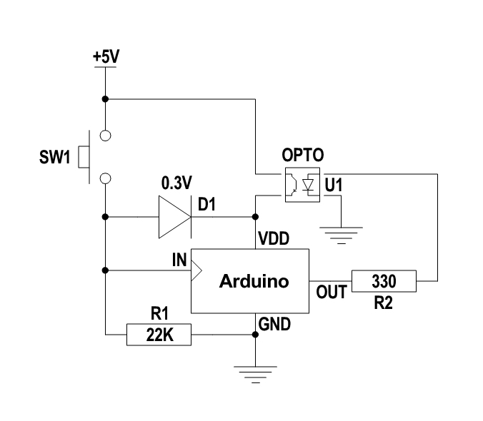

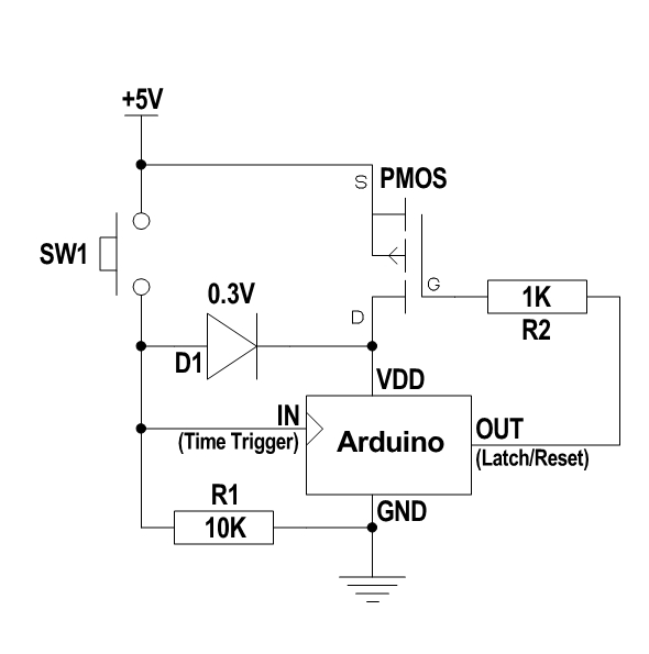

Here is a simple idea. The switch turns Arduino on thru an isolation diode. Once Arduino is on, it immediately turns OUT Low, turning the Pmos ON, Latching the feed to Arduino. This also triggers a timer of certain time (example 1 minute).
Arduino checks for SW press (if IN=High) every 1 seconds. If IN=high, then Arduino resets the 1 minute timer and looks at IN again.
After 1 minute time has passed and no activity on SW, then OUT will go High, Pmos is turned off, and Arduino is turned off.
Next SW press will restart the event.
EG

EvilGenius: Thanks for the feedback, ideas, and circuit work. For my current project, I don't care that S1 is useless after the power is on since I will use a second tilt/ball switch tied to a pin with a more aggressive orientation to detect when to turn the Arduino off. There another project for this circuit where I do care, but your approach will not solve the problem for a stock Arduino board. There is a 1s delay due to the bootloader between power on and the first line of my code being executed...so the switch would need to be held for 1s before the Arduino would stay on. I want an immediate latch on.
The Sw trigger is not for turning off but rather to keep the Arduino on constantly until there is no activity on Sw.
Your 1s start up time is understood. I will think about a solution.
