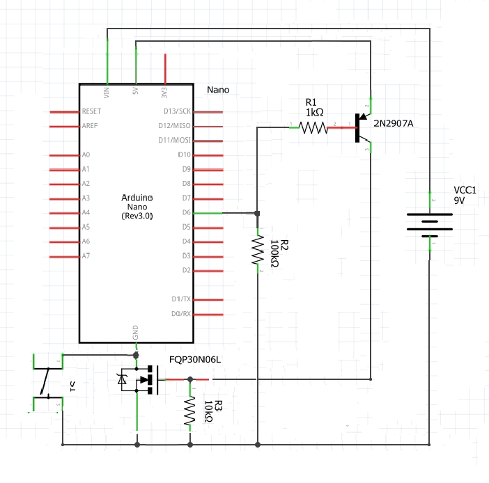

This is my first time on this forum and I'm not sure if it is the right forum or the right place on the forum. I'm trying to create a circuit so that an Arduino turns on immediately and stays after depressing a push button (S1). After that, the Arduino can turn itself off (by taking pin D6 high). Here is my failed attempt:
Without R3, the MOSFET was never turning off. Without R2, the circuit only latches after the code explicitly takes D6 low (after boot which takes a second) , but not before. With R2, the MOSFET latches on immediately, but does not turn off when D6 goes high. Any help would be appreciated.
The requirements are as follows:
  • The Arduino starts completely off, not in sleep or standby
  • On the press of a momentary push button, the Arduino comes on and stays on. After that, the push button does nothing as long as the Arduino is running.
  • At some future time, the code running on the Arduino can turn itself off. In the above circuit, it would bring pin D6 high.
I have several projects this circuit would be helpful for, but for different reasons. Here is one. Imagine a Magic 8 ball with a digital screen rather than the liquid and a 20 sided die. When the user picks up the 8 ball, a tilt sensor/ball switch makes contact and turns the Arduino on to display the info. When the Arduino senses that it is back face down for some period of time, it turns itself back off. In all likelihood, the ball will sit around for days or even weeks between uses, so there is no reason to use up battery by having the Arduino in sleep mode.
What I'm trying to do in the circuit above:
The MOSFET acts as a low side switch for the Arduino and the battery, so the 9V and 5V grounds are connected when the switch is pressed. When S1 is pressed, power goes to the Arduino and the MOSFET gate is turned on via the PNP transistor. With the MOSFET on, the Arduino stays on even after the push button is released. At some future time, the Arduino code brings D6 high turning off the MOSFET and therefore the Arduino. The circuit almost works. The problem is that D6 floats during the boot, so the circuit only latches after the code brings D6 low. Adding R2 (tried various values) keeps the pin from floating, but then for some reason, the MOSFET does not turn off when D6 is brought high.
Hi Robert
Your diagram is very unreadable. Please redraw it so people can understand it at a quick look.
If your ground of 9V battery connected to the ground of 5V and ground of your Arduino?

I edited the question to add more info:
The switch and the MOSFET complete the connection of the 5V and 9V grounds. That is what allows the Arduino to turn on.
I'm a programmer with little EE experience. I don't know the standards or what you are looking for to make it more readable. If you can point out examples or standards, I'm willing to learn.
I can see why this layout is easier to read. Thanks. There is one difference. R2 ties to the ground of the Arduino in my circuit, not 9V ground. Are you suggesting that it should tie to the 9v ground?

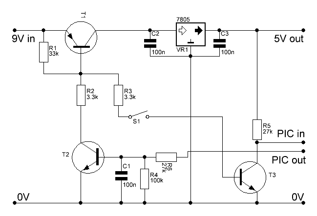

Here's a circuit that I've used a LOT recently, I 'stole' the idea from an AVR based component tester.
It uses two pins, one IN and one OUT - this allows you to switch the unit OFF by pressing the button, if you want to do so (or anything else you might want to use the button for, after it's powered up).

Actually, without the PIC running, I don't see how T1 gets turned on. Is it through the base at T3?
Thanks Nigel. The in and out is cool and simplifies an interface issue for another project. A few questions.
  • I can only see this working instantaneously if digital pin used for PIC out is pulled high by a resistor. Correct? If not pulled high, the pin floats and the behavior would be undefined until after boot which seems to take around a second on the Arduino.
  • What are you using for T1, T2, and T3 in your circuits?
  • I assume that R2, R3 and R6 are specific to the transistors used and the expected current draw?
  • What is the purpose of C1?

Hi robertbu, I was thinking of suggesting that circuit but realised that your code did not start running as soon as power was applied to the arduino. I have used it with an ATtiny13a running on it's internal 9.6 Mhz clock. the port that holds the power on is activated about 1 uS after power is applied.
Yes.
PIC's power up near enough instantly, as does an AVR - if your Arduino (which is just an AVR on a development board) is taking a second then there's possibly a problem somewhere?. Or does the Arduino perhaps wait to see if there's any bootloader instructions before it runs?.
The first thing my PIC program does is set the required pin as an OUTPUT, and sets it high to hold T2 and T1 both ON - there's loads of time (in PIC terms) to do this, while you're pressing the button.
Just general purpose NPN and PNP transistors - if you need any serious amount of current then make sure T1 is capable of it.
Not really, there's no great accuracy required - they all operate as switches - I think the values were the ones used in the original, but they aren't at all critical.
I imagine it's for 'noise' prevention?, such as a brief low 'blip' out of the PIC not shutting it down.
Most of the units I've used this in do auto-shutoff, so you can either press the button to turn it OFF, or wait until it times out.

Can you check the voltage on D6 when it being driven high ? I initialy thought the problem may have been that the ATmega328 was only being powered with 3,3 volts (which would mean the the output when D6 was high was only 3.3 volts so the 2N2907 would still have 1.7 volts driving the base.) I found the schematic of the Arduino nano and it shows that the ATmega328 is being powered from 5 volts so that is not the problem. D6 needs to be at least + 4.5 volts for the transistor to turn off. Can you also check the voltage on the gate of the FQP30N06L when D6 is high ? I have just noticed that when Ian has drawn R3 between the gate and source. (Which is where I would expect it to be.) On your schematic its is connected between gate and drain. (I don't understand the reason for connecting it that way.)
It is between the gate and source on my circuit also. I don't know about the conventions in drawing a circuit, so the MOSFET is probably upside down in the drawing from what you expect.
I assume you are talking about the MOSFET? The datasheet for the FQP30N06L says that the max gate threshold voltage is 2.5V. How is the 4.5V calculated?

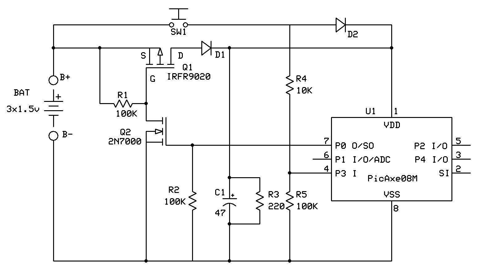

This a circuit that I use with a PICAXE microcontroller. It can be operated as Push-ON/Push-OFF and Push-ON/Program-OFF.
Ken

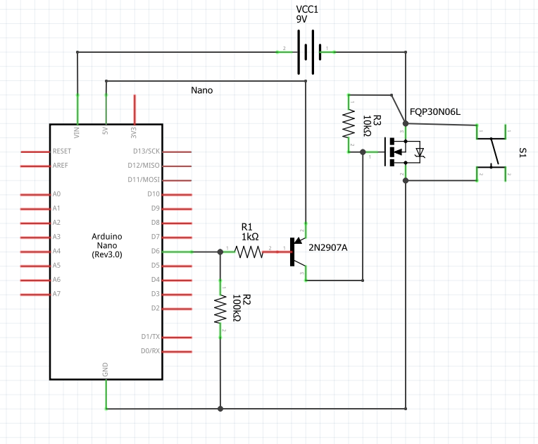

The circuits provided, the feedback, and the questions have given me an answer about why my original circuit was not working. I've also developed a circuit that works, but I'm not completely comfortable with it.
What was happening with the original posted circuit:
  1. On startup D6 is pulled low by R2 and the circuit latches immediately
  2. The first line of code takes D6 low, which does nothing given R2
  3. Six seconds later the code pulls D6 high (to test turning itself off) and the power to the board is cut off as designed
  4. The voltage drops until it hits the brown-out point of the Arduino
  5. The Arduino reboots and therefore D6 is no longer held high
  6. R2 pulls D6 low again before the voltage regulator is full discharged
  7. The PNP transistor is again enabled which causes the MOSFET to reestablish power to the board
  8. Six seconds later, the cycle starts over again
The reboot was not obvious until I ran some tests.

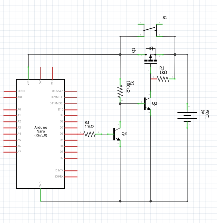

Here is my redone circuit that does latch instantaneously and is turned off by bringing D6 high. It is a high-side switch this time given Nigel's comment:
The combination of Q1 and Q2 are self latching and work regardless of whether the Arduino is there or not. My two concerns:
  1. This design depends on D6 not being interpreted as high while it is floating during boot. It works for the Nano on my desk, but I cannot say that it would work on any arbitrary Arduino board.
  2. The value of R2 was set by trial, and I have no idea of the optimal value.
Feedback is appreciated, and thanks for what has been provided so far.
I assume that you have changed to a P channel mosfet. You could add a resistor of about 10K between the base and emitter of Q3 to ensure that it was switched off when D6 was floating. (This is probably not needed unless Q3 had a high leakage current.)
In post #15 I did mean that the voltage on D6 must be greater than +4.5 volts when it is high as the emitter of 2N2907A is at +5.0 volts so for the transistor to turn off the the base must be less than 0.5 volts negative of the emitter. The mosfet will not turn off until the transistor has turned off.

Les: Checking the voltage over time at the base of the transistors was the ticket to understanding the problem...something I should have been bright enough to do before posting the original question. I currently feel out of my depth designing my own circuits.
Quick question: Could I have solve the original problem by adding a capacitor and appropriate current limiting resistor to the D6 pin to extend the time the pin was high...and if so would that have been a good solution?
