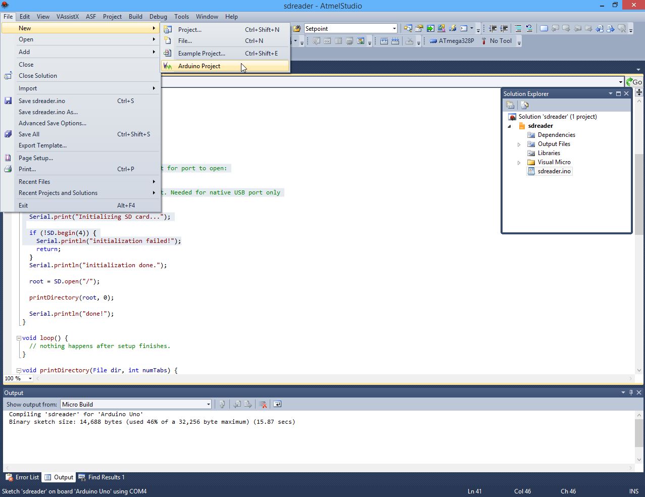

Rite now i am using just basic compiler (i think), but want something with debug & watch features , is this possible? right now all compiler tells me is most basic summary of build error, it does not even mention line numbers...
is there better?
There are several such IDEs out there, but think AVR Studio 7 is probably the most popular.

However make it easy to run the Arduino you need to add and Use the Visual Micro plug in, which is mostly free, but to use its full debugger features you have to pay a small-ish fee . However try it all out first to ensure its the right program for you before buying the full debugger feature.

but i have one problem, I can see the plugin attached to vs2013, and atml studio installed ok too,
i think its working since as far as i can tell it is attaching to the device,
but when i import code problems happen:
1) in Visual Basic --
Error 4 169:13: error: 'HardwareSerial' has not been declared C:\Program Files (x86)\Microsoft Visual Studio 12.0\Common7\IDE\Extensions\evqvbnsz.a10\Micro Platforms\default\debuggers\VM_DBG\VM_DBG.h 169

HEY! still cant get this going! I got the visual Micro in VB and the atmega2560 hooked up on usb
using adruino software I am able to build with the avrISP mkII, but when i try on VB, I get error:
avrdude: usbdev_open(): did not find any USB device "usb"
I selected the right ports and board, is there more settings i am missing, or maybe special hardware is required?
what could i be missing !!??
thanks!
gotit!
all i was missing was that i had to uncheck "always use programmer for upload" !!!!!
