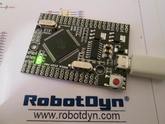

Just an update on the boards I was looking at, decided to go for one of these Far East Mega2560 boards as it was the quicker and more compatible option.
Its just 38x54mm comes with double row header pins and ideal for where space is limited vs the full size ArduinoMega 2560.
A nice feature of this board is that it comes with a decent size AM1117 3v3 regulator as well as 5v, though also available with just a single 5v or 3v3 regulator on a slightly smaller board.
Their site also has full schematics, board layouts and pin out diagrams.
Not the fastest of boards, but my code does not need it.
For £7 or less seem a good buy if you can wait two weeks for delivery.
Two weeks is probably a little optimistic - they usually quote 2-6 weeks for delivery from China.
Yes, they do seem to say that or even longer, but generally find they arrive in two weeks, sometimes just ten days.
Mine , shown above, just arrived today, ordered 31/10 ; its ready to run with bootloader and blink example. :happy:
( should add I ordered it via a seller on ebay uk, not direct from Robotdyn)
