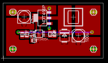

As an FYI, here's the PCB/schem. Note its single sided, with a couple of jumpers on the other side...far form ideal.
Thankyou all for your replies, as always, any more information/reference designs woudl be much appreciated.

Gate charge is probably the key figure you should be looking at. The whole thing is difficult to quantify and the only reliable you can determine switching times in your circuit is with an oscilloscope. So this isn't an exact science but we can guestimate some things.
Q = Current * Time
Conversely:
Time = Q / Current
Your driver datasheet listed .44 amps for sourcing and .32 for sinking. It wasn't for your Vin but ill use it to estimate.
On time = 47nC / 0.44 = 107nS
Off time = 47nC / 0.32 = 147nS
Add you typical rise and fall time of 65ns and 70ns and you end up with about 389ns total switching time per cycle, in the real world its probably going to be longer than that. At 330khz, you have 3300ns total per cycle, so you have about 15% or so consumed by switching time. That might not be conducive to the greatest efficiency but I am surprised it doesn't work, I would think it would so there may be something else going on there. The best way to determine that is to look at your rise and fall times by probing the gate with an oscilloscope.
For kicks though, let's contrast this with a modern transistor. For example, the new TI Nexfet CSD25302Q2. Total gate charge 2.6nC
On time = 2.6nC / 0.44 = 5.9nS
Off time = 2.6nC / 0.32 = 8.2nS
Add tr, 13.2ns and tf, 1.3ns
[B]Total switching time: 28.6ns[/B]
So, as you can see there is quite a dramatic reduction in on/off time possible. Is that going to fix this problem, quite possibly, but I can't be sure. I am guessing you don't have an oscope.

Note the prototype on the PCB *does* hold regulation for 5V up to 480mA, its just the MOSFET and controller IC get stupidly hot (did the crude spit test on both). So it seems again you are correct. Whilst the on/off times are low enough for it to actually function, efficiency suffers.
I have read the applications section of the datasheet about 20 times so far, I gather the frequency is dependant of several factors. In terms of component values the two largest contributors are the inductor, and output capacitor, as well as the 'feed forward' cap. Reference designs from national show the output cap to be anywhere from 1uf (for a constant current LED driver, I'm guessing massive output ripple) to 47uF in parallel with a 22uf. The feed forward cap also ranges from 100p to 1nF. The LED driver designs also all use a 6.8uH inductor, and run at ridiculous frequencies - can I assume that the high frequency/low inductor value is purely because the output is used to directly drive and LED? and as such, output ripple isn't an issue for that application?
My output cap is a low ESR 100uF 16V electrolytic. The ESR of which is claimed (by a dodgy datasheet) to be 2.66 ohms. I thought this was high enough as to not require a series resistor for correct hysteric operation. But perhaps the value of 100u is too high for use with a 22uH inductor? I'm afraid I was assuming that the value simply determined output ripple (rather than be a part of the hysteric operation as in this case).
Anyways, I guess the proof of the pudding is in the eating - time to pick up a few decent PFET's with low gate charge and on/off times. Once that is sorted, and keeping my 22uH inductor, I can experiment with output caps. I think I will also use an external resistor for current limiting (got some 0.1R 1% 1206's somewhere) rather than rely on the MOSFET's varying on resistance. Once its functional, and running cool, then comes reducing board space. I and *hoping* to get this on the backside of a single sided development board PCB. Perhaps even with a LDO (with a 0.8v dropout) after the converter to reduce noise. For trouble shooting, I'll add a bypass switch to the buck, so one can use the LDO 'as is', just in case noise form the converter proves to be an issue for my microcontrollers analogue measurements (doubtful).
I realise my posts are long, and possibly boring lol but I shall report back results when parts arrive.
Thanks again cafe, good to have you in the forum!
Blueteeth.
Ps. I *do* have a scope, but its an old analogue one, which weighs more than I do, and is in storage - a last resort for debugging
OK, well that makes sense, at 5V the mosfet would have a longer duty cycle than at 3.3V. That's the percentage of time it is in the ON state. So perhaps at 3.3, the on state is very short and the mosfet isn't fast enough.
As for your cap, that is probably the rest of the problem. They are basing their charts on a 80 millohm capaciter. 2.66 ohms is atrocious. That ESR is going to cause your converter to run at a much higher frequency. I do strongly recommend you fix the Mosfet issue but you may be able to get it working right now by substituting a low ESR cap.
The converter runs up to 1Mhz, the higher the frequency, the lower the inductance and capacitance required. This is why these DC-DC converters keep getting smaller; advancements in mosfets are allowing higher frequencies. If you ever wondered how you motherboard can deliver 100 Amps to your power hungry Core 2 Quad with those tiny caps, they use what is called a multiphase buck regulator. It's multiple bucks timed in sequence, so that one switches after the other (none switch simultaneously). The waveforms combine at the output before the capacitor. This simulates very high frequencies and allows the use of small capacitors. To address your question, at 1Mhz and 1Amp, you could design the converter for less than 10% ripple with a 1uF cap.
I don't know if the LDO is necessary. Unlike, standard linear regulator they aren't really famous for stability anyway. My recommendation to further reduce ripple is to use a secondary output filter. After the 100uF cap, use a 1uH inductor, leading to a 10uF-22uF low ESR cap, ceramic perhaps. You can't use ceramic on the primary cap though, unless as you stated, you use a series resistor, one of those .1s should be good if you go that route. There is absolutely no reason to think you won't have stable power for your micro. The micro will probably be the noise maker in fact. Sharp turn on times and high frequencies do enable currents to pass all around your board and in between traces, so keep that in mind I guess when setting the frequency and picking the FET. As for the space issue, 500ma is not a lot, If you really wanted to, you could quite easily fit a 500ma switching converter in 1 square inch. Ill post a pic, this is a boost converter for a pressure sensor I designed. It is only good for 100ma, but you get the idea.
