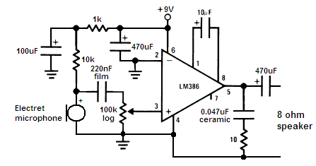

The Electret mics do not work on any circuits. I removed the mic replaced it with a 8 ohm to 2000 ohm transformer and an 8 ohm speaker. It works but it oscillates, probably because the 2 speakers are only 12" apart.
An electret mic has a positive terminal that is powered from a series resistor (try 10k ohms) from a filtered positive voltage and the metal case terminal should be connected to 0V. It has a DC voltage on its positive terminal so it needs a coupling capacitor to the input of a preamp. The LM386 is a power amp, not a preamp when there is a 10uF capacitor between its pins 1 and 8 then it should produce some mic sounds or feedback sounds.
Your 15V supply will cause an LM386 to overheat, use 6V or 9V instead. The 50uF output capacitor value is too small since it passes only high audio frequencies above 400Hz, no bass sounds. use 470uF (43Hz) or 1000uF (20Hz) instead.

The circuit shows 15 volts but I am using a 9 volt battery.
I probably had the mic connected wrong I did not know it has a + and - polarity.
For my application the 50uf cap might work better at about 100uf I need this amp to read Hz of a running engine. The engines I need to test run about 200 Hz to 400 Hz. I can do the math and get in the ball part but I need to know the real run frequency of the engine. The output of this amp will go to my meter I hope it can read frequency from the amp if the mic can pick up the 120 db sound of the engine pulses.
I will try the mic again across the 10 resistor. I can move the volume control between pin 1 and 8 with the capacitor.
An electret mic might not work if it has a 10k volume control directly in parallel. The mic must be powered (it has a junction field effect transistor inside) from a series 10k resistor from a filtered voltage (I show a 1k resistor and a 47uF capacitor as a filter) then it must use a coupling capacitor to the volume control that can be parallel with pin 3 of the LM386 amplifier.
The 1.2k rheostat between the capacitor in series with pin 8 and pin 1 adjusts the gain from 20 to 50 times which is just a small change of level.

The mic has no polarity so I used my meter to ohm it out. I have it connected the correct way now. I changed the 50 uf to 250 uf the amp has a self oscillation problem. There is no resistor in series with the cap on pin 1 and 8.

Audio feedback will not occur when a speaker is not connected to the output of the amplifier. Use your 50uF output capacitor to feed a 100 ohm resistor instead and connect your frequency meter to the resistor.

This is the tested and proven circuit.
After learning the Electret Mic has a polarity and getting it wired correctly with the 10k, 1k and 100uf cap it works. I am surprised this little Electret mic it has a good sound and good pickup.
Sound quality is very bad lots of distorted.
I removed the capacitor between pin 1 and pin 8 that made a very big inprovement in sound quality gain drops to 20. Volume control in series with cap was not very much improvement and different size caps are no help either.
The 10k variable resistor is useless, turn it just a little and there is no sound at all. So I replaced the variable resistor with a fixed resistor. I should have experemented with a 20k, 50k and 100k variable resistor.
The 10k resistor needs to be connected directly to pin 3 with no capacitor between pin 3 and the resistor.
The .1uf cap between pin 3 and the mic works perfect, I experemented with several other caps .1uf works best.
I experemented with the 100 uf cap at the ear phone, I changed it from 50 uf, 100 uf, 350 uf, 470 uf all this does is make the signal have lower Hz base sound and no effect of the bad quality sound.
30 years ago I use to know what the bypass capacitor on pin 7 is for but I can no longer remember and don't remember where too look it up. I removed the .05uf cap and sound quality appeared to be worse so I tried several caps even a 10uf then finally went with a .1uf cap.
After several parts swapping experements sound quality is 100% better. Sound is best with a brand new 9v battery.
EVERY electronic circuit needs a capacitor across the power supply. Yours is missing so the supply voltage is bouncing up and down with the output signal of the amplifier and it gets amplified and might even cause the amplifier to oscillate at a very high inaudible frequency that causes distortion. Use 100uF.
You removed the capacitor between pin 1 and pin 8 so the gain of the amplifier is very low (20 times) for a microphone input. Then the sound level must be VERY loud for the output level to be strong and then the mic might be overloaded.
If the output level is too high then the amplifier clips it causing severe distortion that happens with ANY amplifier. A brand new battery voltage is high so the maximum output level before clipping is also high.
The datasheet for the LM386 shows a 10uF capacitor from pin 7 to 0V.
Very good information. I need to get use to checking data sheets online. I keep trying to find information in old books. I changed the bypass cap on pin 7 to 10 uf. I added a 100 uf cap in parallel with the battery. Sound quality is very good and loud enough to amplify a pulse jet engine.
