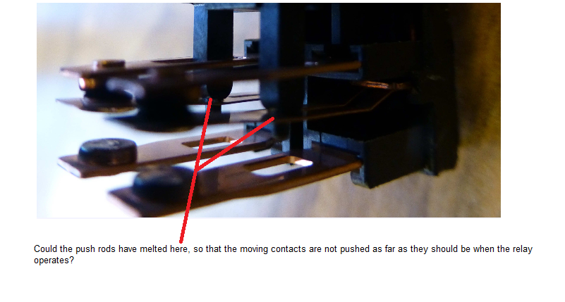

I was just doing a rush job for my son and it involved turning on two appliances after a delay. I knocked together a 555 circuit, well a pair of them actually and tagged on a suitable supply.
All seemed well and the LEDs I fitted on the timers were coming on as expected and all was behaving well. Next I went back to my parts box and grabbed two suitably large (12A 277vac) eight pin relays, similar to the type I have used many times before and hooked them up to the timers. Before doing that I had tested the pins and discovered the normally closed contacts so I could use the other ones which must be N/O.
Get it all connected on the board and whoopee! The on LEDs light as they should and there is that lovely click of a relay with each one. Success!
Nope! Nothing across the N/O contacts at all (I have both sides commoned for the sake of better contact life) so I think I must be going strange(r) and I got the wrong pair hooked up. Ok no big deal and I test again but this time with power to the relays and I got a surprise, nothing between what I assumed must be the N/O contacts and the commons energised or not. There is no connection at all between any other pins and the ones I had used.
After giving up on them and swapping them for a different type (only six pins on these) which are normally open and the project worked out ok I decided to open one of the strange relays. this was a bit difficult as they are the glued on type but I got in with no internal damage to the relays or losing any finger skin.
The contacts were there! The only thing is that the common sections contacts could not reach them! After a bit of bending of the N/O contacts I can now use all the pins as I first expected. Can anyone understand the reasoning involved in making a relay with the contacts available but not allowing them to be used? I can't work out why they would design such a device.
Well I hope someone enjoyed this tale and can take snaps of the relays if anyone is interested, let me know. thanks for reading this.
All the best, Al
Perhaps they were rejects that found there way onto the grey market, did you buy them from Ebay far east ? many fakes and rejects there!
Curious.
A picture would be good to look at if you can take one.
Hi Guys, Pics as promised, please excuse the double one. It just happened! :oops:
Al
BTW I cant say where they came from, they could have been in my box for years from new or even pulled from something in the past.

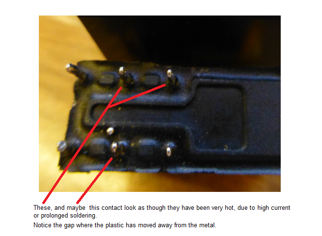

My wild guess, in pictures.
Hi Jim, High temperatures caused by me rushing to get the buggers off! hehe

Those relays were probably used before and overheated by unsoldering from the board.
The plastic support has melted a little bit and contacts shifted out of alignment.
Or overloaded, and heat from the current flowing through the contacts caused the plastic to melt.
Those pins are tiny to carry 12 Amps, especially if they were not soldered in properly.
Maybe they were some kind of force guided contact relays, even so they should still work.
