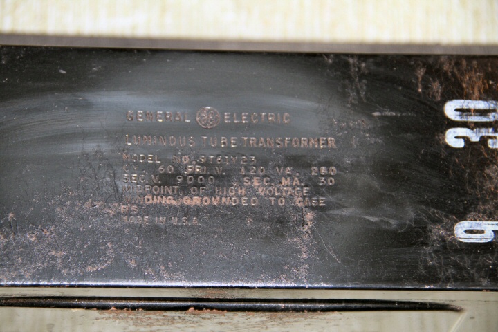

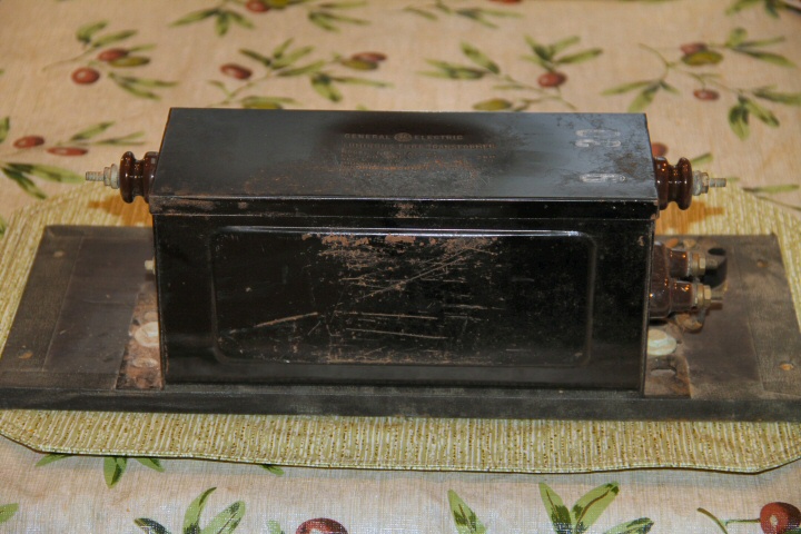

Something I am unsure of is the newer neon sign transformers that are solid state. Not sure those will work well but never tried. I still have an old 9 KV 30 mA transformer lying around here. The original was 15 KV 30 mA. That thing got with it! :)
Ron
I have heard that these don't work very well, as the output is at a higher frequency than mains. I read that it is very difficult to get them to work.
I have a couple of NSTs similar to the ones in your photos, and I also remembered that I have a 7kV, 30mA transformer, as well.

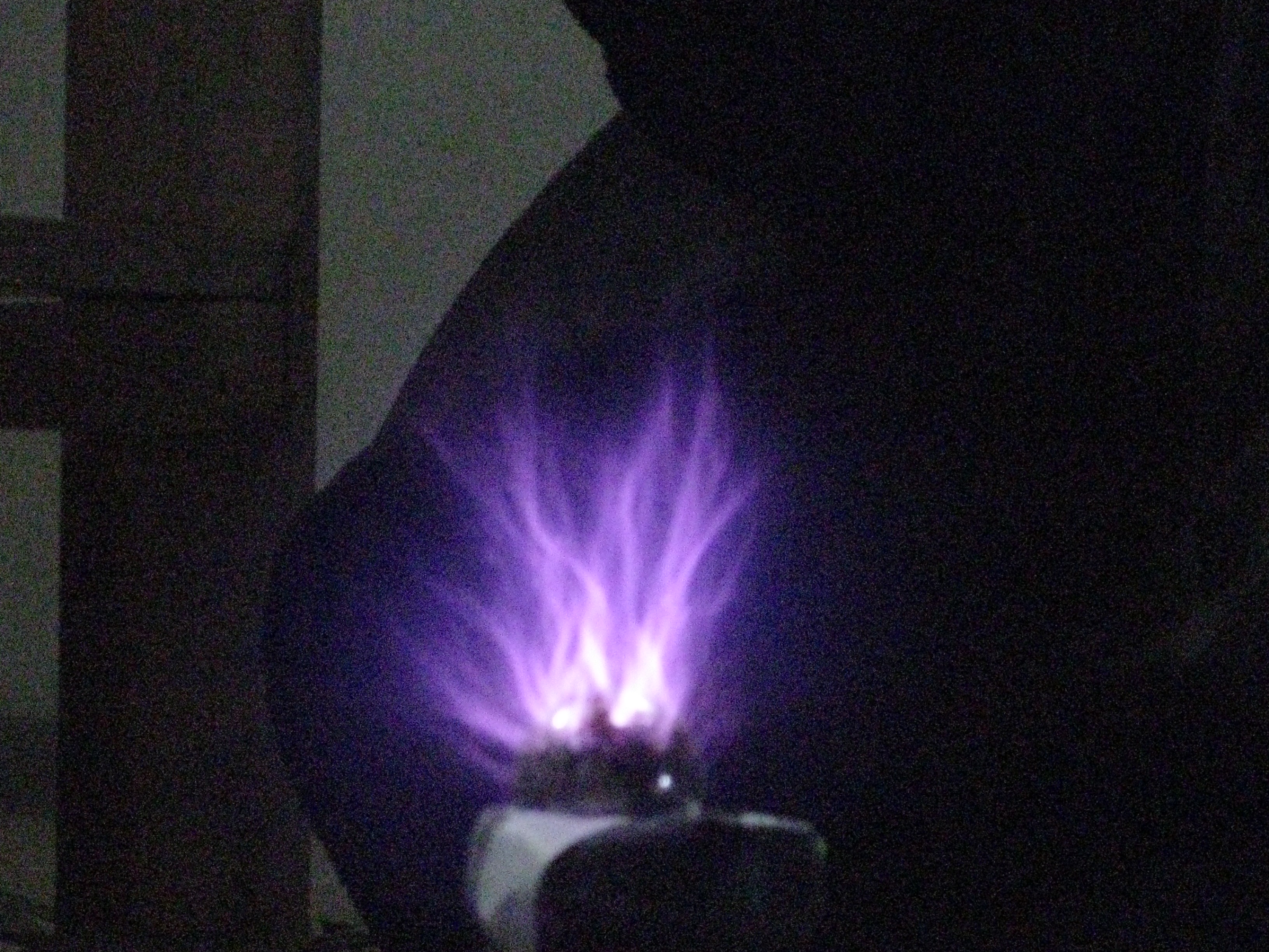

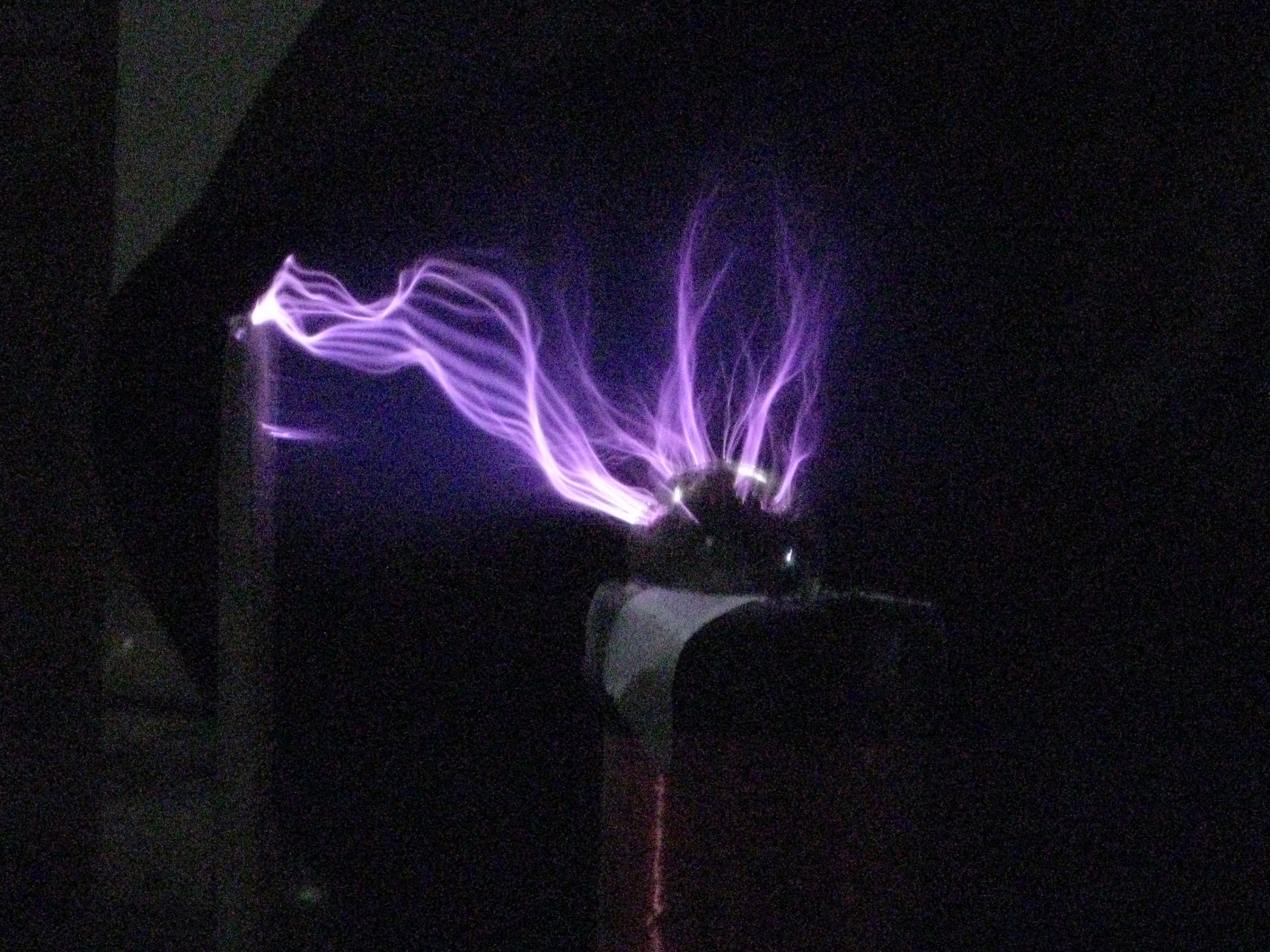

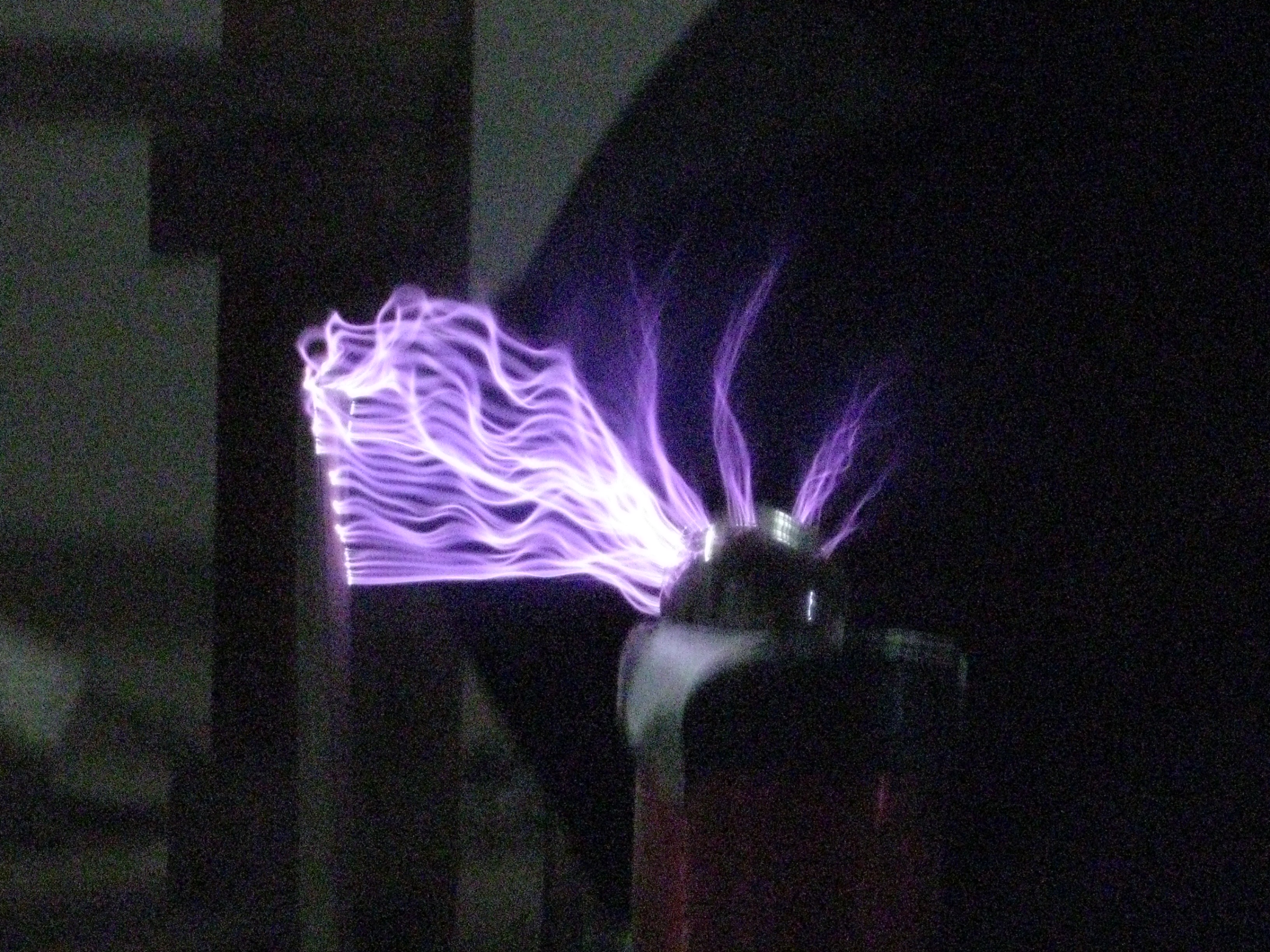

My first real tesla coil was about 10cm. tall and ran with a single beer bottle capacitor and my 9kV NST. Yeah, I know it was overkill, but it worked! I got a good 9-10cm arc from the topload. Here are a few photos:
This was actually my best tesla coil until I tried mounting the primary. For these photos, it was just 12 AWG copper wire coiled up in a cone, sitting on a few bottle caps. When I tried to mount it to a piece of wood, it changed the coupling and it didn't work very well, if at all. :( Then my cat knocked over my capacitor (which I spent a long time on to get everything right) and spilled it all over my workshop floor. I have just had the worst luck with this coil! :mad:
Damn cat! Maybe when you mounted your secondary, you changed the resonate frequency. That always needs to be checked.
That is probably true. I mentioned coupling because the shape of my primary changed when I mounted it. I found a "Tesla Coil Tuner" from RMCybernetics that I have been meaning to try, as well.
