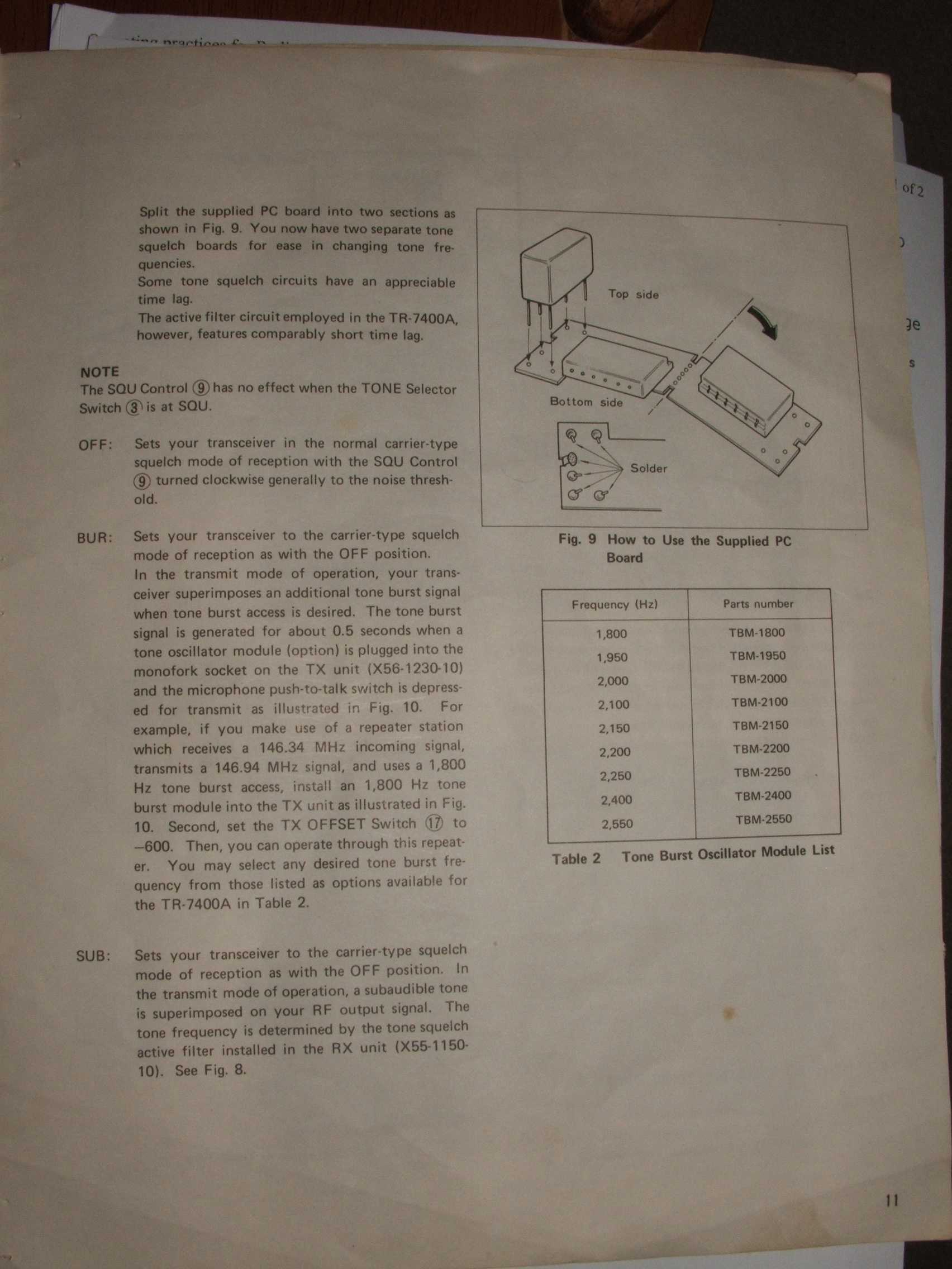

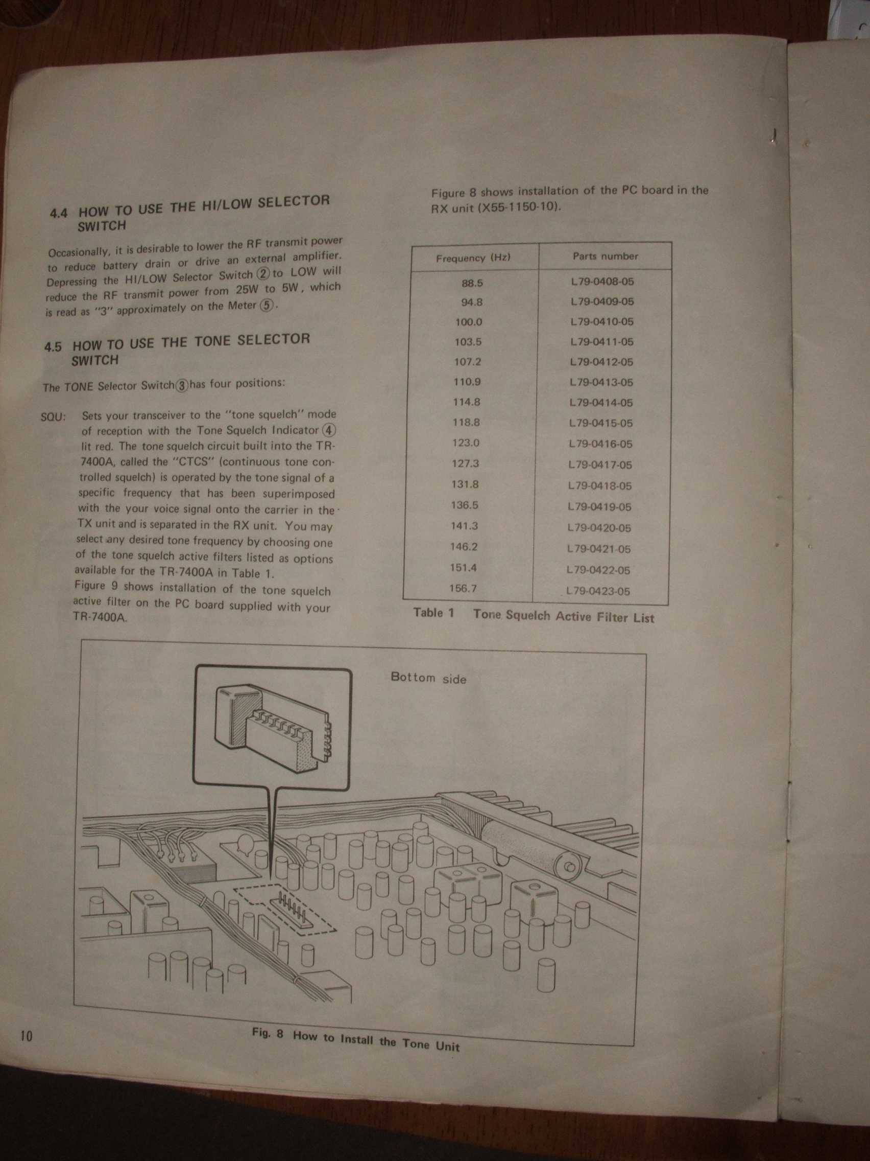

It was an option. It talks about 2 different moduals in the manual, that were avalible in a bunch of freqs. I'll try and remember to post that page of the manual tonight when i get home.

Have you seen any scematics or anything online for doing this? I thought it would be pretty common, but I haven't dug up much yet. I'm willing to invest in a frequency counter, so thats not a problem.
I don't know if it helps any, but here are the 2 pages that talk about the tone in the TR-7400 manual. Kinda hard to read, but easier then me trying to expalin it:D
Here is the local radio club site with the repeater info. https://www.marcmvra.net/
one repeater says 100 Hz and the backup says 136.5Hz. They have been using the backup the last few nets.
Bottom line is I need somone to help me understand what I need to do with the TR-7400 to access these. What mode should it even be in? The 4 modes are described in the manual pages I posted.

I think you need to transmit with a sub-audible tone with your transmit audio in order to cause the repeater to work. This tone is sent for the entire time that you have keyed your radio. Sub-audible follows a standard called CTCSS and some companies made up their own names, like Motorola made up the name PL or Private Line, they are all the same thing. The club says you need to send 100 Hz CTCSS tone when you transmit to the repeater. Don't worry about how that sounds at the other end, because any receiver designed to accept CTCSS tones also includes a filter to take the tone out of the received audio so that nobody hears it.
In your radio you need a CTCSS tone board that can generate the 100 Hz. The manual mentions the original option board having a SUB mode, and this would be the correct mode to choose. Unfortunately, that old option board only allows one tone to be used which is no longer viable. You need to be able to select different tones for different repeaters, so it would be better to fit a more up to date tone board into your radio. There are some popular suppliers that make boards to fit your radio. Here is one link that I just found:
https://www.electro-tech-online.com/custompdfs/2008/01/tr7400a.pdf
this company is Communications Specialists www.com-spec.com and is mentioned a lot in ham conversations about adding tone boards.
Thanks Ron! I'm glad to know there is a ready made option. Not even that bad of a price (around 30 bucks).
