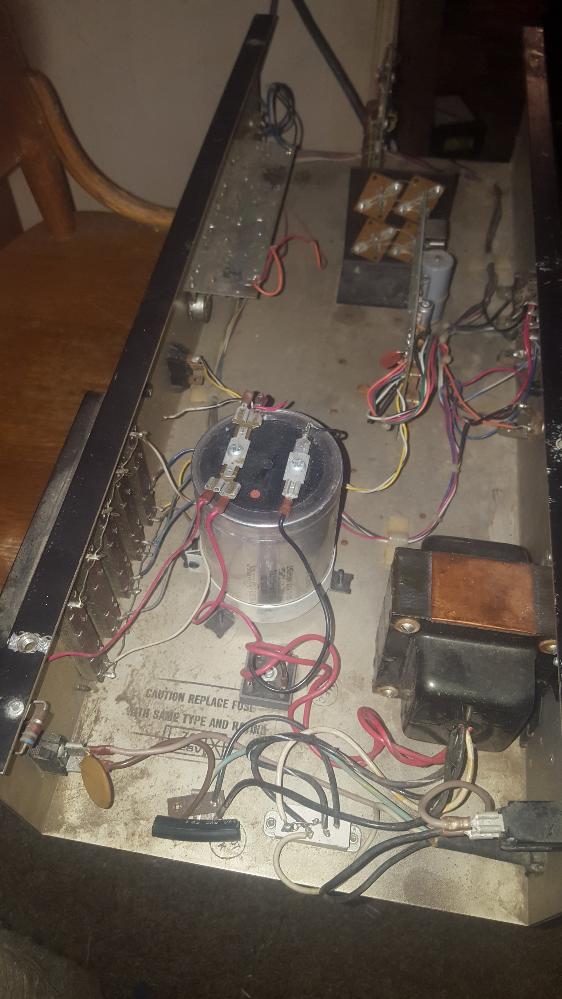

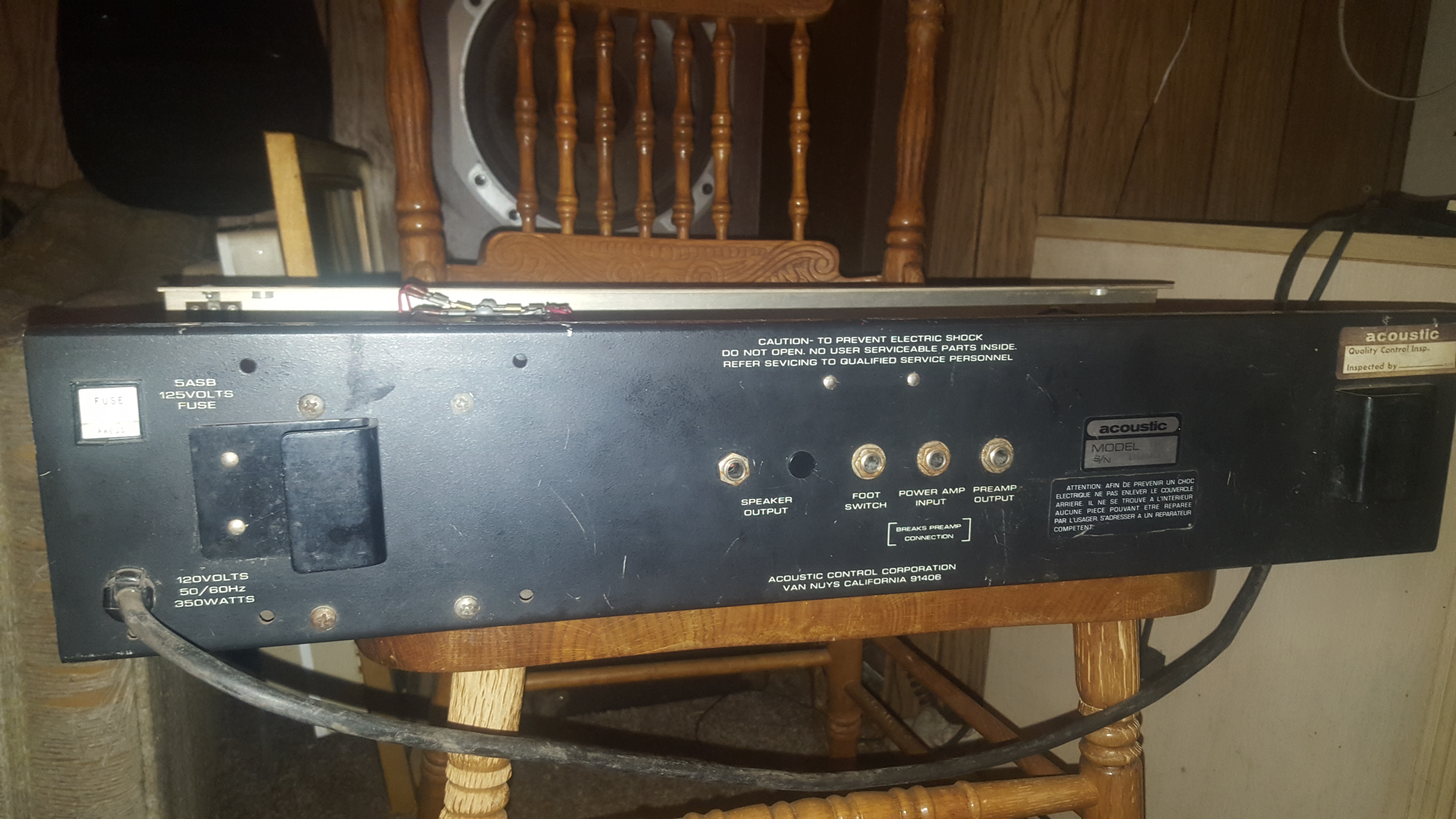

Ok, this is a long one. Antiques are my side hobby. A buddy recently gave me this amp that causes my hobby ven diagram to have overlapping areas.
It is clearly old. It had obviously spent some time outside. It had leaves and sand in it but still pumps alot of noise. I need help figuring out its proper usage and fixing the issues, if yall wouldn't mind. I know I should hit up a musical forum for this, but I trust yall more and I wanna run it by you 1st.
AudioGuru, I know you got this.

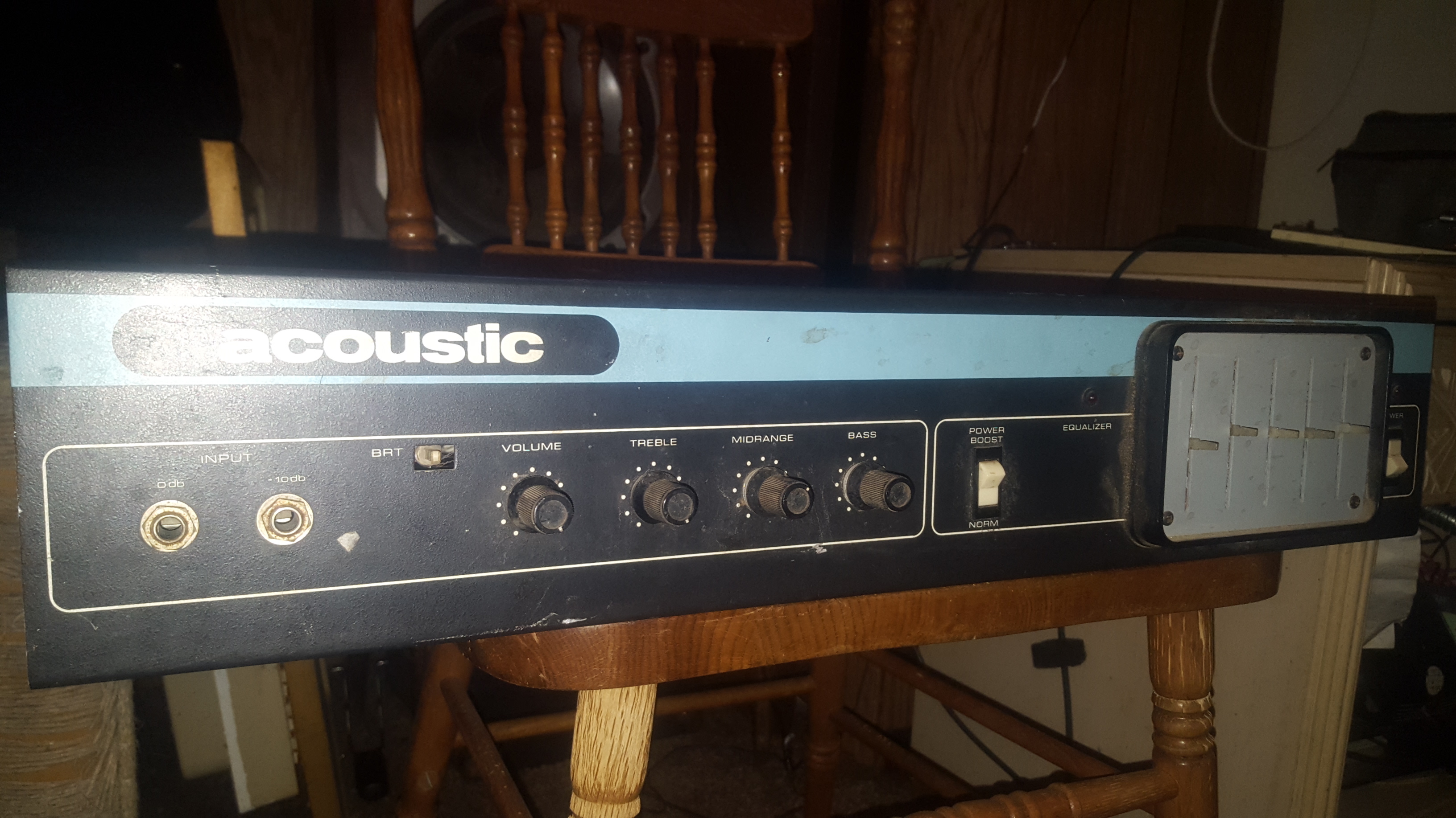

1st, is this a regular amp? Or is this just an equalizer and I need to plug an amp into it? Notice it has regular and -10db inputs on the front, "power amp input" and "pre-amp output" on the back. I can plug my phone or PC sound output into either of those back ports and I get great sound, just the volume knobs and equalizer on the front does not affect it.
When I plug into the front, I have volume and equilizer control. That "BRT" button on the front doesn't seem to do anything. Plugging straight into the front without power amp yields low quality sound and low volume. Plugging into the back via "pre amp output" or "power amp input" yields great sound and volume. It seems odd to me that pre amp output works as an input...

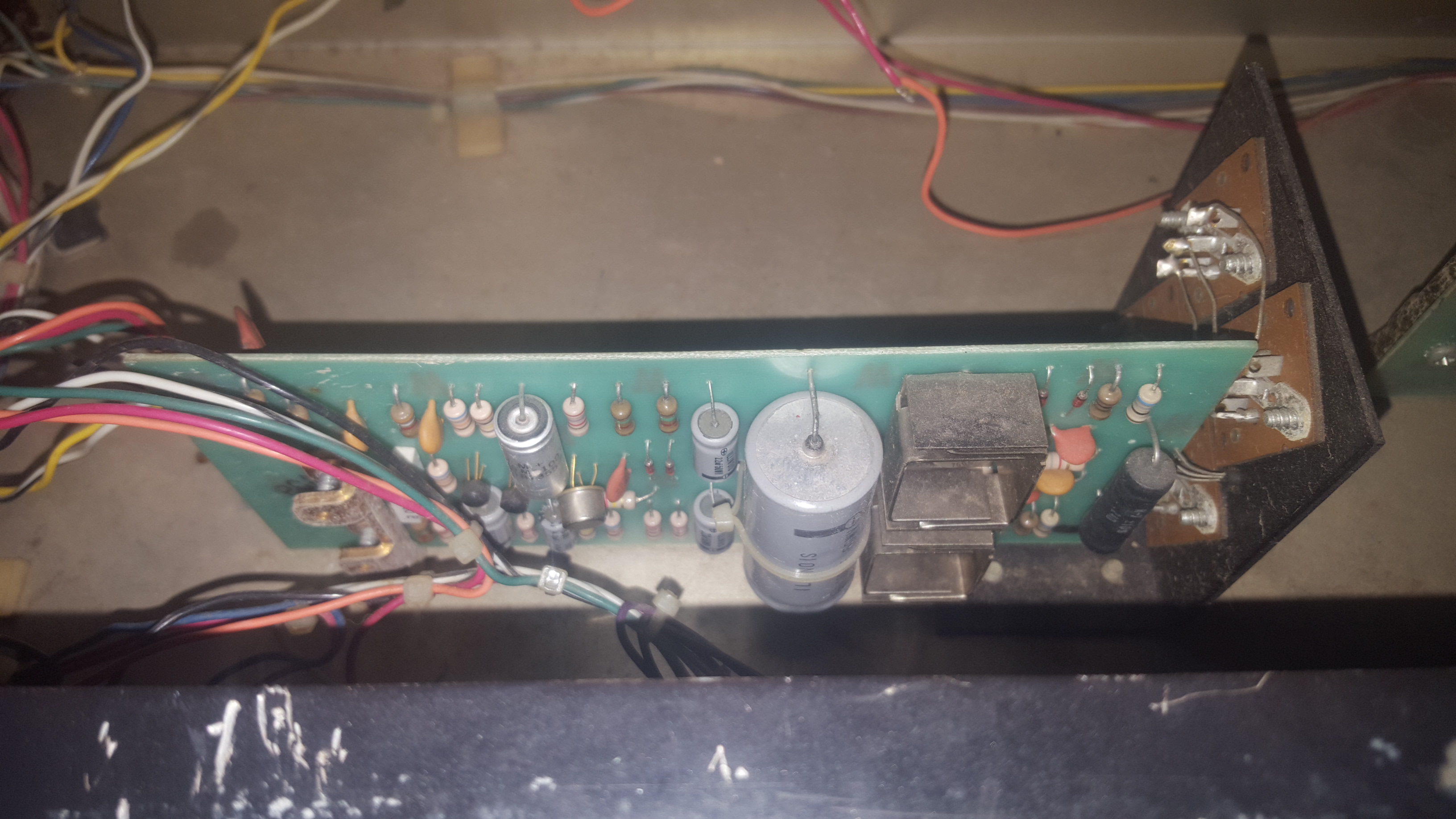

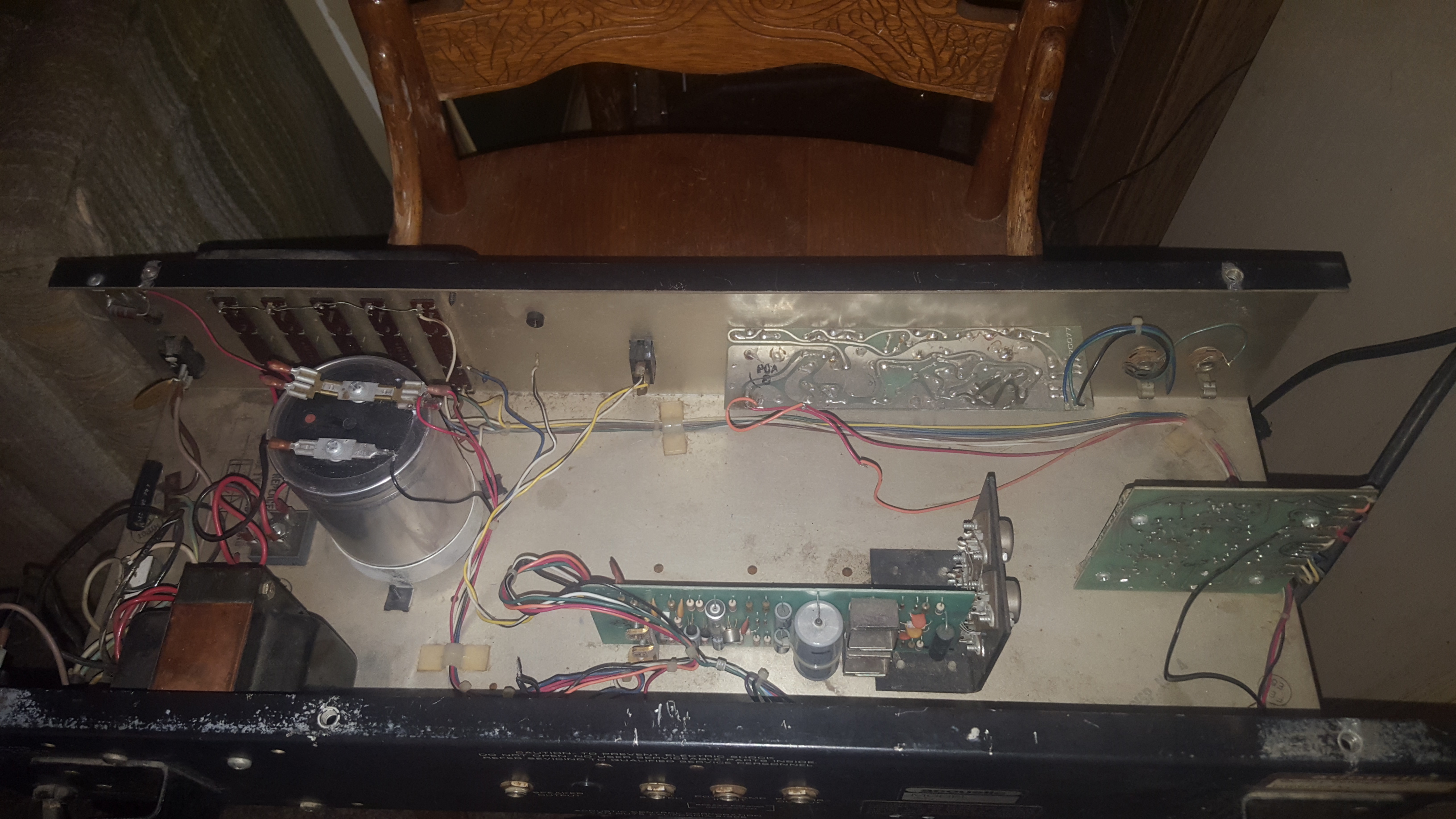

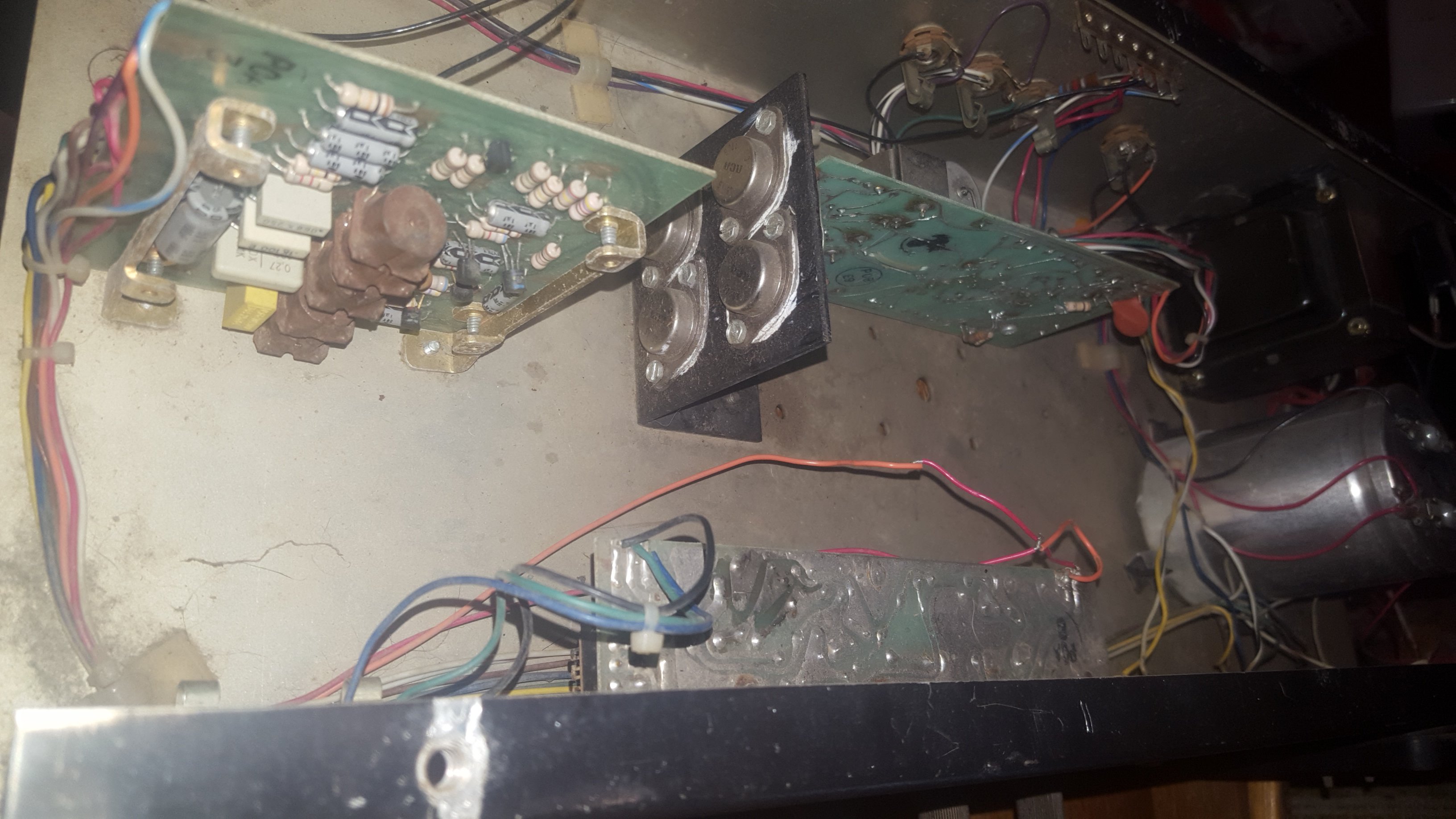

Anyways here's the issue the amp has: After about 15-30 minutes of music (using front or back as input), the sound slowly turns into static until all you hear is static. I feel like that huge monster cap (7800 uF, 100VDC) is bad since it slowly dies out. Then when I can no longer hear music, I turn off the amp and for a few seconds until power runs out, the sound quality is loud and good again, then the amp powers off.
So how can I fix this badboy? Not sure I have that same monster cap, but I'll buy one if need be. This is a killer amp. Enclosed, you will find tons of pictures and a youtube vid showing various angles incase you need it. If you need more angles, lemme know. Yalls help keeps me looking like a god to the yokels around my neighborhood!

for guitars, not a PA... as far as amps go, it's antique... sorry, yea, the model is 126. Found a bunch of info once I had that lol

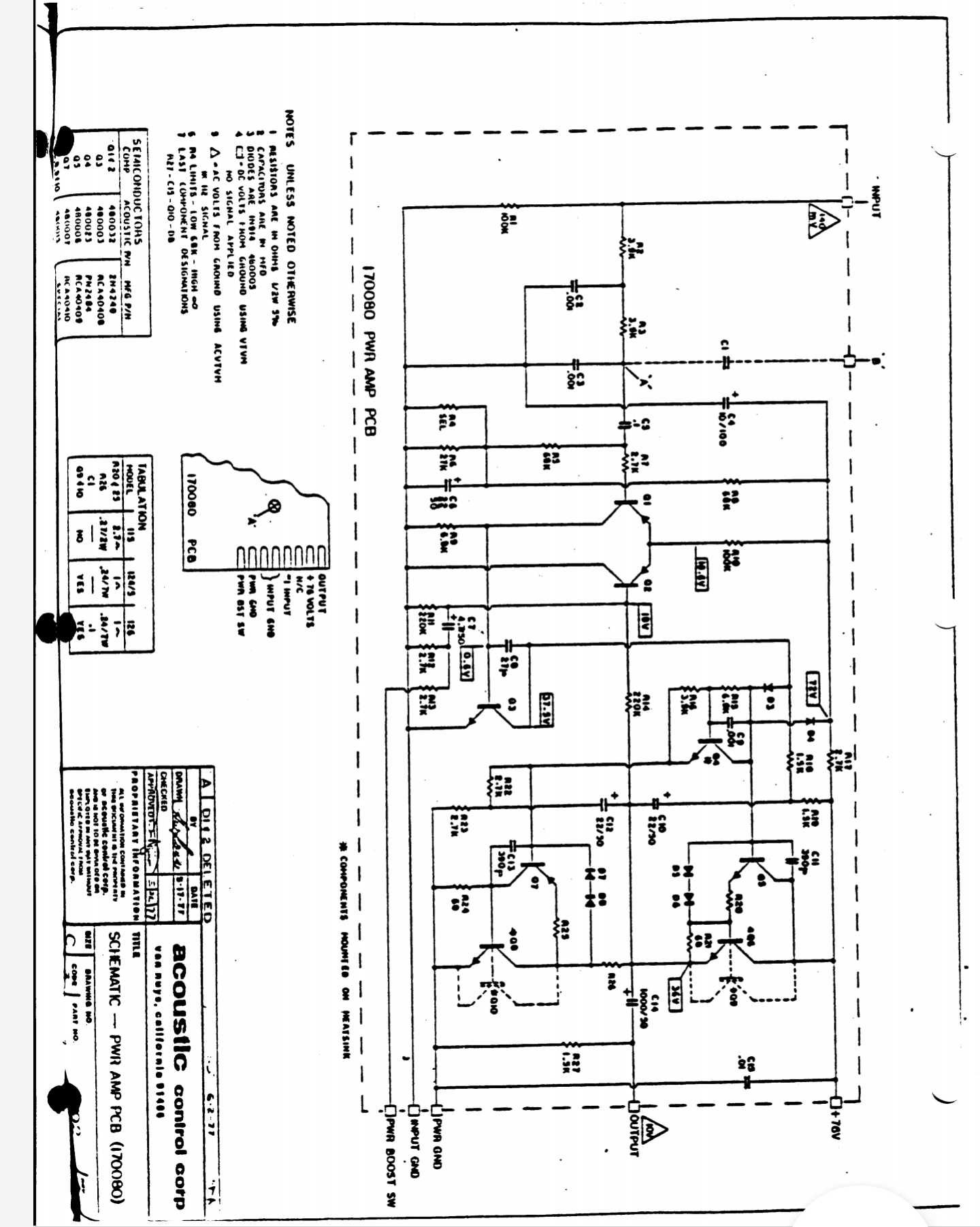

  • Acoustic 170080 Power Amp (Rev.A) Schematic.pdf

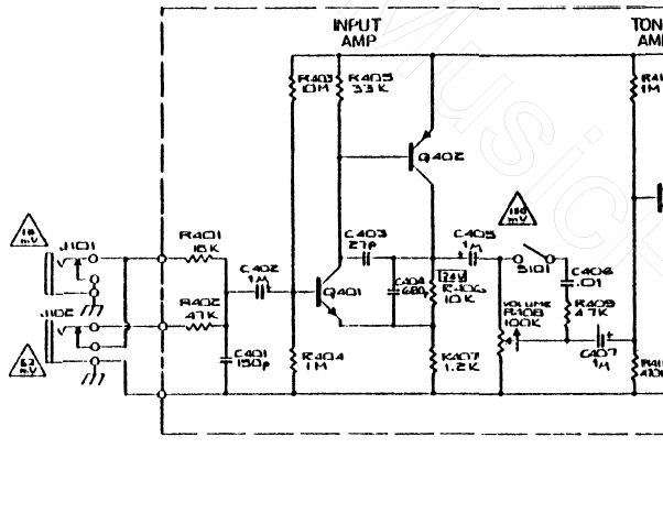

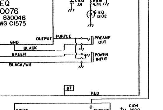

The mystery of why you can plug in to either the pre-out or power-in can be seen here in the 220 manual.
The normal and -10 dB inputs can be seen here with different series resistors on the input:
The 'BRT' switch is probably "Brightness", as it looks like a high boost (S101).
As for the fade to static, if the large filter cap was bad, you would likely gt a blown fuse. If the issue exists when you are feeding the signal into the power amp-in jack, then the probem lies in the power amp.

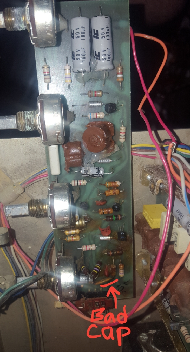

Yeah, I actually found more than a few bad capacitors. Capacitors, that is, that do not increase in resistance to Infinity. Many of them have a set resistance and do not move.
Okay, guys, here's what I got.

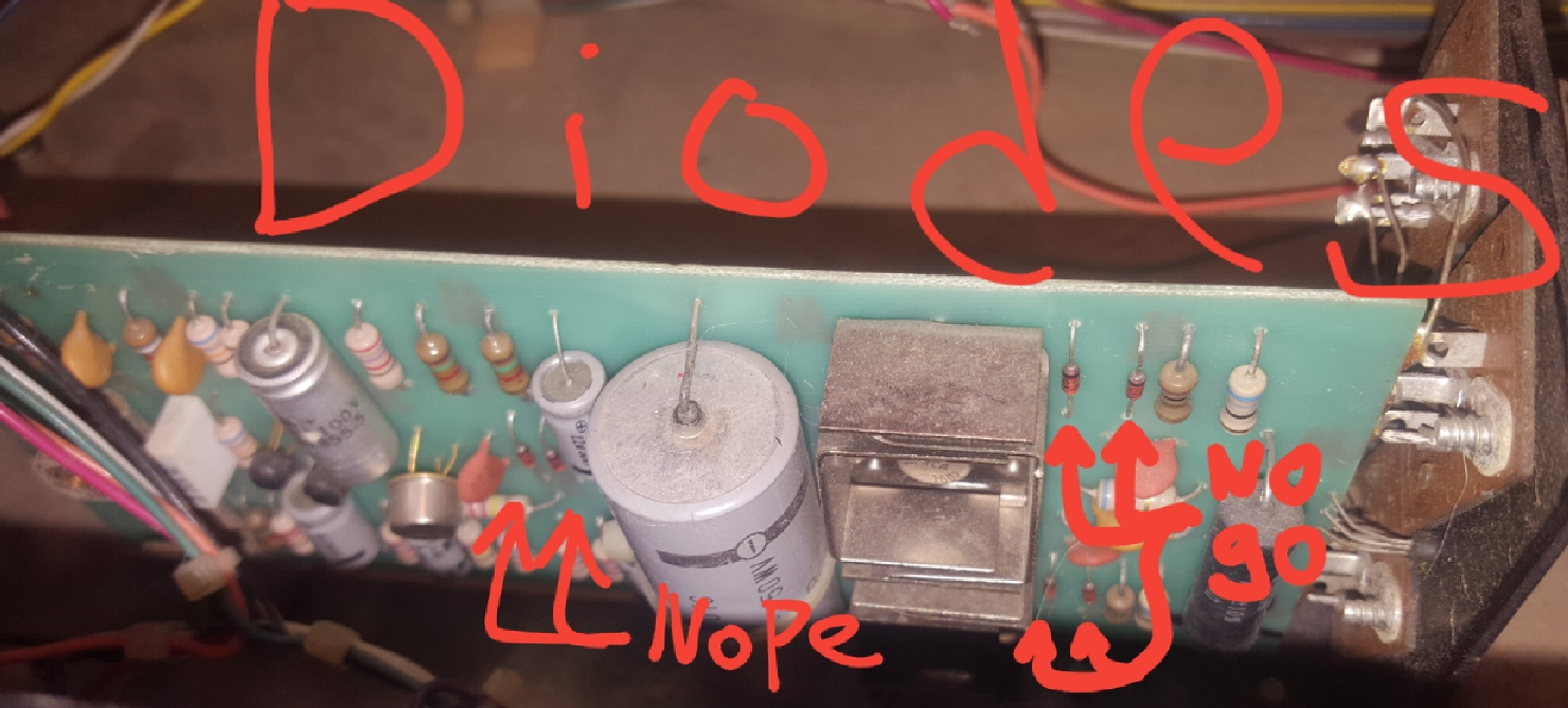

Every diode on this board allowed electricity to flow in either direction. Can I replace these with similar glass ones? , or do they have to be the exact diode?
Three capacitors were bad on this board. I recently figured out that those items are inductors And that I really don't want them to go bad because they are almost impossible to replace.

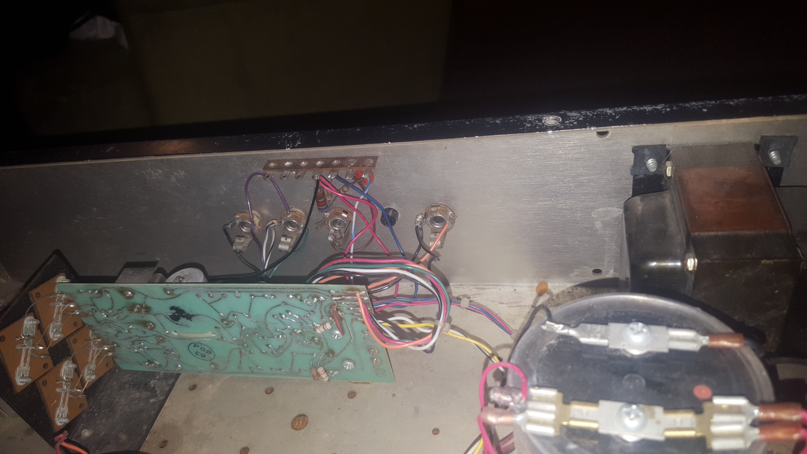

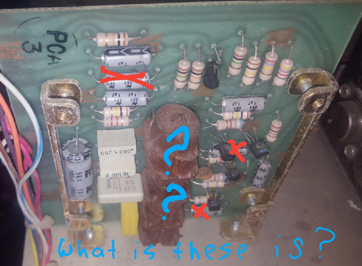

Now That's what I call a sticky situation! on the underside of this board, it was a real gooey mess. I assume that's grease? I only found one bed capacitor here. Although there's some other items Here that I cannot identify And so I cannot test their functionality.
I'm about to replace The capacitors and diodes, unless anyone warns me not to. We'll see what we got afterwards.

No need to replace the diodes, they won't be faulty - you can't test them in circuit - you're more likely to cause damage than help anything.
Likewise the capacitors, you can't test them in circuit - so you've no idea if they are faulty or not (although capacitors DO age, and only have a finite life span).
The inductors are part of the tone controls, leave them alone, they don't go faulty (unless messed with!) and as you say would all but be impossible to replace.
The 'goo' is most likely glue used to hold components in place (to help prevent dry joints etc.), however various types of glue used over the years have begun to conduct and can cause troubles.
Really, instead of randomly trying to check components (which you're not even doing properly in-circuit) you need to fault find. First job, find out WHERE the issue is - if it's preamp or power amp, then you only have one section to deal with. You've got sockets for power amp in, and preamp out, so it's easy to check - but also be aware that one of the sockets (probably power amp in) will most likely have switch contacts on it, and these often give trouble and require cleaning.
I suggest that is a seriously bad idea.
I guess that you have just measured these components while they are mounted on the board, in circuit.
In which case you will see the effects of other components which are connected to the one you are trying to measure.

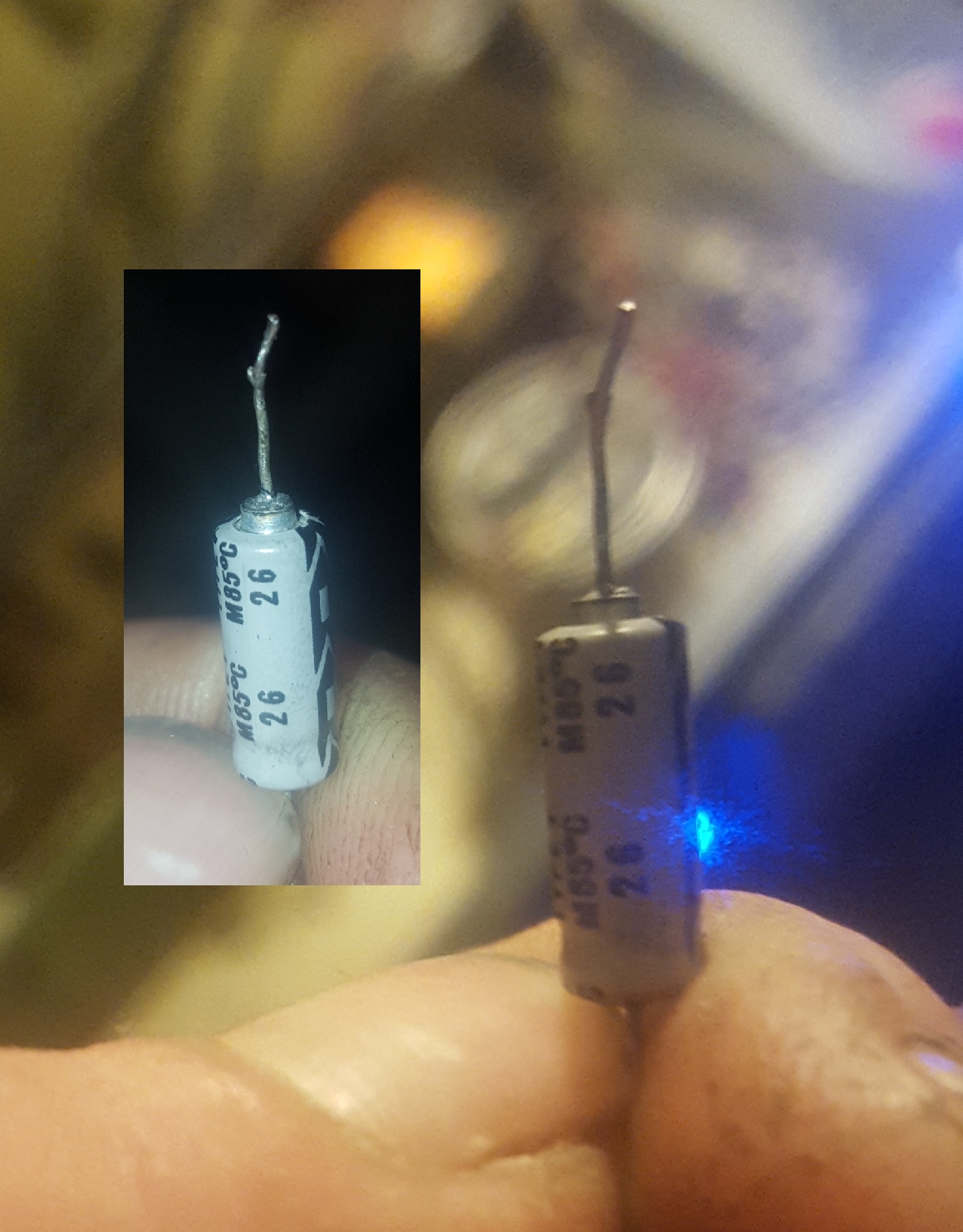

Look at this old cap I replaced
Look, it's prolapsed. See how that section is poking out from the middle? Is this just how they were made back then?
All the 1uF caps are like this.

There's nothing visually wrong with that, to actually check it you really need an ESR meter, although for the purposes of this amp a capacitor meter and checking for leakage with a multi-meter are probably enough.
As electrolytic capacitors fail with age, it's common to replace them all - but NOT as a random event.
But you still need to locate where the fault is - as I've already said, the preamp out and power amp in sockets make this easy. Feed something else into the power amp in socket (CD player?, something like that) and see if it continues working using just the power amp. Or, take the preamp out to another power amplifier (such as your HiFi) and see if the preamp works without failing. In that way you can determine which part is at fault - it's called the 'half split method', you don't do repairs by randomly removing and replacing components.

I believe you are dealing with two issues. Earlier you indicated that with the audio source driving the "power-in" jack, that the output eventually faded to static. That would be an issue with the power am. An addition issue seems to be low gain of the preamp/tone control sections. These issue need to be dealt with separately.
If it were me, I'd look at the power amp first. And the first thing I would do is to confirm that the +76 volts (as shown on the schematic) was there and remained there as the output faded to static.
