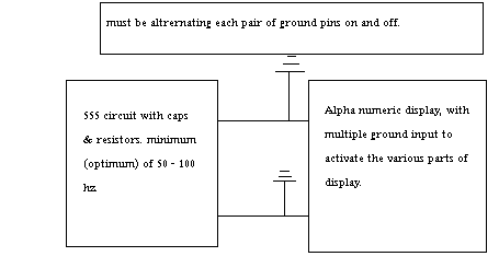

Any ideas on how I can be alternating the ground on/off between the various ground pins of the display so it would appear as it is always on? I think there was a way to do that with a 555 or a 556. That display is a 2 digit alphanumeric display, with each digit cut in half.
As for a microcontroller, I had only looked at the PIC series, but I don't have any of of the programming software and hardware, neither do I know programming, so I see that as a much harder option for me, since i don't want to copy 100% some one elses, but I want to do some of my own thing too. :-( besides, I wanted to be a little 'retro' I guess. I think of it as learning the building blocks before venturing out to the deep.

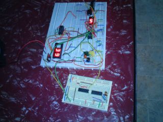

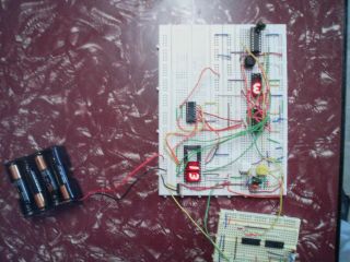

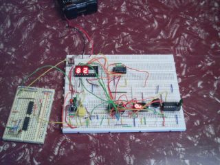

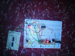

Anyway, I took a few pictures just earlier, when it was counting from 00-99 and then a short video after I added a 74ls08 AND gate to be resetting once it was reaching 60, actually only when it reaches 6 on the second '192. I am so proud of my self. I have about 30 minutes a week.
You can find further details in my blog over here:
Various writings, mumblings and dialogs.
It contains my thoughts about the circuit and how it is progressing.
So, for those that are interested, here are the pictures:
