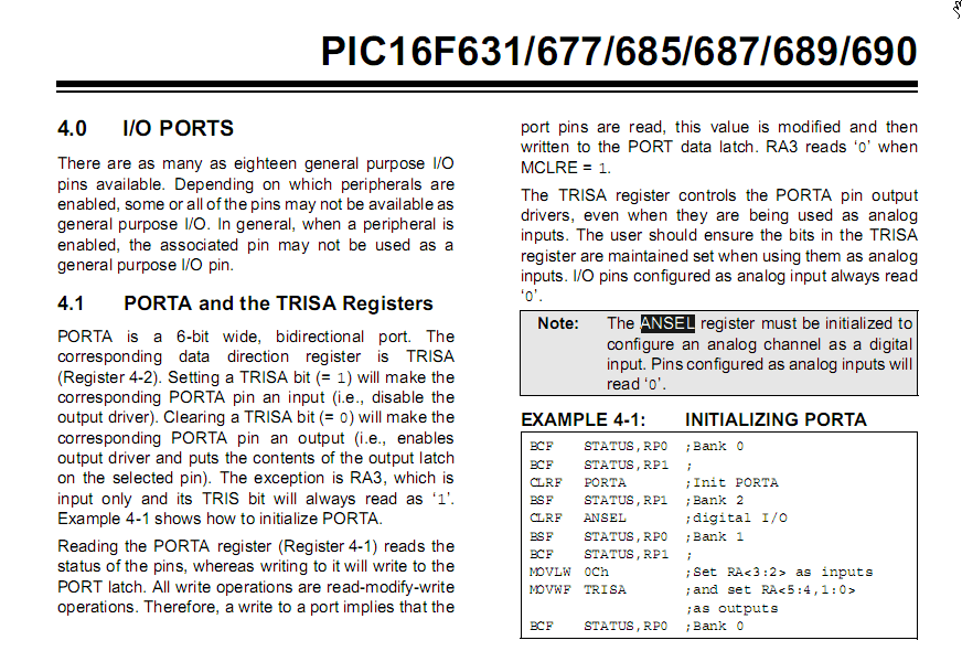

How do I disconnect the ADC and comparators using assembly language for the 16F690?
Look at this image, note the code section.
