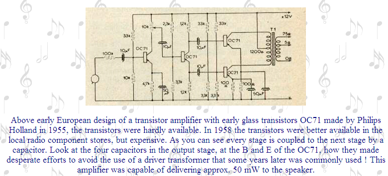

A common emitter transistor makes the same type of even harmonics distortion (it sounds musical to some people) as an old common cathode vacuum tube (valve) circuit. Half of a waveform is compressed.
Push-pull outputs compress both halves of a waveform equally so the even harmonics cancel and are converted into odd harmonics that sound unmusical.
Old vacuum tube amplifiers need an output transformer to convert the high output impedance of vacuum tubes to a low impedance to drive a low impedance speaker but since the output transformer cuts highs and lows and doing so produces phase shifts then not much negative feedback (or no negative feedback) could be used to cancel distortion. But modern solid state amplifiers have a very wide frequency range without phase shift then an output transformer is not needed so they have LOTS of negative feedback and extremely low distortion.
My first portable radio (1957 I think) had germanium transistors, an output transformer and no negative feedback. Since it was AM with a muffled frequency response the odd harmonic distortion was not too bad. It sounded similar to a vacuum tube amplifier.
