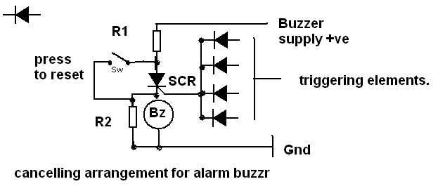

if you can have the buzzer wired using DC through an SCR and a resistor in parallel. it could be triggered by any subsystem by just giving a momentary plulse at its Gate.
the buzzer turns ON.The resistor in parallel to buzzer, is suggested because, if it is self interrupting DC bell type, the SCR won't support. By having a resistor in parallel, constant current can flow and the SCR is kept ON
Now comes the silencing the buzzer.
if you momentarily short the SCR gets switched off, and wont turn on by itself , unless triggered by another sub system. Of course , you need to take care of not fusing the supply line serving the buzzer. and SCR.

Sarma's SCR circuit is simple and should work, but it's good practice to add a resistor in the SCR gate circuit to limit the initial gate current.

Thanks Crutschow, You are right, OP could have a 100 Ohm resistor in series with gate before reaching the triggering elements perhaps.

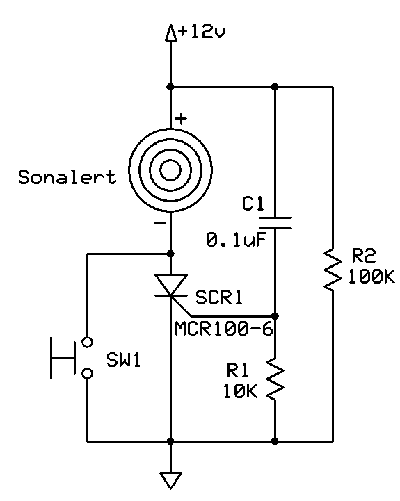

Love mvs sarma's circuit. If you add an RC circuit to the gate it will provide a power-up trigger. Using a Sonalert will allow you to eliminate the resistor across the "buzzer". The 100K is there to rapidly discharge the cap when the alarms ends.

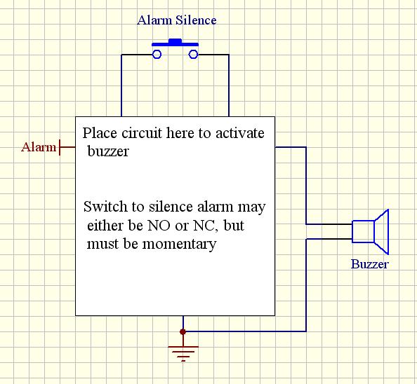

Here's a block diagram of what I have and what I need.
I have power from the alarm signal, which is available when in alarm and not available when it isn't, and I have ground. I need to develop a circuit that will silence the active alarm by a push button switch. When the alarm occurs the next time (goes off and then back on) the buzzer will sound again.

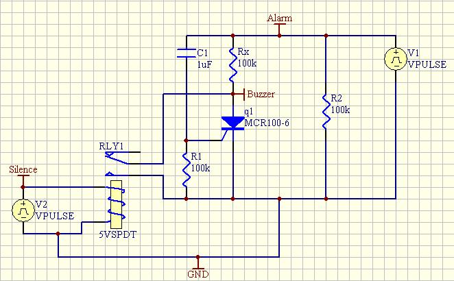

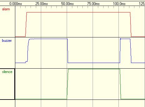

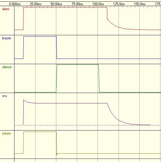

I was finally able to get my old sim software running, but I don't know if it's right. According to my simulation (in which I had to replace the buzzer with a resistor) the alarm silences itself (silence=buzzer) after the turn on delay and then refires each time the button is pressed (or in my case, when the relay fires). The buzzer needs to run until the button is pushed and not again until the next alarm.

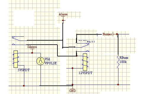

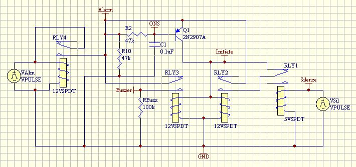

Getting the circuit software reinstalled from eons ago has been a most painful experience. But I think it's been worth it. The schematic attached got a little convoluted by all the relays I had to put in. Relay 1 and 4 are just switches. Relays 2 and 3 would be implemented as a single DPST relay (not two relays, notice the coils are wired in parallel). RBuzz is again a concession for not have a sim symbol.
Now I just need help with the values for R2, R10, and C1. I just need a time constant long enough to pull in relay2&3 to establish the NO contact on (what is shown as) relay2.
My other concern, is the voltage from C1 connected directly to Q1 base going to hurt Q1?
Now if I can swap out relays 2 and 3 for something solid state, that woud be cool too. But I'm not worried about a DPST will work.
Wow, so complicated.
Try this:
Buzzer on NC contact of relay, it sounds when the input comes. When switch is closed, relay pulls in and latches with its NO contact. Buzzer, on NC, loses power.
When signal (power) is removed, relay unlatches.
Yes. Much less complicated. Kind of a complementary solution where the buzzer is on while unlatched and latch to turn it off (which is the opposite of my thought process).
Thank you.
P.S. any ideas on swapping the relays out for something solid state?
What is the significance of using a Sonalert over a different type of buzzer
A Sonalert (brand name) is a solid state buzzer. The significants in my circuit, as some already said, is that an electromechanical "buzzer" open-circuits once every oscillation and would stop the SCR from conducting. That's why you would need a resistor across it, to maintain a conductive path. A solid state buzzer conducts continuously, so wouldn't need a parallel conductive path.
In your simulation of my circuit, the resistor simulating the Sonalert should be in the 500 to 1K range. 100K would not allow enough current to maintain conduction in the SCR. For an electromechanical buzzer it would be in the 100 to 500Ω range. And simulated by a relay with its coil powered through its C and NC contacts. Why did you pick 1.0uF for C1 and 100K for R1? R1/C1 are only to provide a brief pulse to turn on the SCR. The values in my schematic were "bench tested" and worked. Oh, and the alarm continues until you lift your finger off the reset switch.

There are hundreds of ways to do it with solid state circuits, but I don't think you will find one with a smaller parts-count/size than mine (actually, mvs samara's). Since your original post said "remote" you might want to add a resistor and LED across the alarm line to indicate that there still is an alarm, when the audible indicator is silenced.

I will redo the sonalert simulation with the values you suggest. The resistor substitution may be the reason why the circuit does not appear to be working correctly.
I like the LED idea. Thanks.
Ken
I resimulated the circuit with 1k for the buzzer instead of 100K. It works very nicely. Now to dig up an SCR.
I choose the 1uF and 100K values because with the 100K resistor substituted for the buzzer the circuit wasn't working. I didn't know that a) the circuit was bench tested, and b) the required resistance to substitute for the sonalert; which turns out was too high to make the circuit work. In short I butchered your bench testing because my sonalert-resistor substitution was too high in the simulation.
I'm old-school. I don't have simulation software, so I "usually" try to do the real thing. ;)
Ken
I don't have much of either. I was lucky that the simulation worked with less than a weeks arguing with it. There seems to be a reason why I stopped using it.
