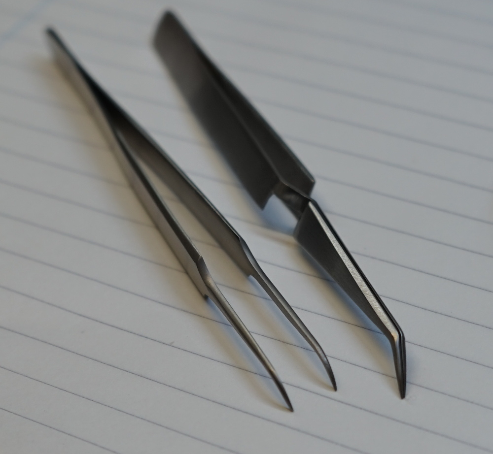

Earlier this afternoon I was soldering some SMD components onto a small circuit board, and thought that it would be appropriate to show how I try to avoid tiny components pinging off into the shagpile.
Two kinds of tweezers:
A conventional pair which have to be manually squeezed to hold the component,
and a pair which are spring loaded to the closed position...
Shown here holding an 0603 size resistor.
The gripping action of the tweezers leaves the hand and brain free to concentrate on the positioning and soldering of the component.

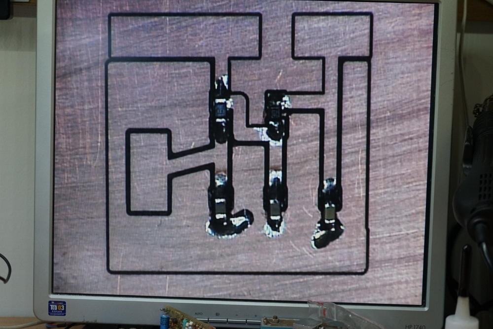

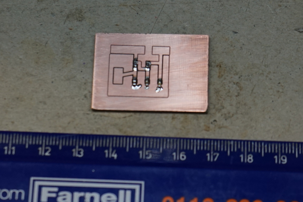

Like this:
As a close up view:
But what is it? they all cried...
It is a simple filter network for a phase locked loop that I am experimenting with.

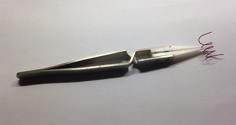

Very Good Advice Jim
Looks somewhat like the pair I was using ?
