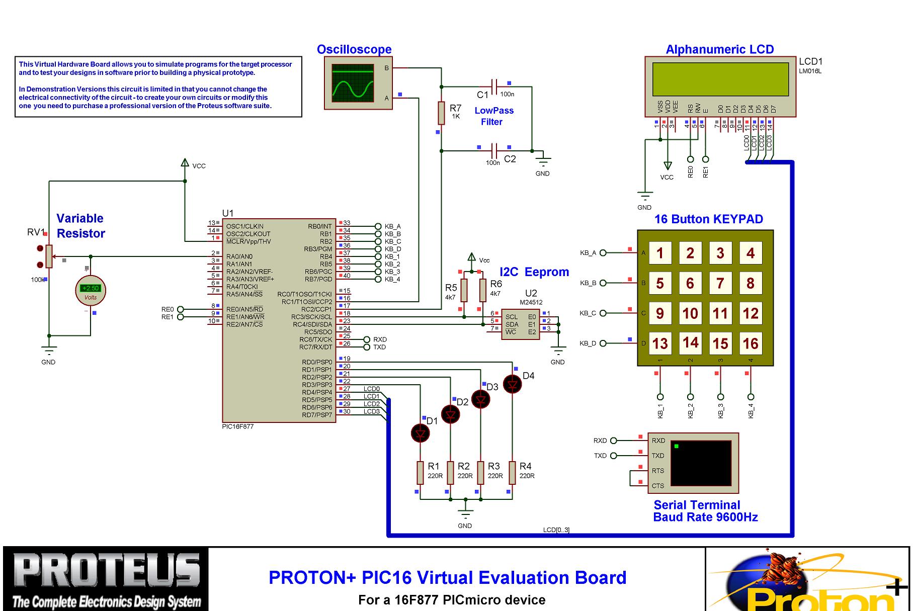

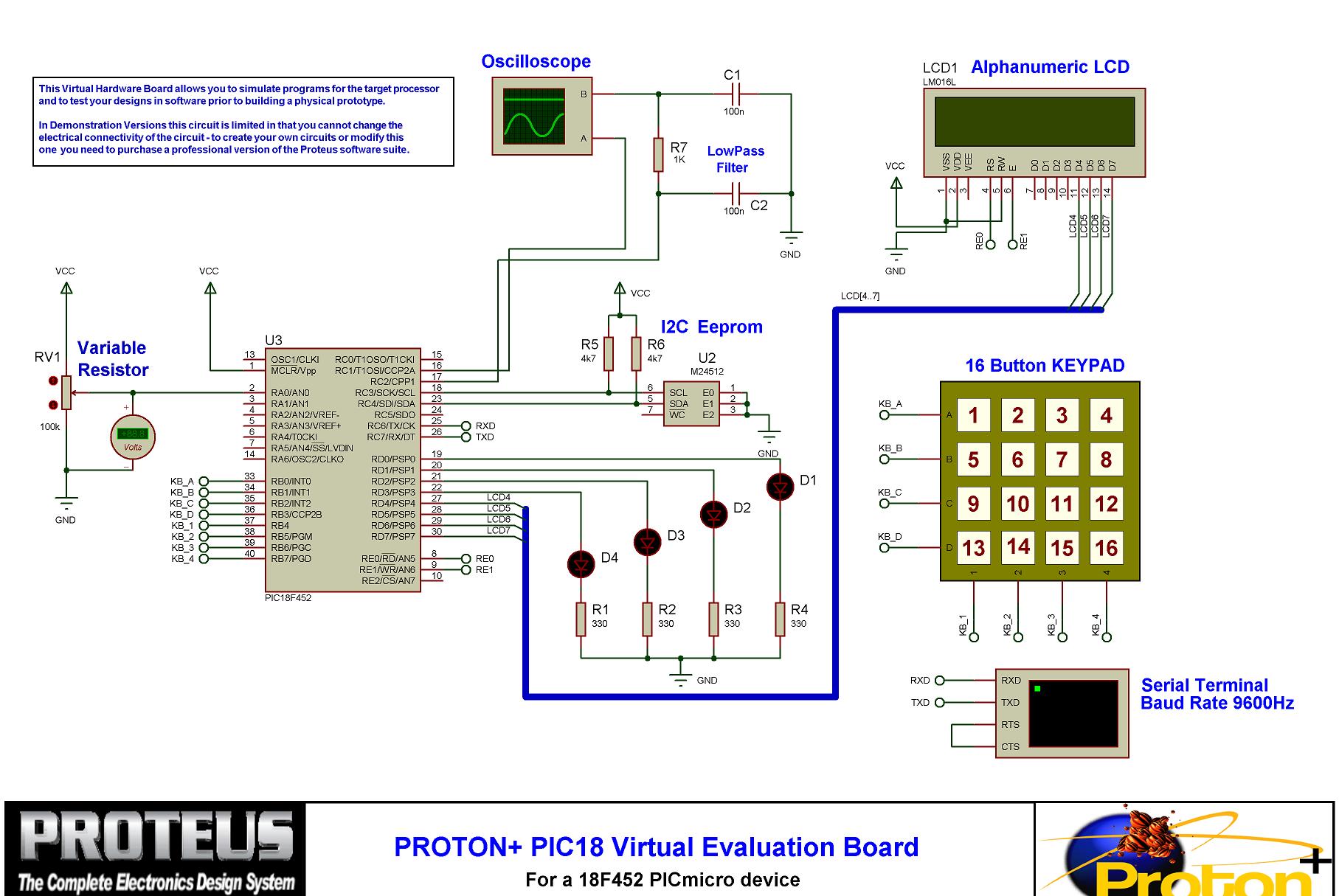

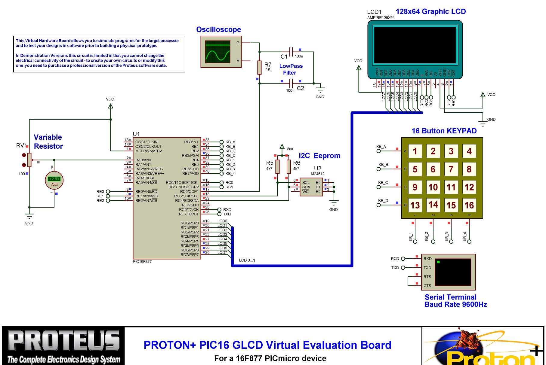

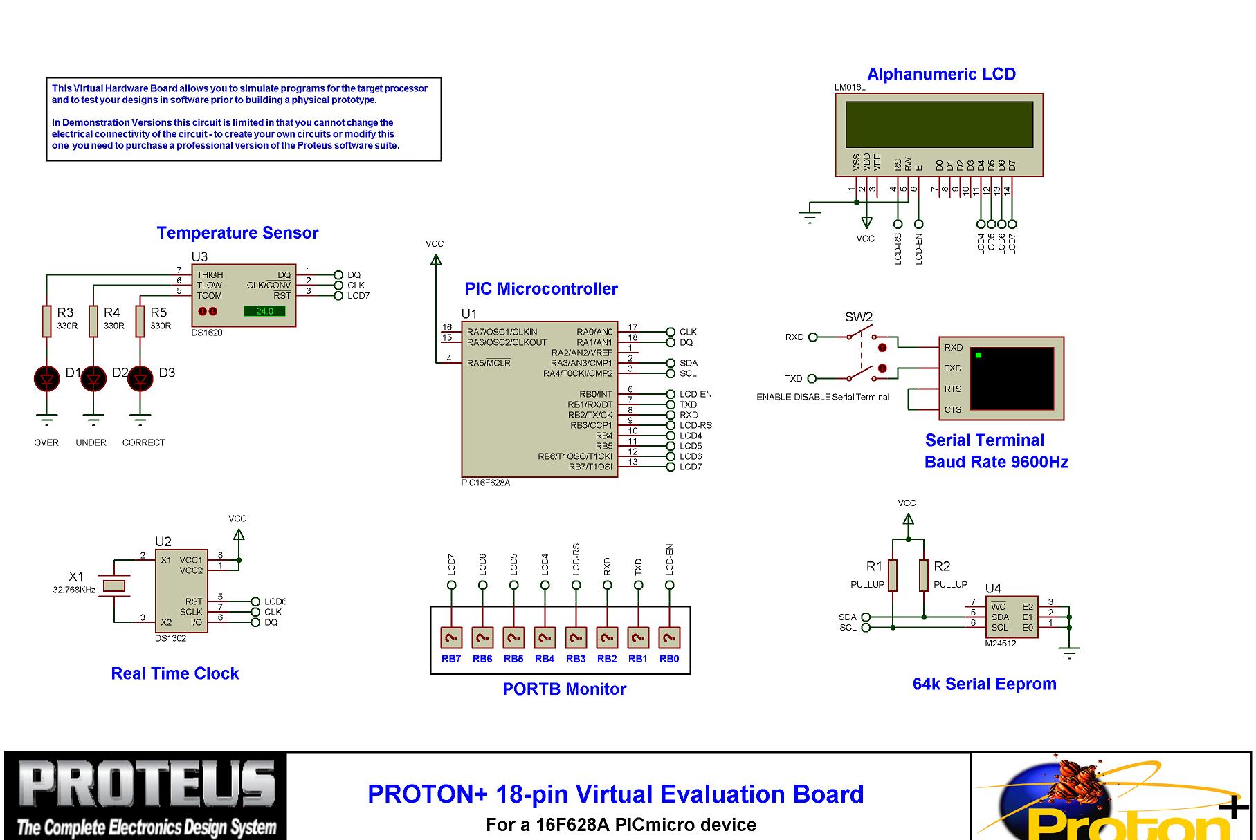

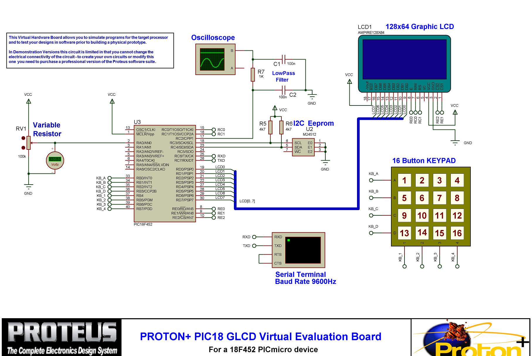

Yeah, this thread really went left wing :eek:
I exported a couple of piccys of the pre-made circuits.
You can load your program onto the PIC and simulate in near real time with unbelievable precision. The amount of time I spend developing with a VSM is now around 90% compared to real life simulating. It takes wiring out of the question, and allows instantaneous additions/edits to either the program or the circuit with simple clicks from the mouse.
The debugging/circuit design features are second to none. Whether it be real time PIC(any device) hardware information, or UART/SPI/I2C/1-Wire serial debugging tools, oscilloscopes, voltmeters, ammeters, signal generators(very large range), thousands of analogue/digital devices, it really is second to none.
Using a VSM will cut your debugging time by unbelievable amounts

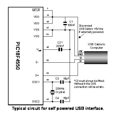

A USB example from the Proton PDS help File
 REPEAT                                       ' Wait for USB input
 USBIN 3, IN_BUFFER, AUTO                     ' Poll the USB and Receive some data from endpoint 3
 UNTIL STATUS.0 = 0                           ' Keep looking until data is able to be received
 REPEAT : UNTIL TRNIF = 1                     ' Wait for completion
And the circuit diagram also found in the help file;

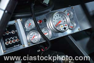

No pots just switches. I run alot of sims mostly cars. I want to create a ignition setup along with some other toggle switches such as lights and starter switch. If you look at the pic, I am going for something like that.
