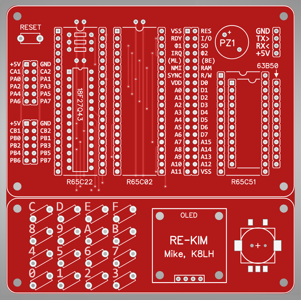

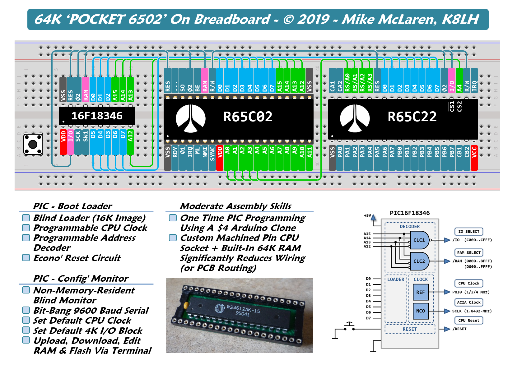

I'm interested in a couple of the 18F27Q43 peripherals which help reduce the size and cost of my 'retro' CPU projects;
(1) previous chips with CLC (Configurable Logic Cell) peripherals only had four cells and you could only assign four pins as inputs. this chip has eight cells and allows assigning up to eight pins as inputs. The CLC logic is incredibly useful for 'glue' logic on my various 'retro' CPU projects (see example below)...
(2) this is the first chip to sport three NCO (Numerically Controlled Oscillator) peripherals which I can use to generate precise variable clock signals on my 'retro' CPU projects (a variable CPU clock, a variable ACIA clock, and a variable clock for an I2C chip)...
