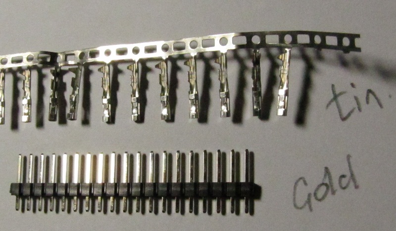

Gold .. Anybody know what the 'gold' metal used on connectors is, okay some board pads and expensive audio may be gold, but PCB connector pin headers, I assume something else.…Rhodium ? To make a short story long .. Having chased many 'stupid' faults during my service engineer career I came across a couple that were due to that connector plating … ( this is one such ) back in the 1980's A savings bank had a batch of new (386) PC's for their front counters , the user requested a longer vga cable for a small 10” colour monitor. 'Sales' had some made and fitted ( an internal 10 pin connector) .. after a few months at one or two sites the customer complained monitor had reverted to monochrome ! Engineer swaps out monitor … Oh new monitor cable too short... so swaps old cable back... good repair all working again ...! No a month or so later monitor is mono again.. also customer is having same problem at more sites (sometimes a pink display )..after several monitor swaps .. customer was a 'bit' annoyed.. I was tasked to find cause.. as rework could not get a PC / Monitor setup to show the fault. Okay. The new long cable had cheap 'tin' tags attached to the monitors 'gold' pins . And with time and some sweaty hands of an bench engineer the two metals reacted and caused some nasty black coating...the new PC's had a new type of Cirrus vga chip that could tell if it was connected to a colour or mono monitor and the correct driver then installed . The higher resistance caused by the connector contamination , caused it to select the wrong one.. I have not learned …. I regularly use 'tin' tags on 'gold' pins .

Gold can be plated in extremely thin layers and still achieve corrosion resistance of the underlying copper (this means that even some inexpensive connector pins can be plated in gold at 0.5um). Thin is good enough for connectors that are connected/disconnected only a few times in their lifetime.
You would think thicker gold plating would be a good thing - more is better. In general, more is better, unless it is not.
In the unusual case where gold is crunched onto a tin surface, you can get intermetallic migration that forms a gold/tin alloy at the surface (Au(Sn)4). It is brittle and dark - one type of purple plague. To avoid, make sure thick gold plated pins are not mated to dull tin finish. There is not generally enough gold to cause a brittle gold/tin alloy cleavage issue when thin gold plated pins are used.
Cheers.
In my 'tale' I don't think there was any solder / flux involved , just a 'gold' female connector replaced by a 'tin' version . ( Bench engineer in gloves :D ) Still not sure if this M/F pairing is okay ?
Sorry I was unclear but I did not mean soldered when I said crunched. I meant forceful physical contact causes slow, intermetallic migration - weeks to months time scale.
Those terminals shown marked as 'tin' look very similar to the ones we made at Delphi Packard Electric, for use in car wiring. And some of them had gold plating on them. But they were only plated where they made conact with the mating terminal. The plating was actually done before all of the stamping and forming of the terminals. Never got to see how the plating was done on just small parts of a strip of metal that was much wider. The process was done in a locked room with restricted access do to the gold.
