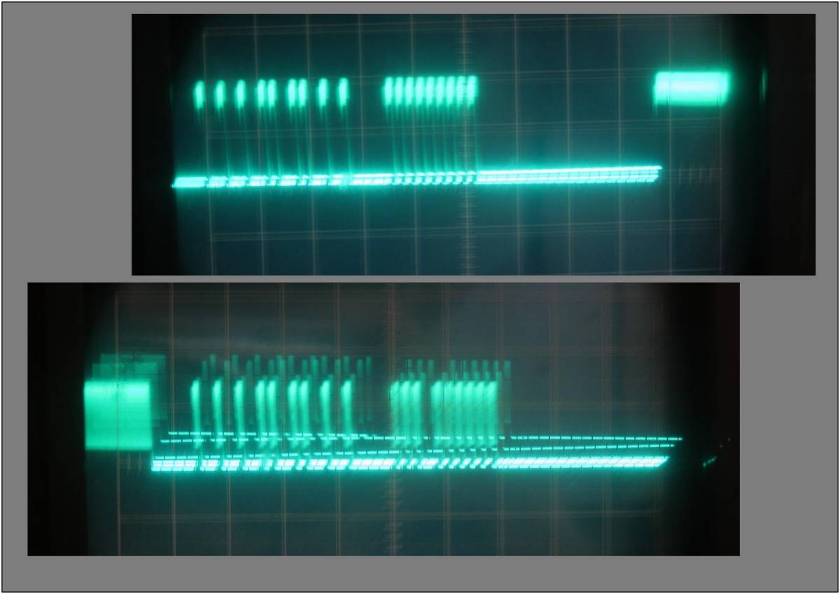

Back on topic - I wonder what the OPs Air Conditioner IR Remote Carrier frequency is?

Does not look like any protocol I have ever seen.
Unless somebody else can spot a known protocol, then I guess you will have to write your own code to handle it.

No problem with the IR 3 pin receive module, i am using a pin photo diode...real fast and picks up the carrier too, which BTW looks like 40kHz for this unit. The delay with this kind of diode is on the order of 5 nanoseconds.
I was going to try the universal remote, which does do 56kHz BTW, but i did not have a manufacturers code for the AC unit. The data sheet only shows TV's and other enetertainment devices like DVR's etc.

Here are some lousy scope pictures, but they show the actual measurements. The camera was hard to hold still.
You can see the pin photo diode picks up the carrier too, but with this time scale shows up as a blur.
The two traces show pulses picked up for two different buttons pushed.

I got a TSOP13xx type IR receiver, 40kHz this time, and it reads the remotes really nicely. I can get fairly clean signals now without any filtering. It seems to work on the 38kHz remote too, and i will be checking others as well.

The codes for the AC are definitely not like any of the other remotes, but then the other remotes all have their own technique anyway. I dont have one remote that has the same format as any other no matter what devices they came from.
yaya, the tsop i have inverts the signal, so I may get this backwards but it seems to me that the main thing to look at is the on times and off times for the start pulses and the data logic 1 pulses and logic 0 pulses as well as maybe the pulse off time between the bits....
if the timing for those match up , then it would be no problem getting a universal remote to do any device....providing that we can upload a whole code map on universal remote , this is not to be confused with the 3-4 digit code you normally type in the remote to call code map
